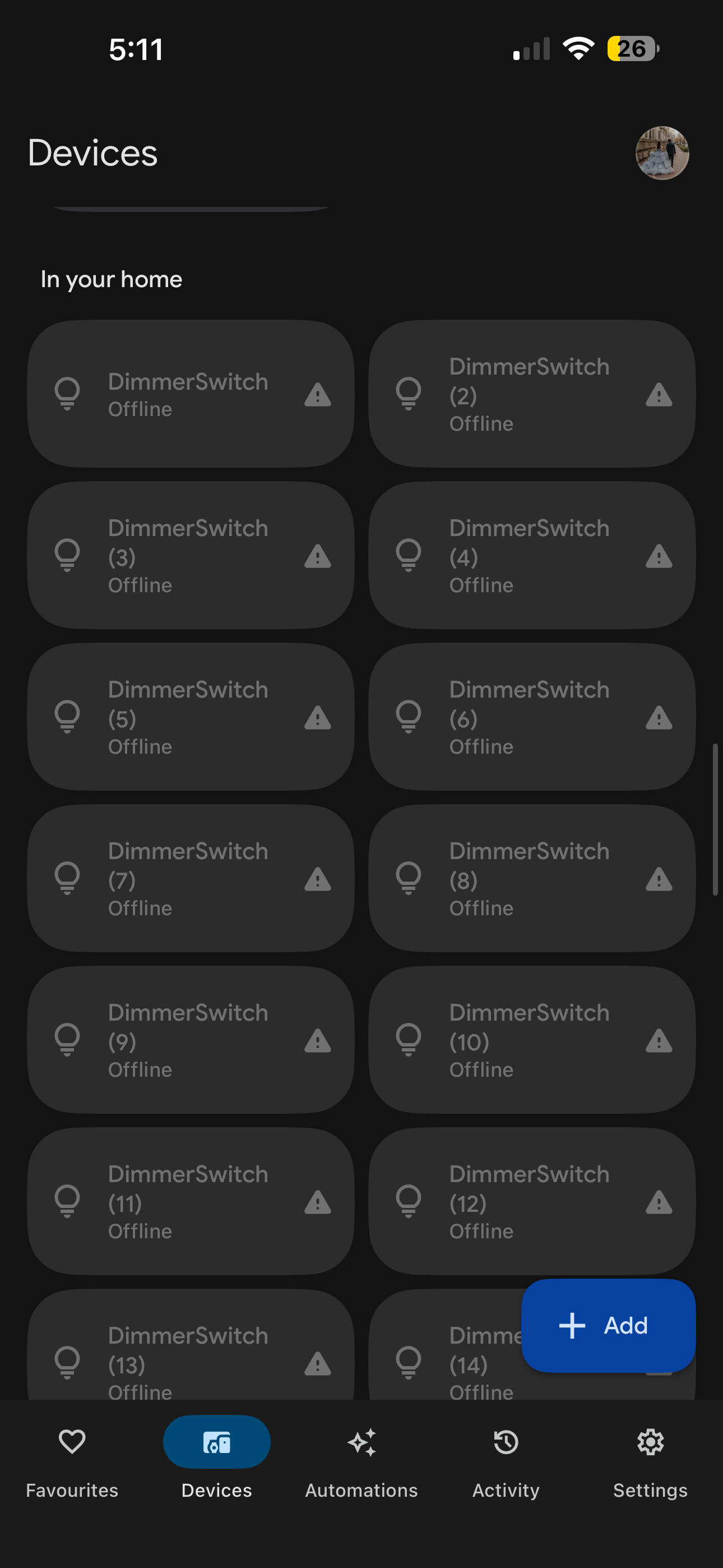

Just to clarify:
  • My Google home has all the devices connected via Tuya cloud account. I am still able to control my devices in Google cloud.
But if I were to connect directly Google home <> matter hub itself all the devices shows offline
I upload some screenshots for more clarity

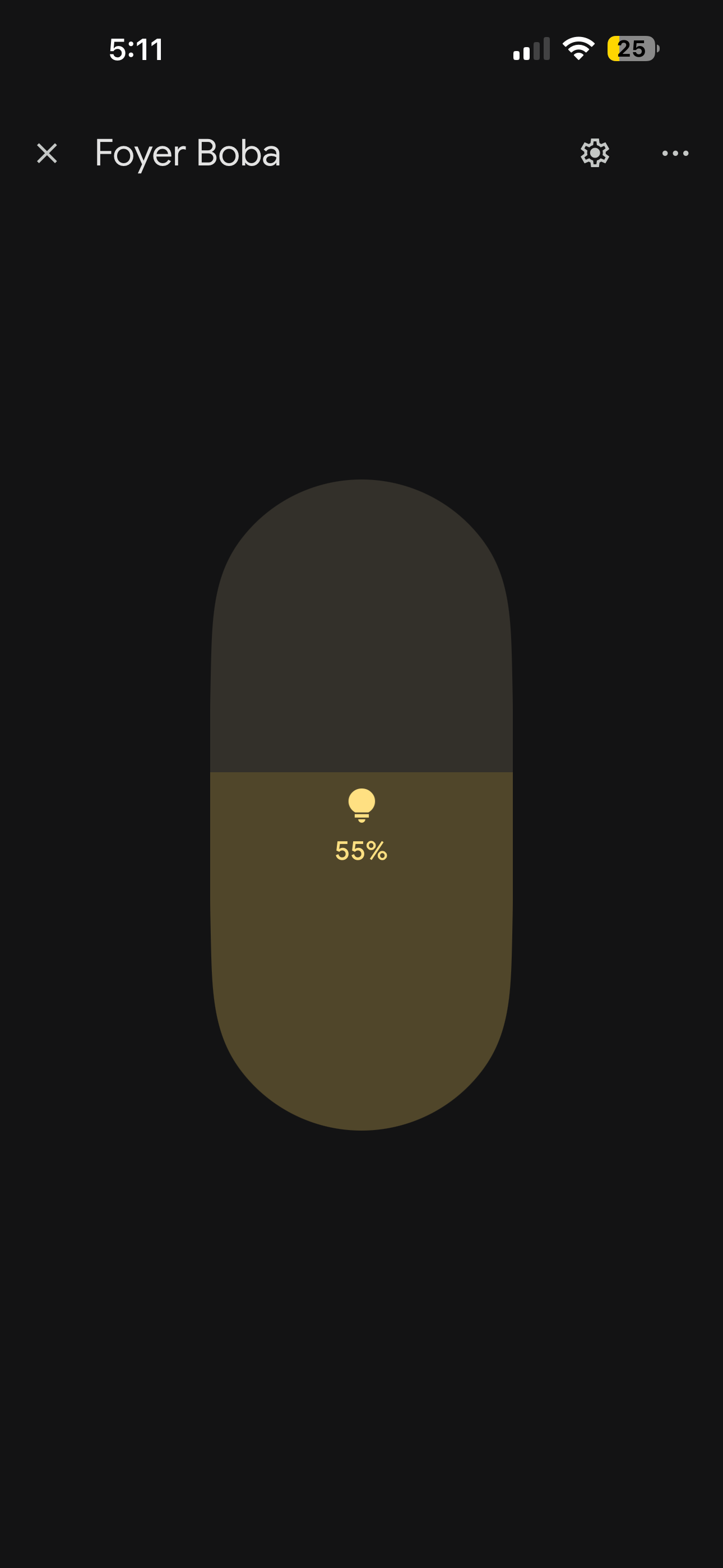

Google home connected to Tuya Account aka Tuya Cloud. Works
Google home - direct connect to Matter hub all offline

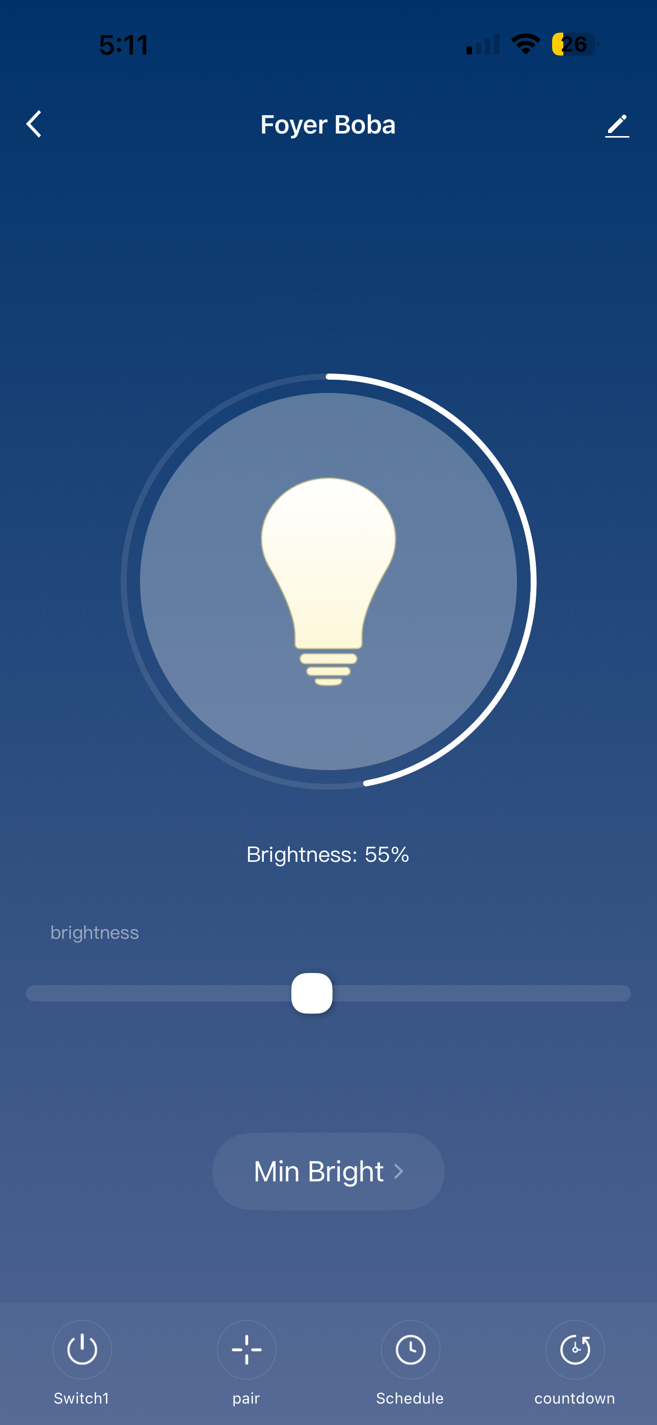

Tuya app - able to control
