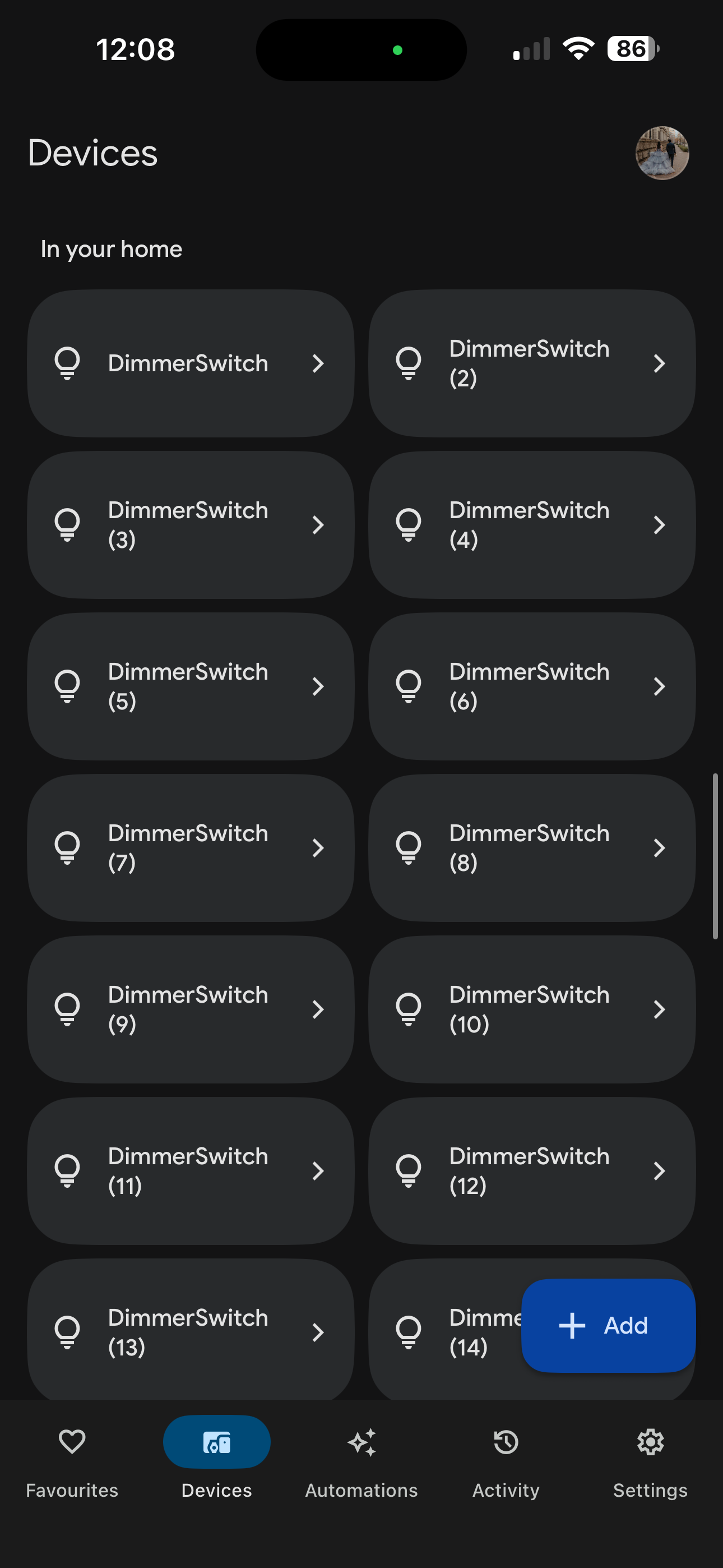

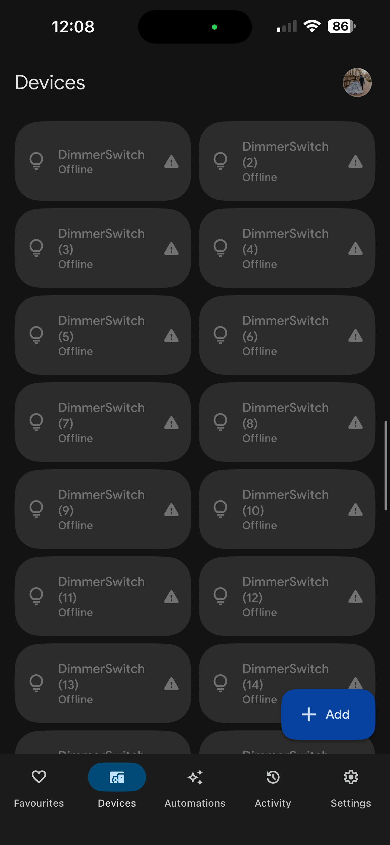

Before the electricity gets cut off due to maintenance work of my building, I have just re-pair back to Google home. As you see from the screenshot. Once I re-pair successfully. Everything was online. But when I go into each individual switch to try to on/off nothing happens, then I proceeded to refresh my Google home and everything went offline.
Last night, I have tried via Apple home, for a very brief moment I was able to control the lights then it went offline

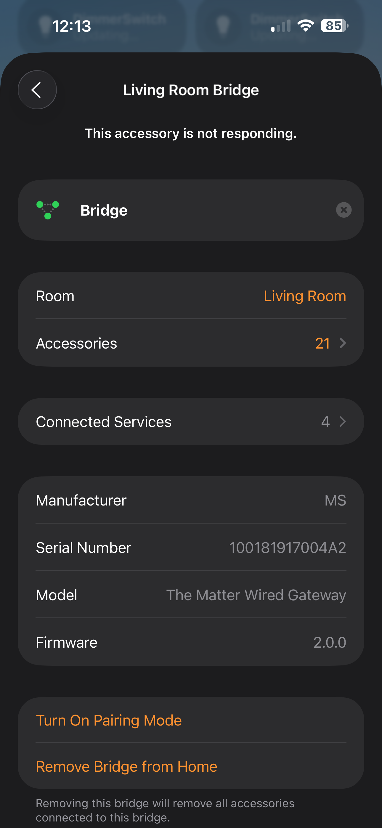

as I connected to both Google home and Apple home, there was a message stating that the bridge is not responding - attached the screenshot

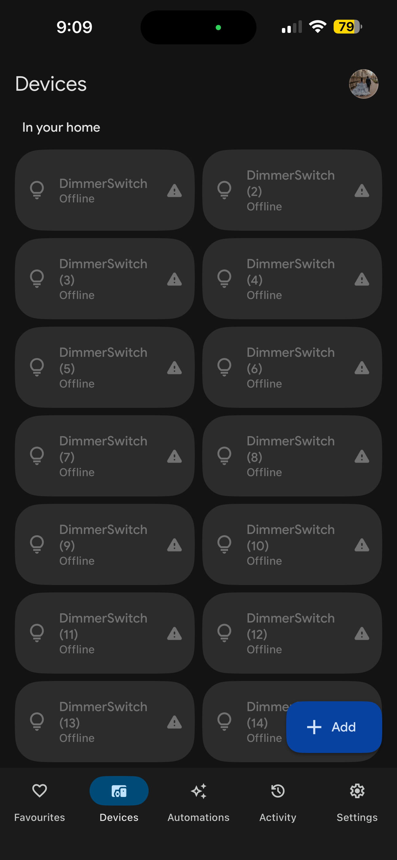

Re-paired to google home at 25th Sept 2025 (2.51pm) - Singapore Time (All device status were online in google home at this exact timing, but when i try to on/off nothing happens)
proceed to refresh my google home at 25th Sept 2025 (2.52pm) - Singapore Time (All device status went offline in google home)

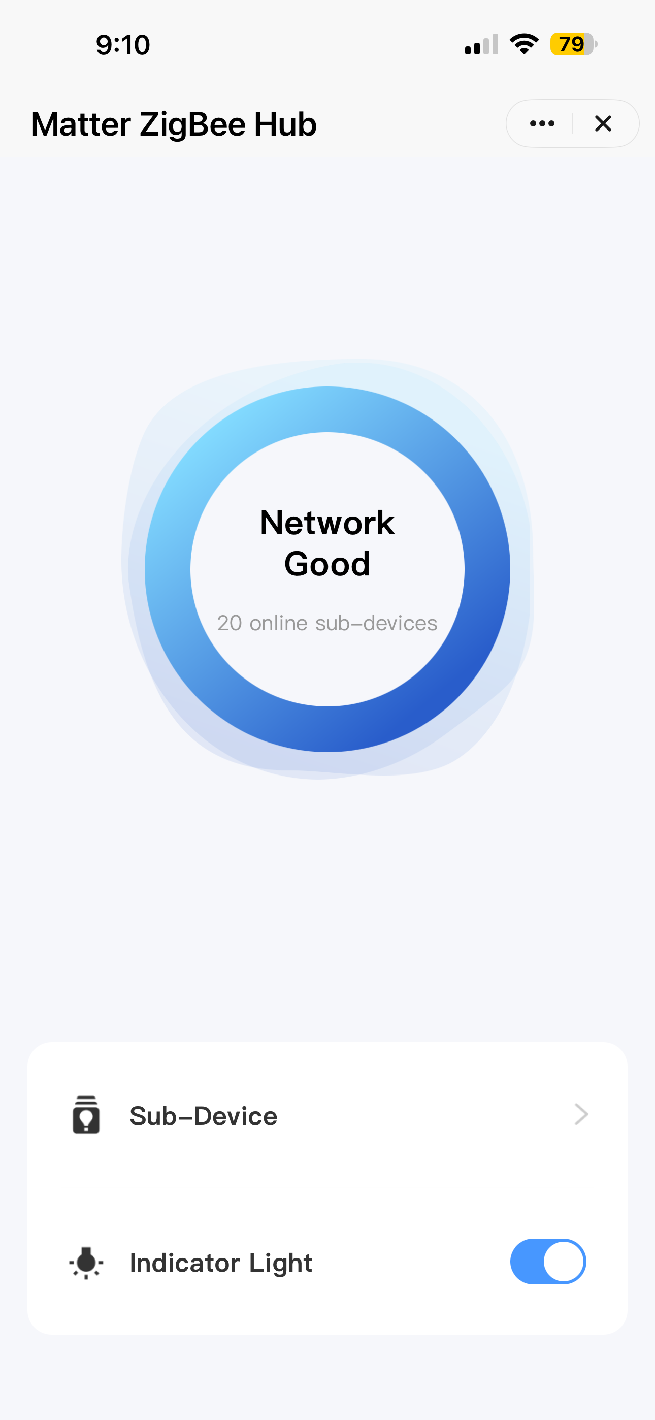

Through out all these timing in Tuya App it is working fine (on/off/dimming/status).
