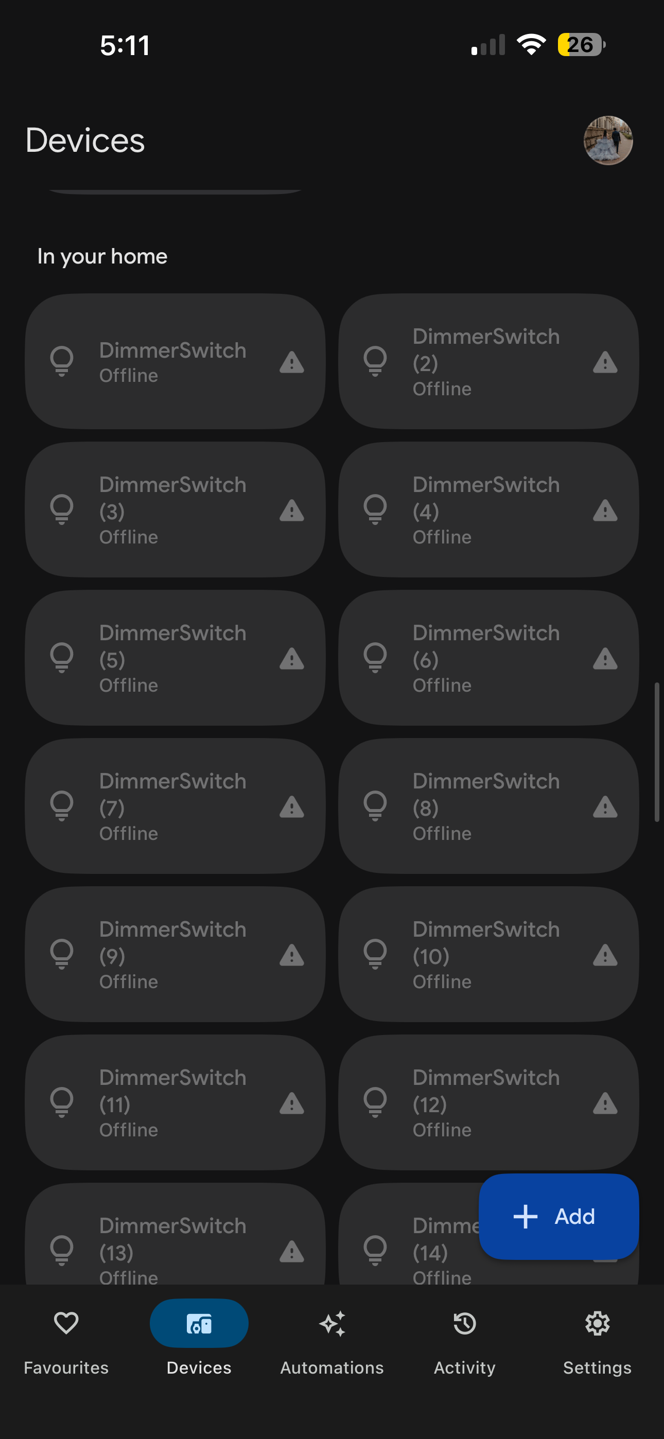

  1. I cannot control any via google home if I direct connect to the matter hub, Only Tuya app is working. But connecting via Tuya account in Google home works.
  2. No, there is no response in Google home. It just shows offline. Be it I on/off via Tuya app.
Just to clarify:
  • My Google home has all the devices connected via Tuya cloud account. I am still able to control my devices in Google cloud.
But if I were to connect directly Google home <> matter hub itself all the devices shows offline

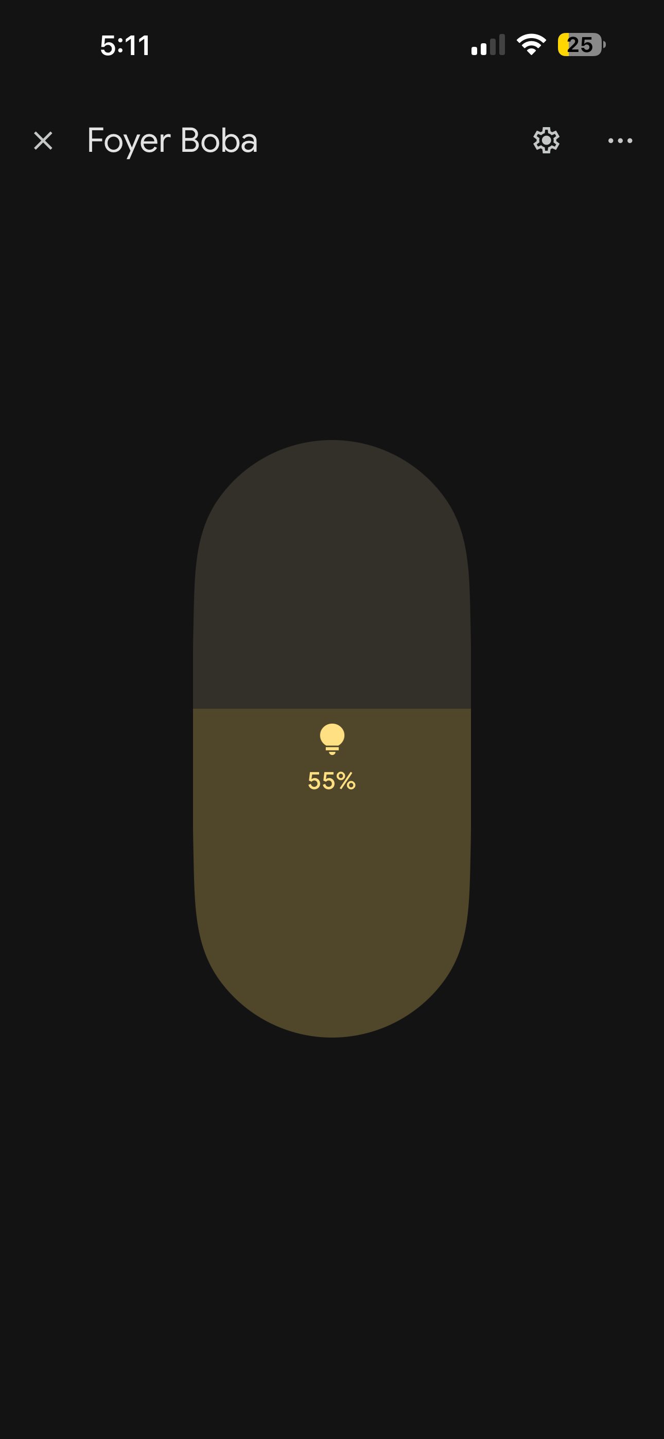

Google home connected to Tuya Account aka Tuya Cloud. Works
Google home - direct connect to Matter hub all offline

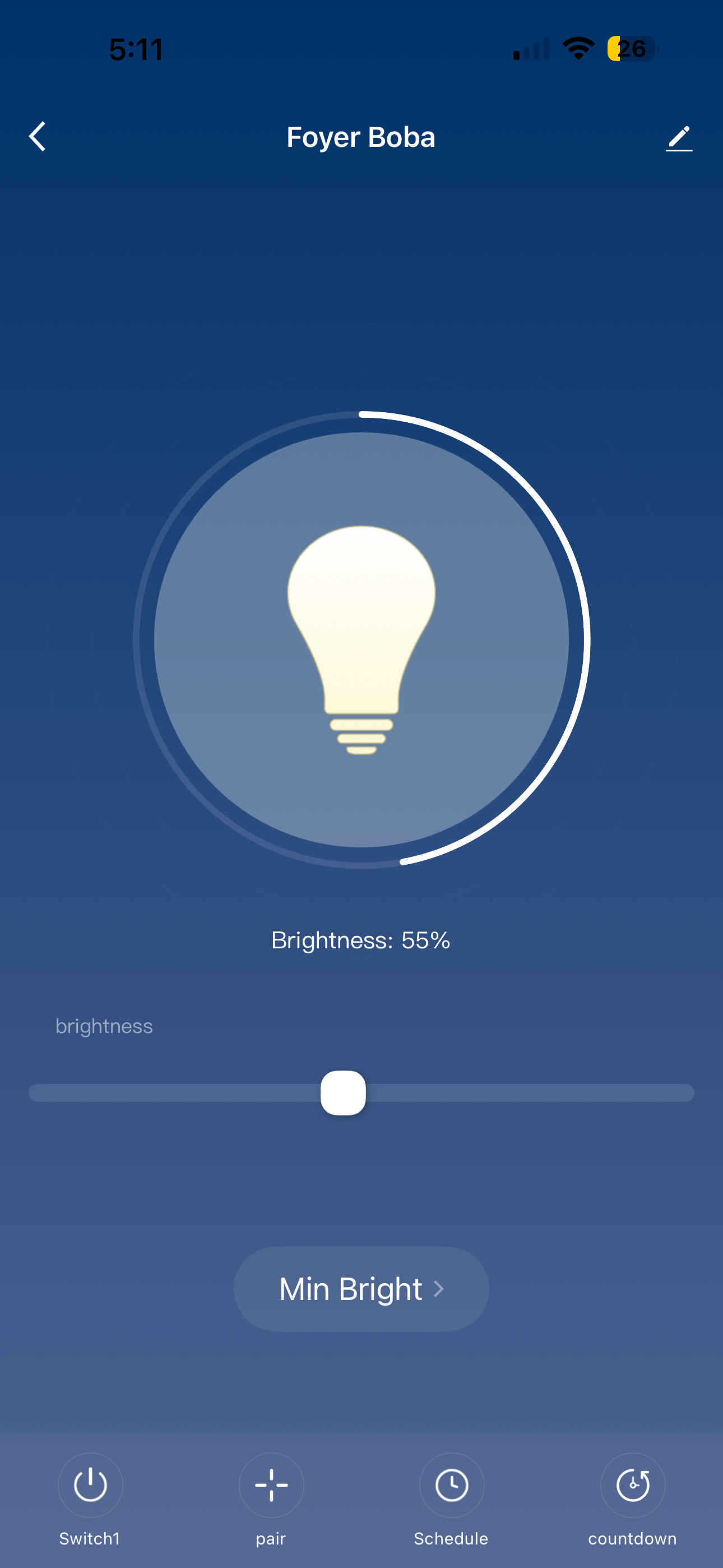

Tuya app - able to control
