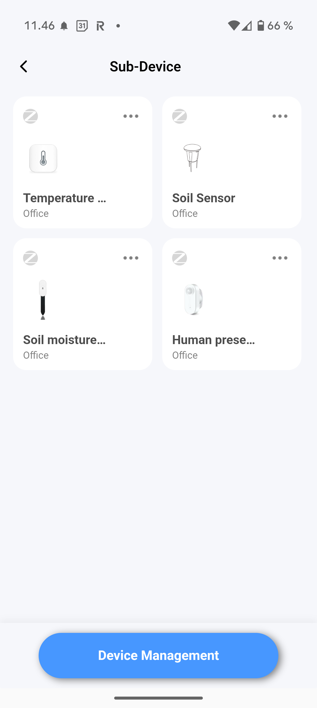

I was directed to this forum from the smartthings community, as I'm having some issues after integrating Moes Matter hub into my Smartthings setup. I hope you can help me get this issue fixed or point me in the right direction what I can do to make it work.
The situation:
I’m having a 2018 Smartthings Hub firmware version 000.057.00014 and a Moes Matter Zigbee MZHUB Main module v1.12.6, Other type v.3.7.2.
Smarthings and Moes hubs are connected via Matter and I have 4 Tuya Zigbee devices connected to the Moes hub.
1 Temp and humidity sensor
1 Human presence sensor
2 soil sensors.
The issue is that I can’t get the devices to be presented in a useful way in Smarrthings. After the matter integration, the devices are listed a “Matter switch” or “Matter Device” with no updates. I have tried to remove and repair, reboot the hubs after each step and removing and adding 1by1 but no success to get any update.
The only thing I managed to get working is to manually change the type to “Matter Thing” and the presence sensor is now updating, but very very limited companied to the information in the Moes app. The other devices had 1 update (when changed to “Matter Thing”) and no update since.

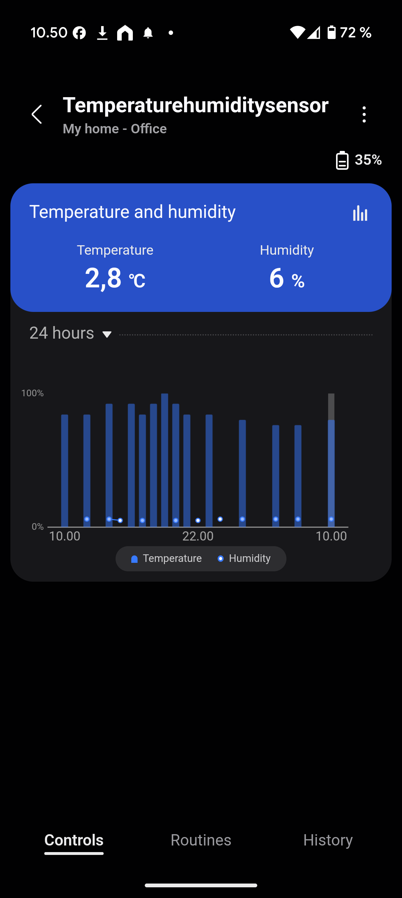

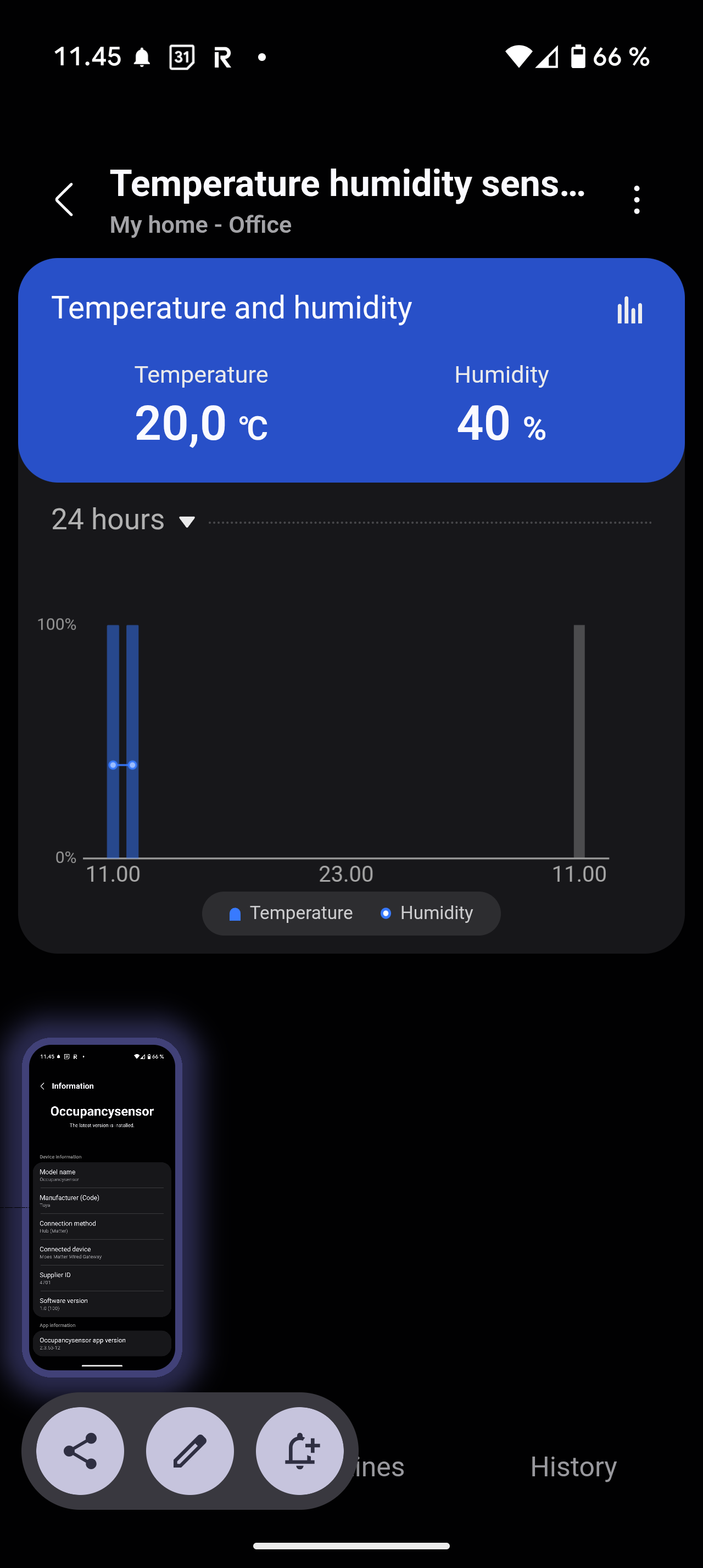

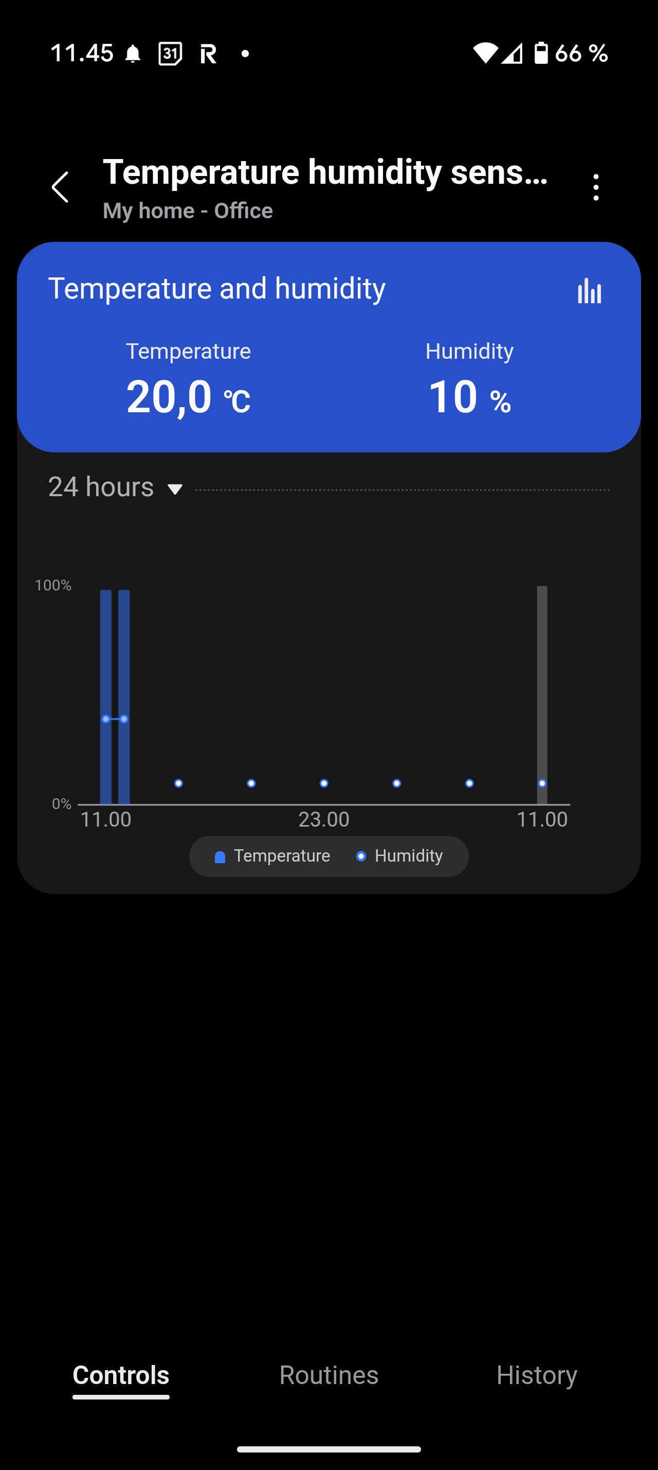

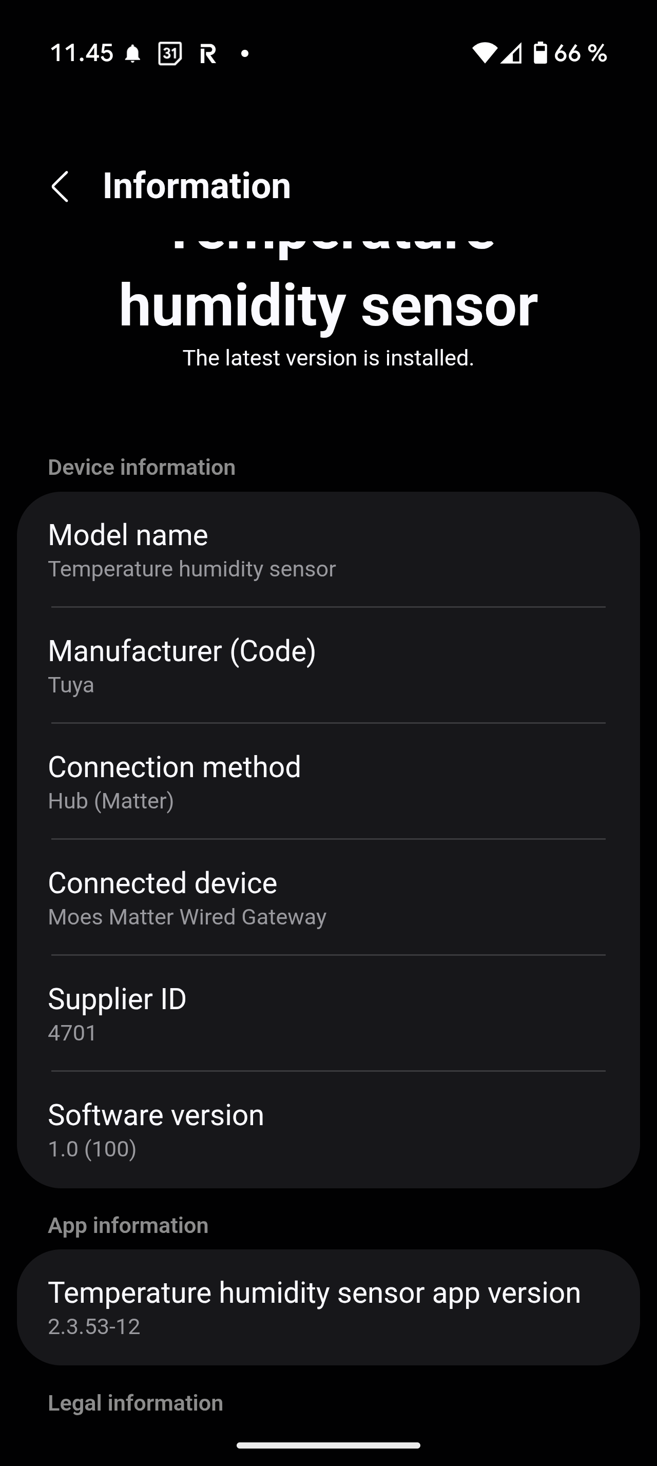

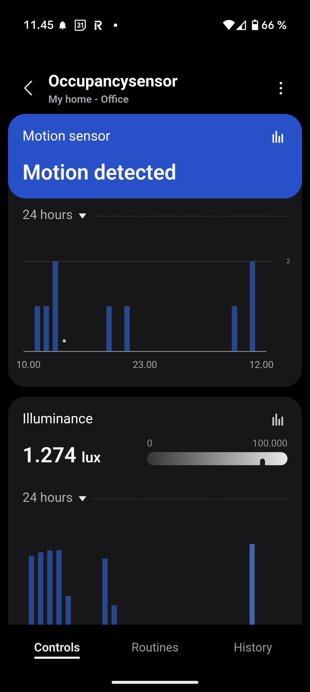

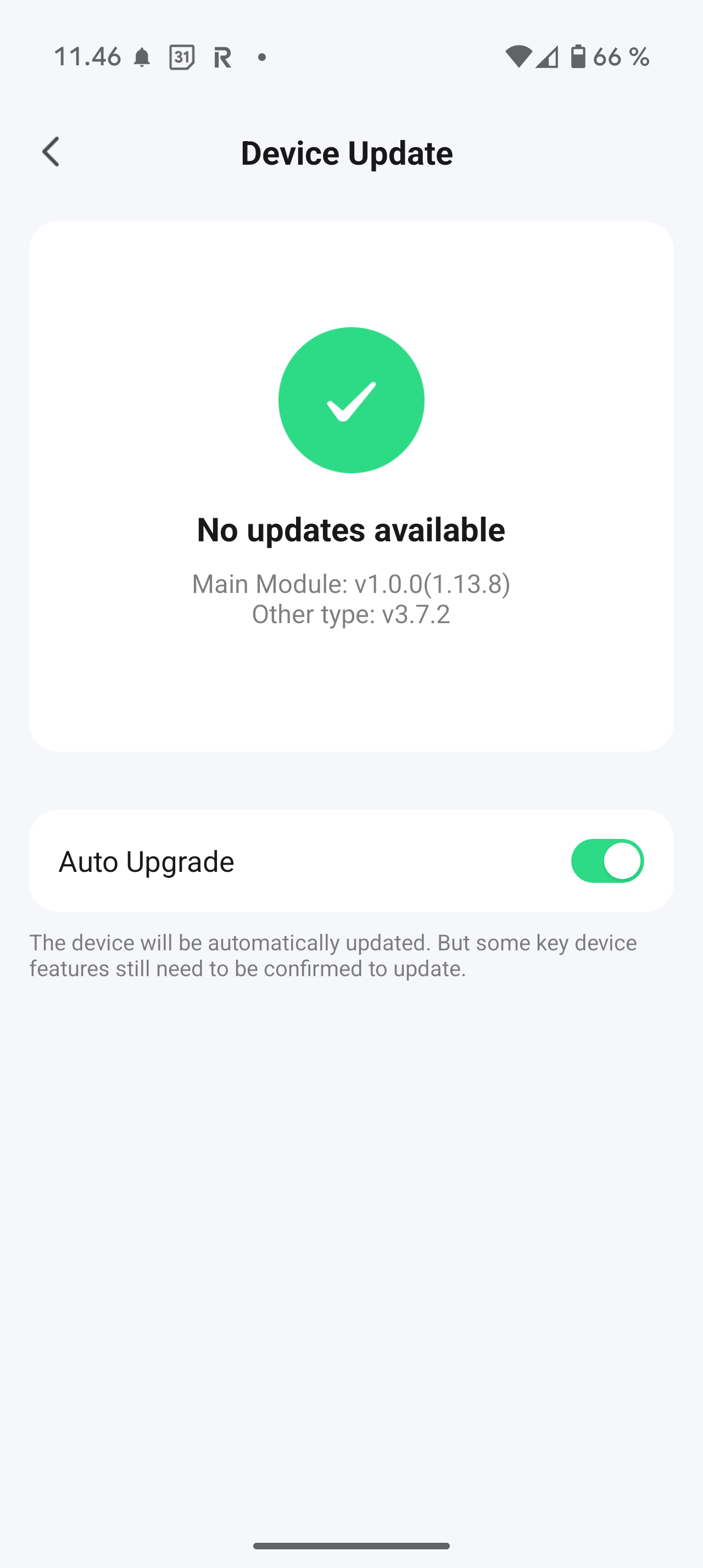

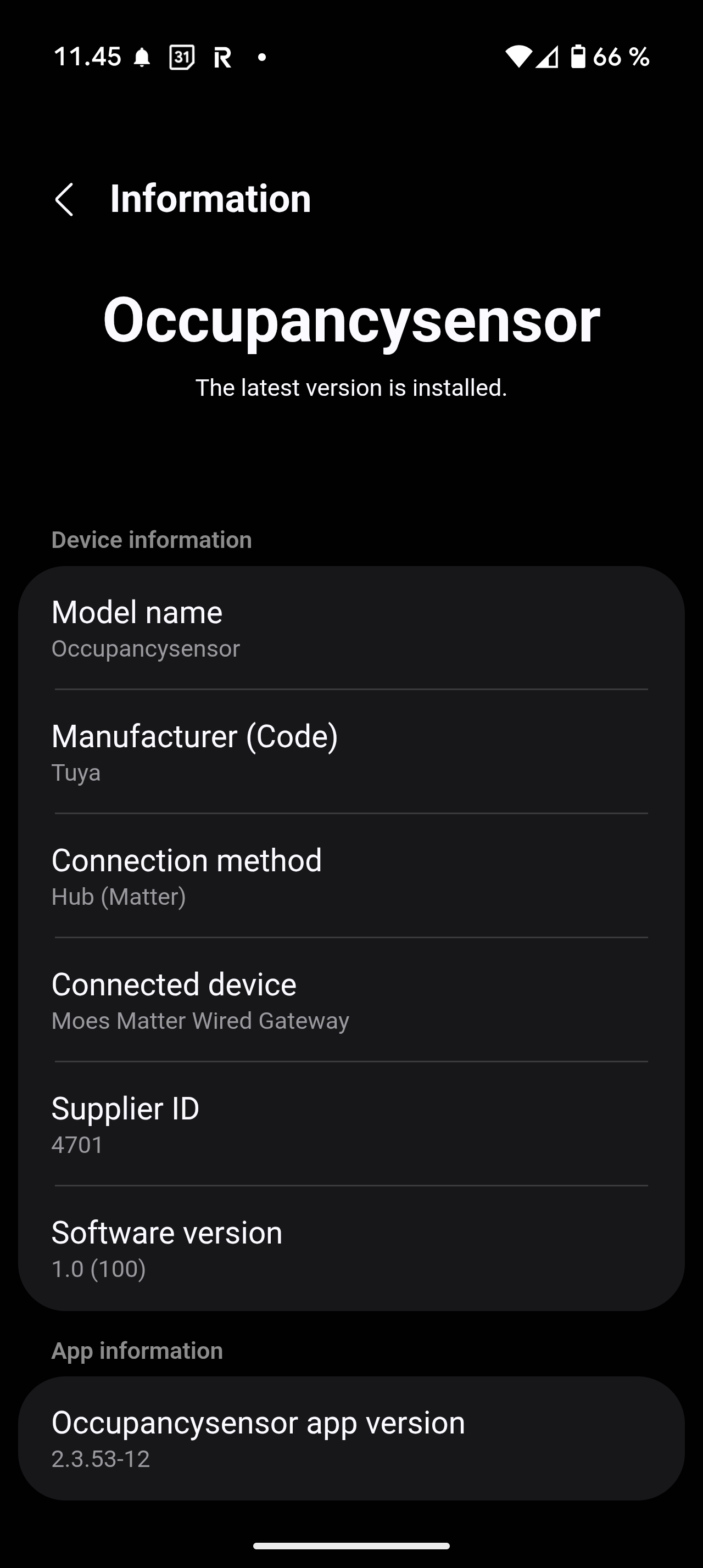

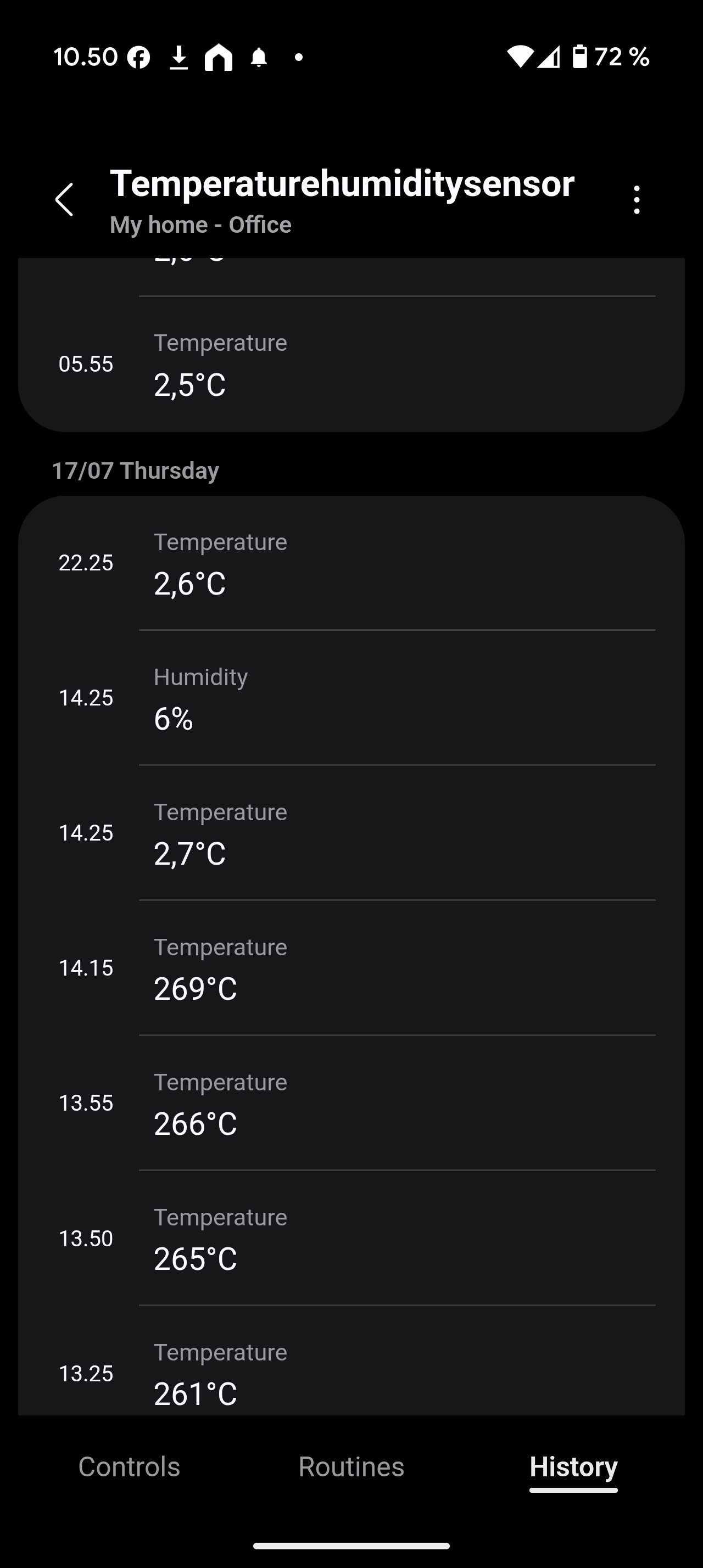

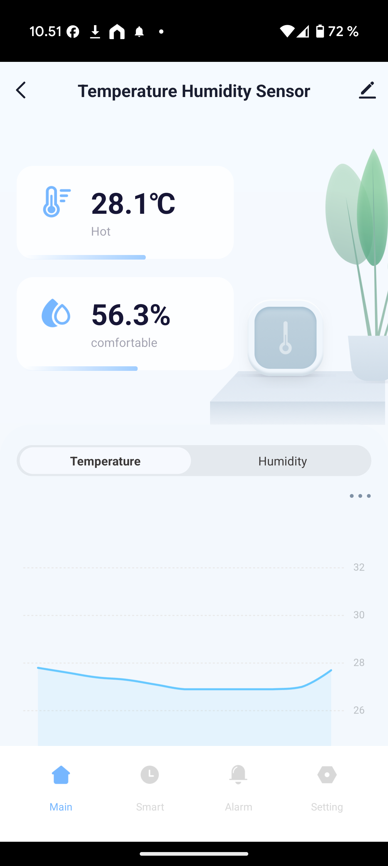

Thank you thank you thank you. The hub is now updated to 1.13.8 and there is a improvement with one of the sensors. After the update, I have removed all devices and the Matter connection between Moes Hub and Smartthings and reconnected it again. Both Hub's are also rebooted.
Feedback: I have 4 sensors, 1 is now working as expected (the Occupancysensor), 2 are just added as temperature humidity and not updating any value, and 1 is not visible to Smartthings at all.
Please see attachments with screenshot of versions and let me know any action I need to perform.
