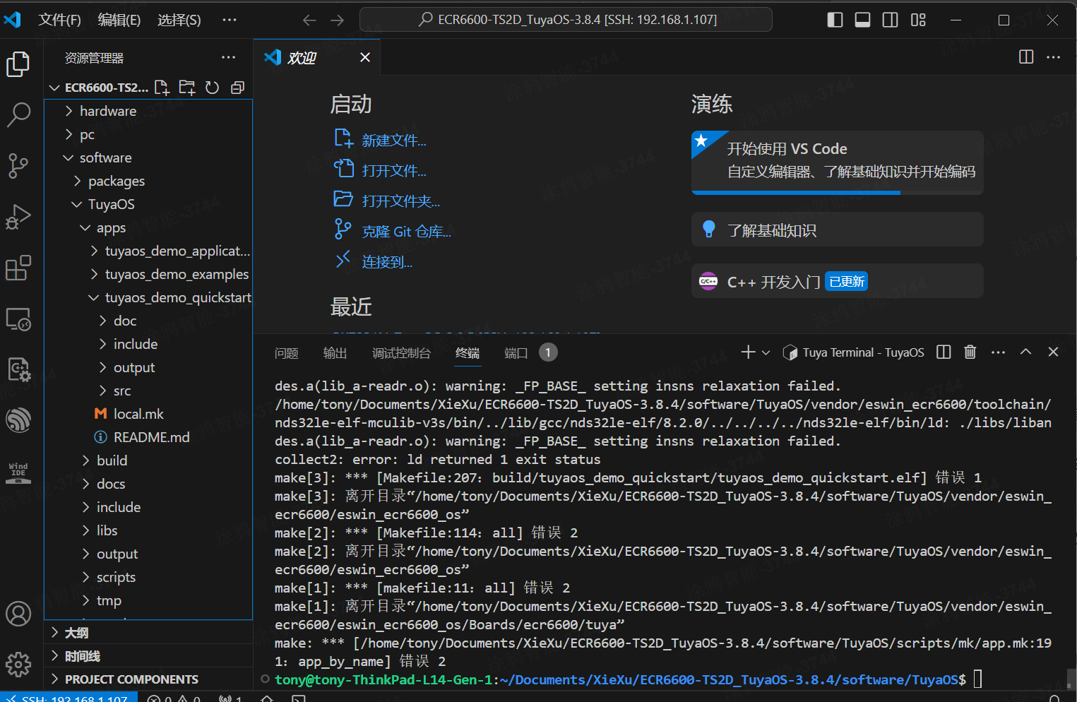

ECR6600-TS2D-TUYAOS-3.8.4版本,默认SDK编译失败
编译失败LOG:

collect2: error: ld returned 1 exit status
make[3]: *** [Makefile:207:build/tuyaos_demo_quickstart/tuyaos_demo_quickstart.elf] 错误 1
make[3]: 离开目录“/home/tony/Documents/XieXu/ECR6600-TS2D_TuyaOS-3.8.4/software/TuyaOS/vendor/eswin_ecr6600/eswin_ecr6600_os”
make[2]: *** [Makefile:114:all] 错误 2
make[2]: 离开目录“/home/tony/Documents/XieXu/ECR6600-TS2D_TuyaOS-3.8.4/software/TuyaOS/vendor/eswin_ecr6600/eswin_ecr6600_os”
make[1]: *** [makefile:11:all] 错误 2
make[1]: 离开目录“/home/tony/Documents/XieXu/ECR6600-TS2D_TuyaOS-3.8.4/software/TuyaOS/vendor/eswin_ecr6600/eswin_ecr6600_os/Boards/ecr6600/tuya”
make: *** [/home/tony/Documents/XieXu/ECR6600-TS2D_TuyaOS-3.8.4/software/TuyaOS/scripts/mk/app.mk:191:app_by_name] 错误 2

tuyaos_demo_quickstart/src/libqrencode/split.c:45 strdup 重复定义,先把这个去掉试试。

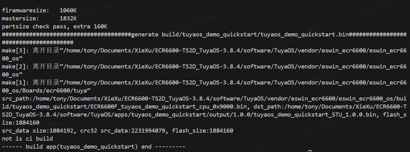

shelvin
Posts: 4
Re: ECR6600-TS2D-TUYAOS-3.8.4版本,默认SDK编译失败
第42行:
修改前编译失败的定义如下:
#if !HAVE_STRDUP
#undef strdup
char *strdup(const char *s)
size_t len = strlen(s) + 1;
void *newstring = malloc(len);
if(newstring == NULL) return NULL;
return (char *)memcpy(newstring, s, len);
#endif
改成下面的代码,编译成功
#if HAVE_STRDUP
#undef strdup
#endif
