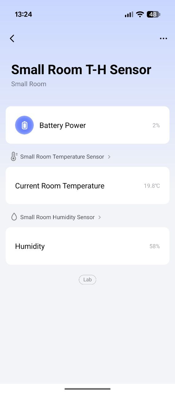

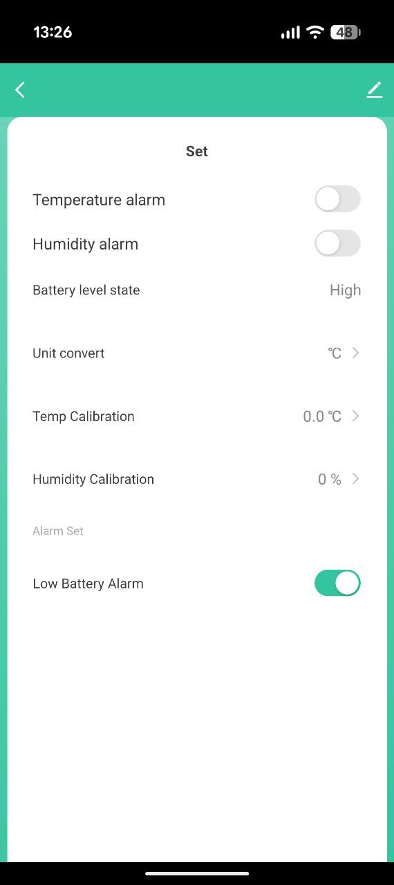

It's keeping reporting battery status as 2%, I think its beacuse in tuya app, battery level status is high, normal, and low. So I think it's better just turn off battery status in Matter, or make that high is reported as 100%, normal as 50%, and low maybe as 10%.
Battery Status In Aqara App:
Battery Status In Tuya App:
