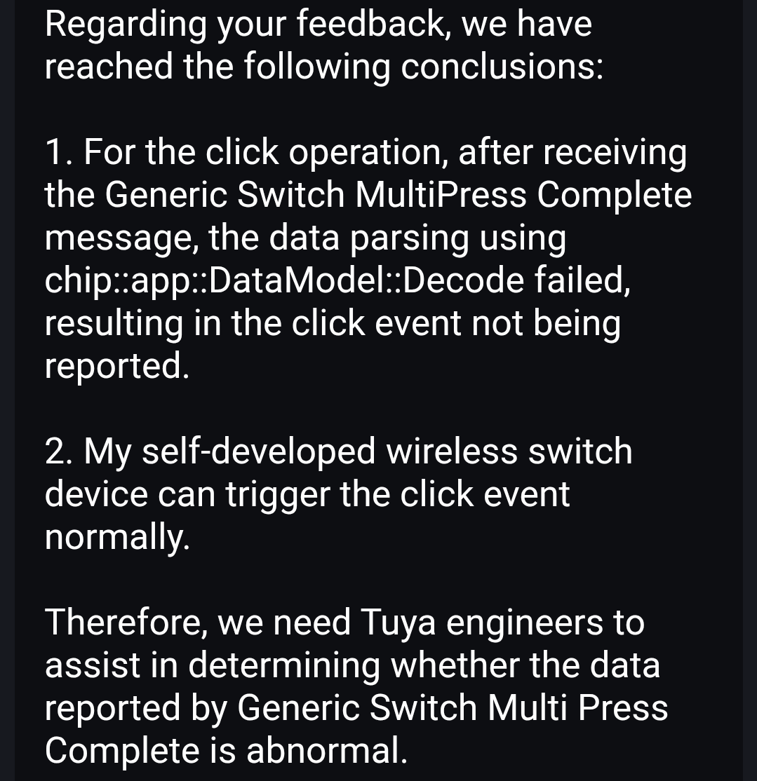

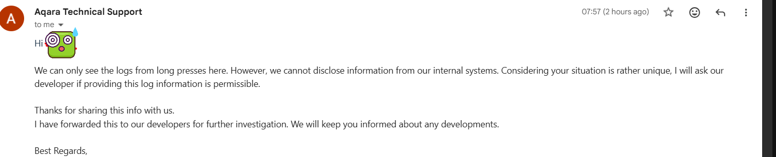

Sugar
Posts: 78
Re: Generic Scene Switch
Thank you for being so helpful. I appreciate it.
I will share further updates when Aqara responds.

Sugar
Posts: 78
fangping.guo 2026年 Feb 11日 14:36
Thank you for your email. I have understood the difference between TUYA and Aqara when sending events.
I will try to modify the code to make it work properly.
But there is a question: if the value of the event is correct but only the type is wrong (reported as signed), will Aqara accept it?
Hello :)
Long press is working with reported as signed, but they can't guarantee it will work with single or double press. They follow the matter documentation with their controllers, and in my opinion its not worth trying to make it work, because in future it could cause problems, for example, with Google, or any other matter platforms which will strictly follow matter documentation. It's better to make it as it should be and use it for all of the Tuya momentary switches, than later trying to fix it again, and change so much code for every single switch if it suddenly stops working somewhere due to a mismatch with Matter documentation.
Thank you.

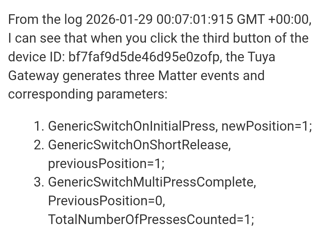

Sugar
Posts: 78
extra information:
GenericSwitchMultiPressComplete, PreviousPosition=0
Change that 0 to 1 and let's see if single press is working with reported as signed.

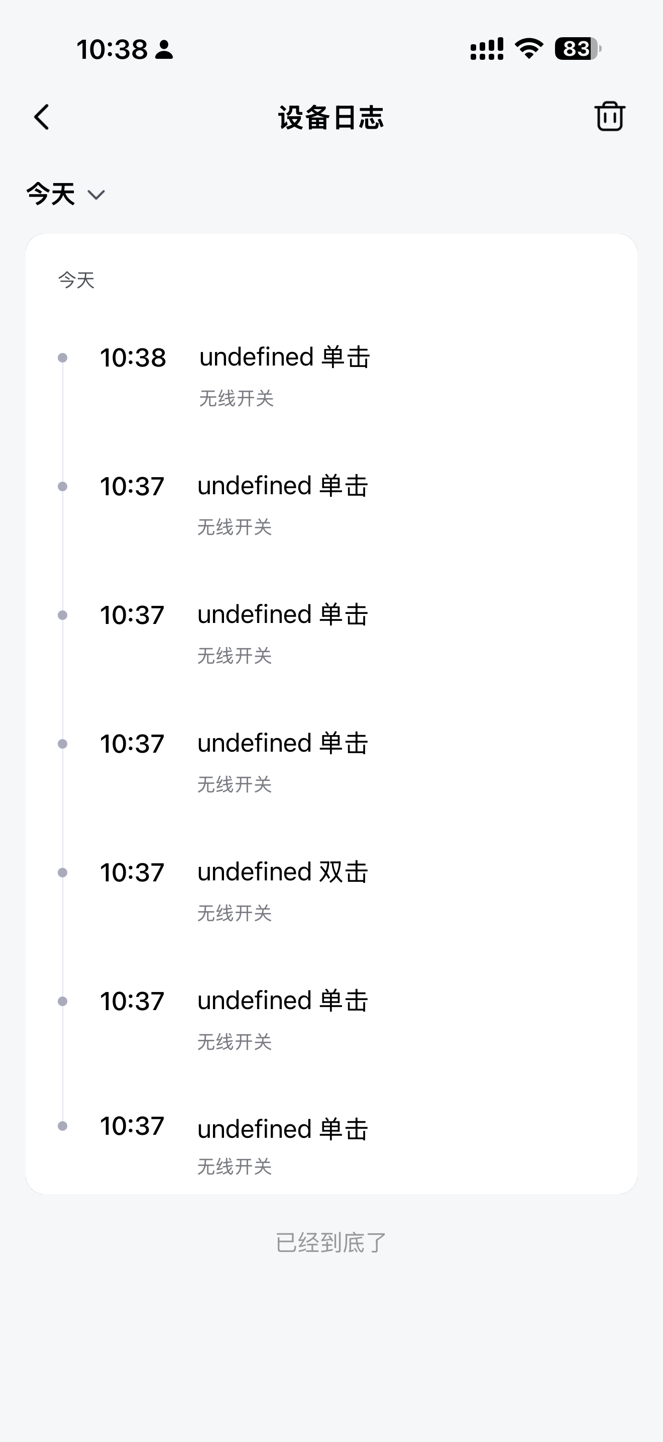

fangping.guo
Posts: 296
Hello, I have updated the configuration file again (without changing the data type issue. I hope it can be made usable without modifying the firmware).
Could you please unbind and rebind it to test if it is working properly now?

fangping.guo
Posts: 296
yes. zone china, aqara device id 【matt.7c49d0b6147c6446d2816000】
Sugar
Posts: 78
I will repeat unbind and bind again later. Which hub do you have for that screenshot? I have aqara m100.
