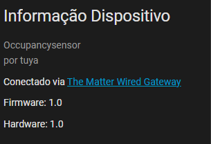

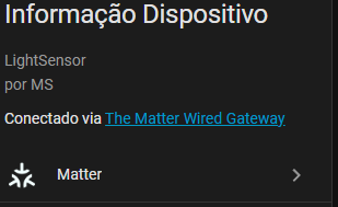

I just noticed that the human presence sensors aren't being exported correctly to Home Assistant and a new SmartThings installation!
In Home Assistant, I realized they're being provided under a different name than "tuya um MS".
Here's a screenshot of one sensor where the name and category are correct, and another where the name and category aren't correct, even though the "present" or "absent" function appears.

There are also some plugs, switches, and dimmers that aren't displaying their names and are also showing up as supplied by MS.

Yes, they are from the same product; there are 3 products! The problem is that, according to Matter, they are being exported as light sensors! They should be exported as occupancy sensors!
Could their category be changed?
