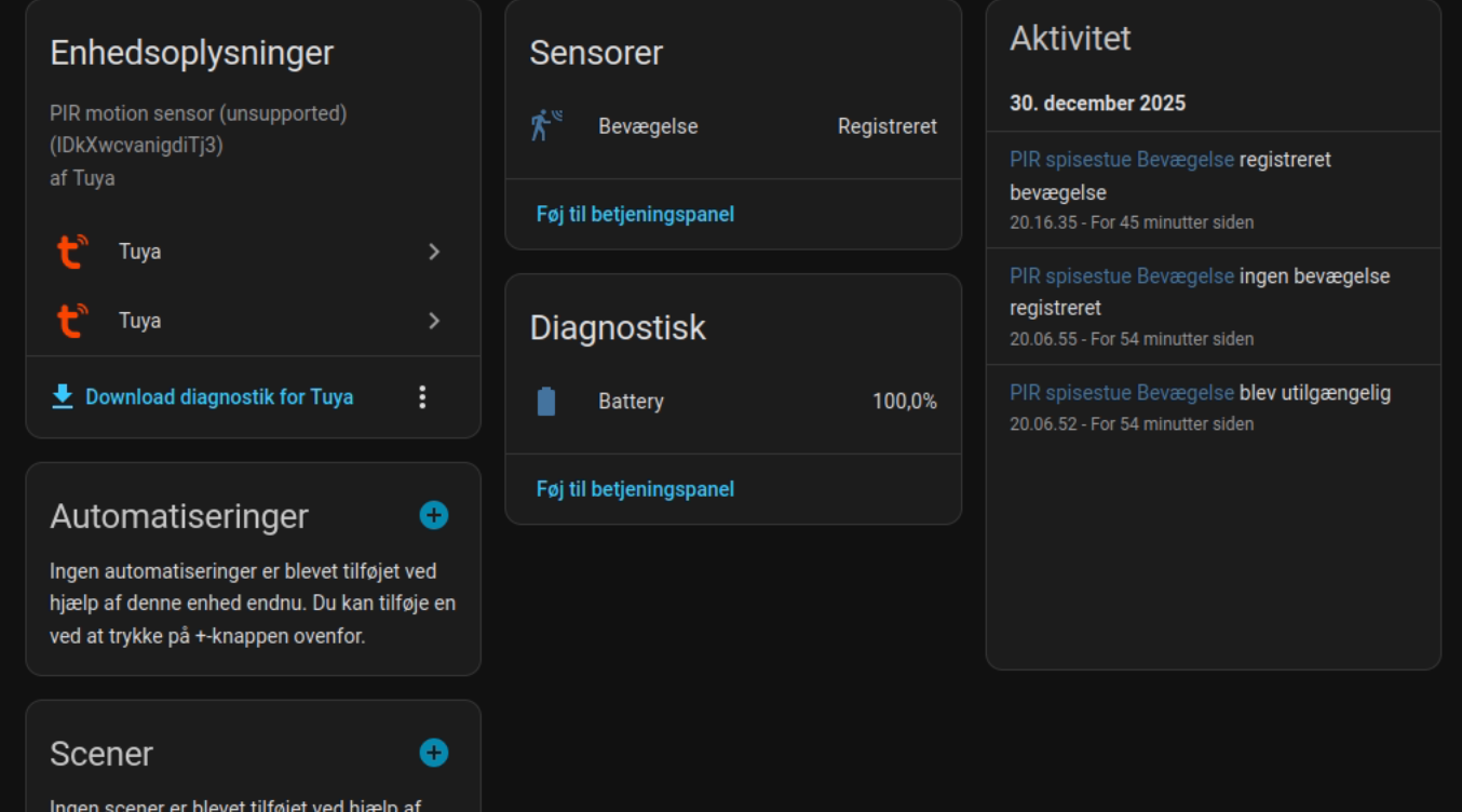

I have this sensor that works in the smart life app, but when they come into home Assistant, they don't seem to register movement. Can anyone help?

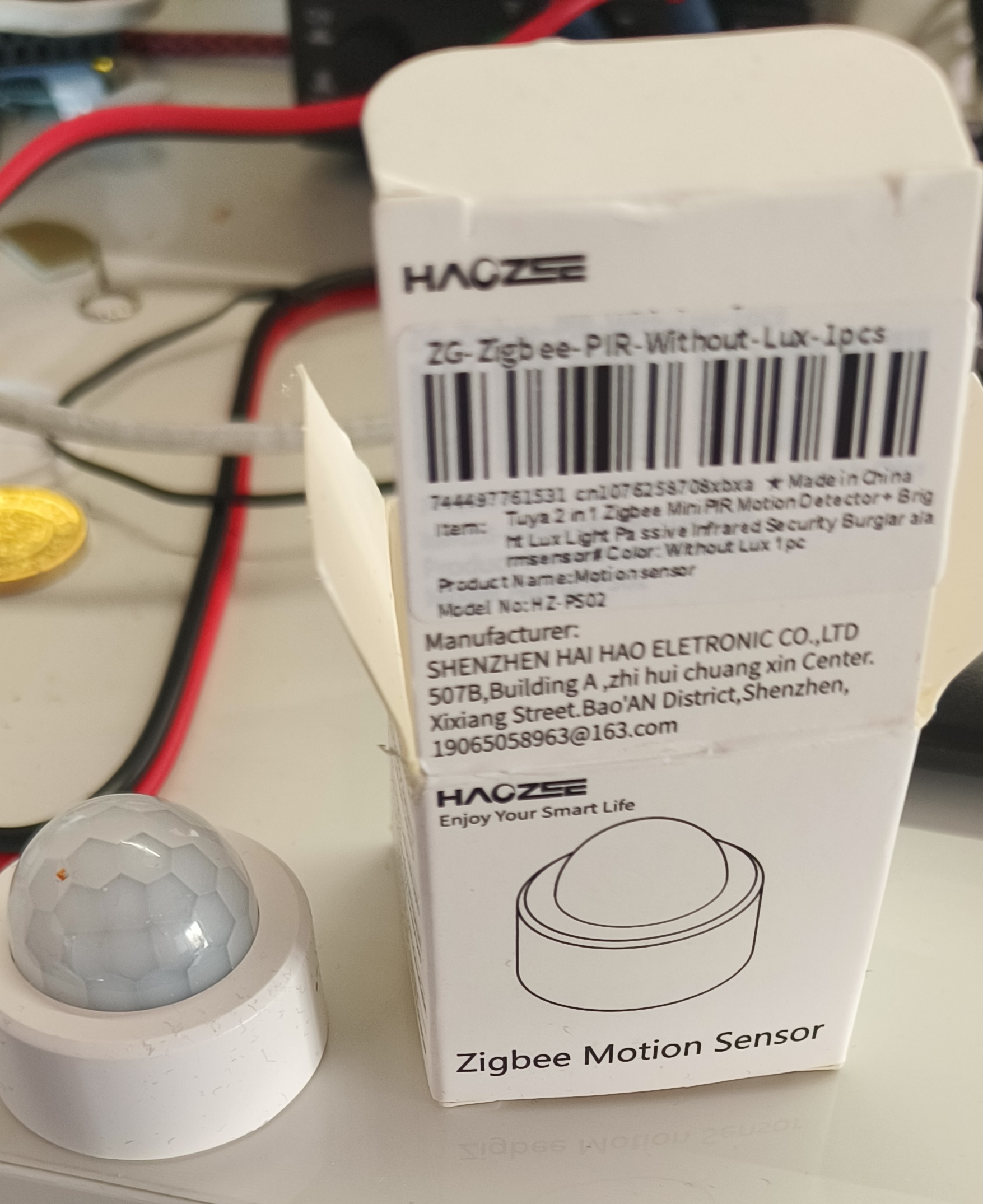

that's the kind of sensor I'm using, can anyone help with what's wrong??

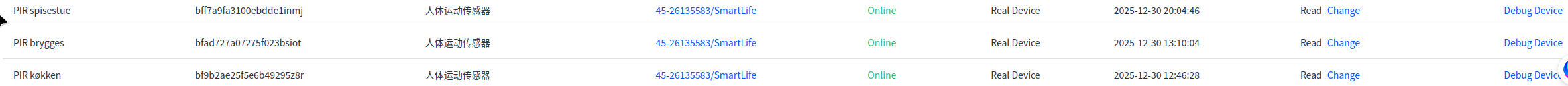

Hi, we have also checked the device bff7a9fa3100ebdde1inmj you reported. Its corresponding display logic has not been implemented in the plugin, so it cannot be used in Home Assistant. You need to contact the seller of your device for handling.

But I can see it in Home Assistant, how can that be when I can't see movement??
For device entities, Home Assistant is capable of detecting and displaying them. However, the specific functions of the devices need to be developed in the Home Assistant plugin — that is to say, it is necessary to support the logic for how the device functions are displayed on the device panel of Home Assistant.
