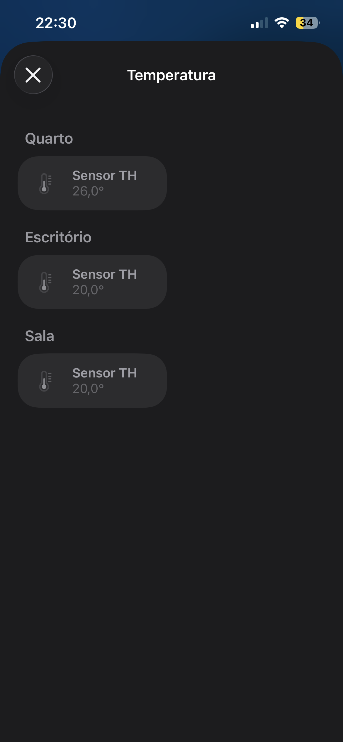

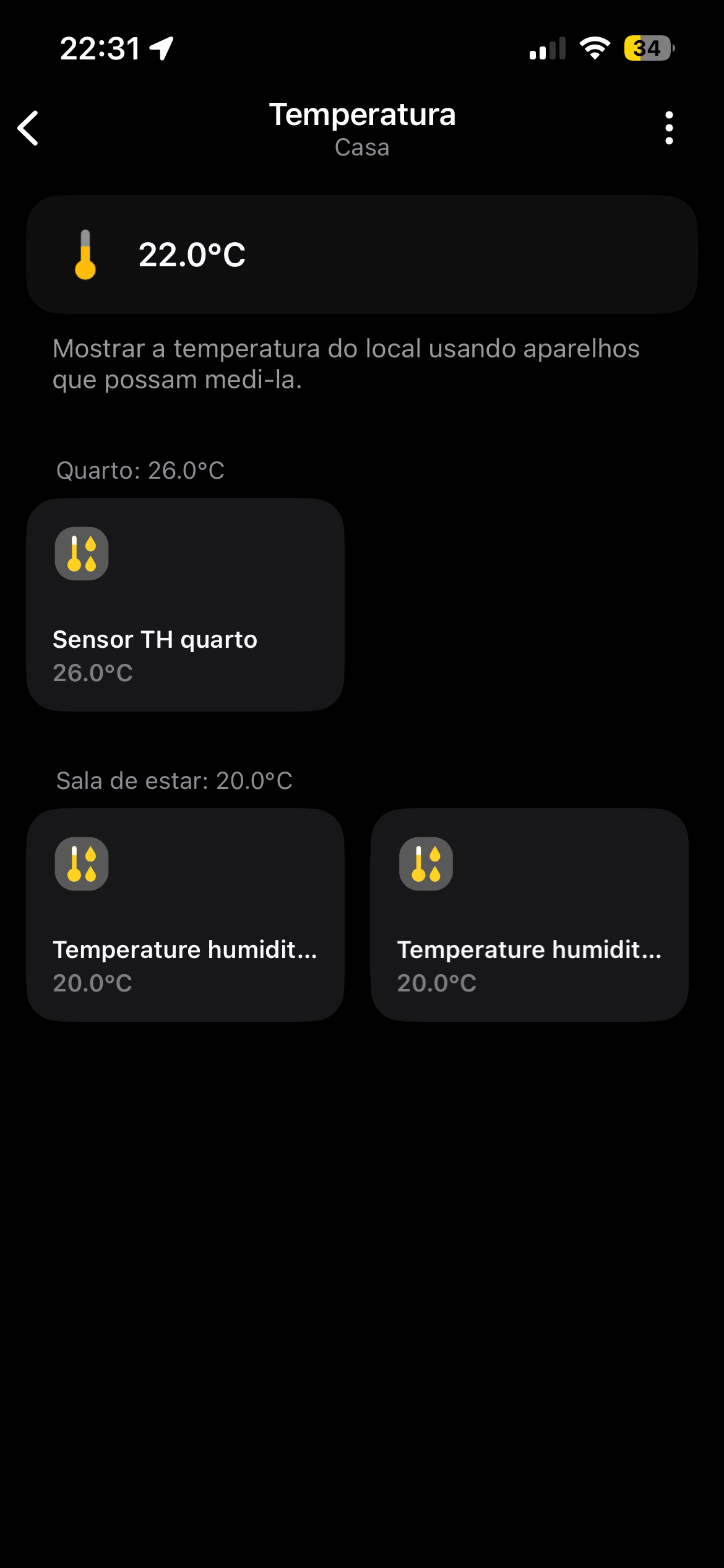

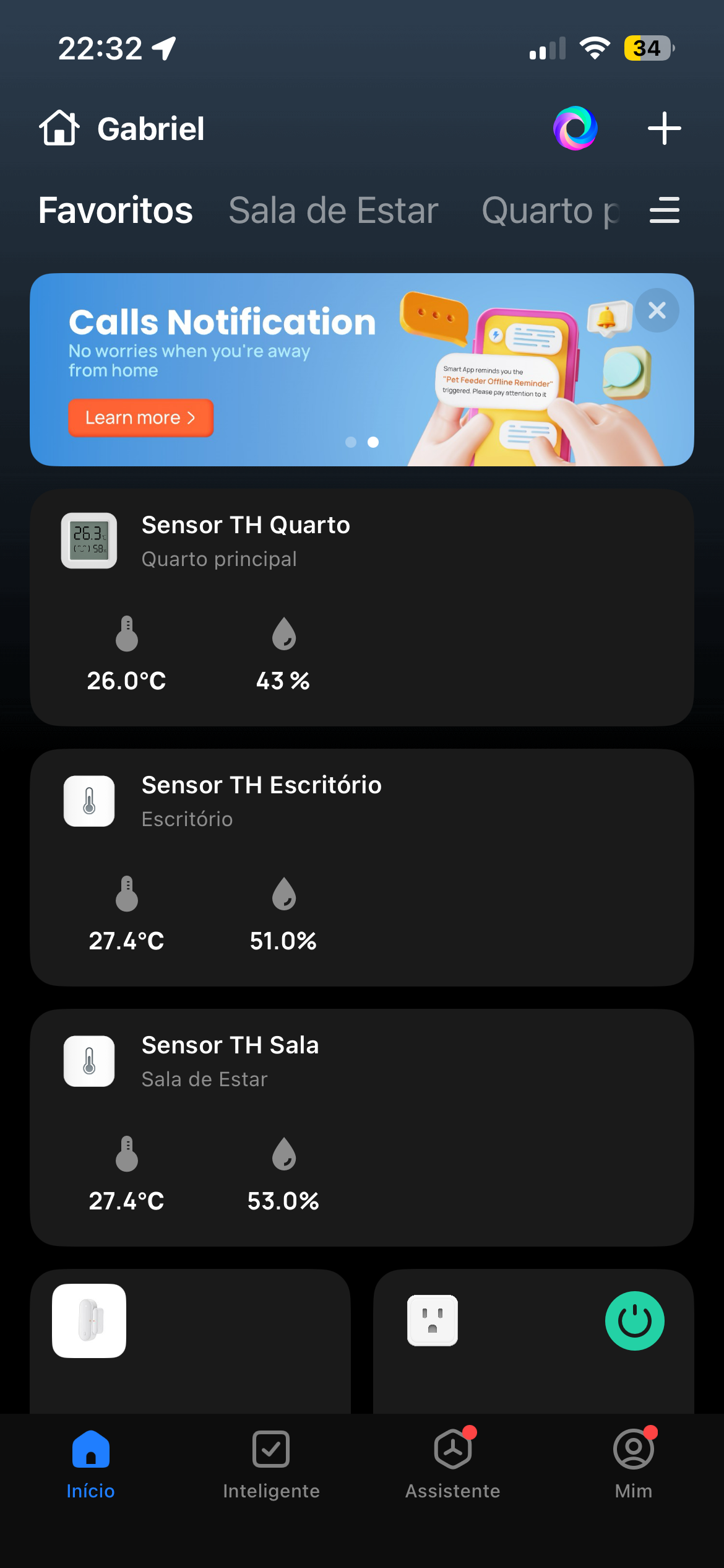

I have two generic temperature and humidity sensors that are correct on Tuya/smartlife app but wrong when exposing them over a NovaDigital matter hub/bridge.
Both sensors have their values stuck, not updating over matter.
I have another TH sensor from NovaDigital that is working as expected.
Virtual IDs from bad devices:
  1. eb6efe98e2a632a06afgbm
  2. ebd4cd93ddd18cd374z1xo
Virtual ID from working device:
eb8203fcb9bfaf8bfbq39d
HUB id: eb428010003609f5659dug
Tried on Apple HomeKit and Samsung ST: both have the same issues, so the issue is on the matter integration:

Re: Fix generic TH sensor
I have corrected the bridging configuration for the device. You can verify this by restarting the Tuya Matter gateway where the device is connected.
