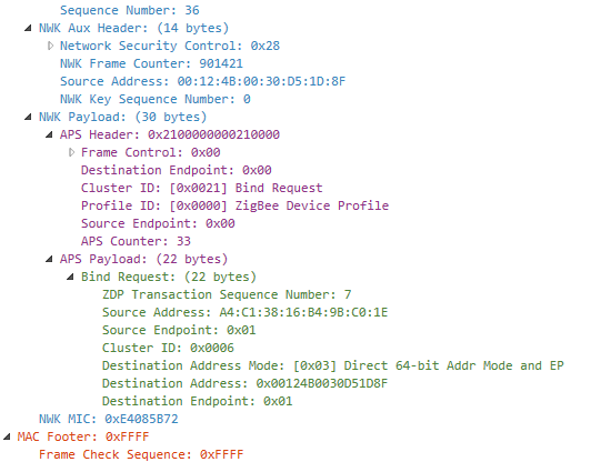

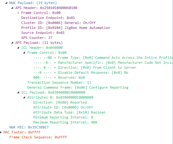

配网时,网关有下发bind request和configure reporting,如图所示。
static TAL_REPORT_TABLE_T g_dp_cluster_tbl[] =
    {TAL_REPORT_DIRECTION_REPORTED, 1, CLUSTER_ON_OFF_CLUSTER_ID, ATTR_ON_OFF_ATTRIBUTE_ID, ZG_CLUSTER_MASK_SERVER, 0, {{0, 65534, 1}}},
OPERATE_RET tuya_init_second(void)
    TAL_PR_DEBUG("/*********second init*********\r\n");
dev_zigbee_init();
tal_zg_reporting_init((TAL_REPORT_TABLE_T *)g_dp_cluster_tbl, ARRAY_LEN(g_dp_cluster_tbl));
tal_zg_read_attribute(DEV_ENDPOINT,
                                   &val_u8, 1);
            TAL_PR_DEBUG("before write onoff %d\n", val_u8);
            val_u8 = !val_u8;
            tal_zg_write_attribute(DEV_ENDPOINT,
                                   &val_u8, ATTR_BOOLEAN_ATTRIBUTE_TYPE);
                                   &val_u8, 1);
            TAL_PR_DEBUG("after write onoff %d\n", val_u8);
如上述代码,当onoff attribute值变化后,抓包也没有抓到有上报
