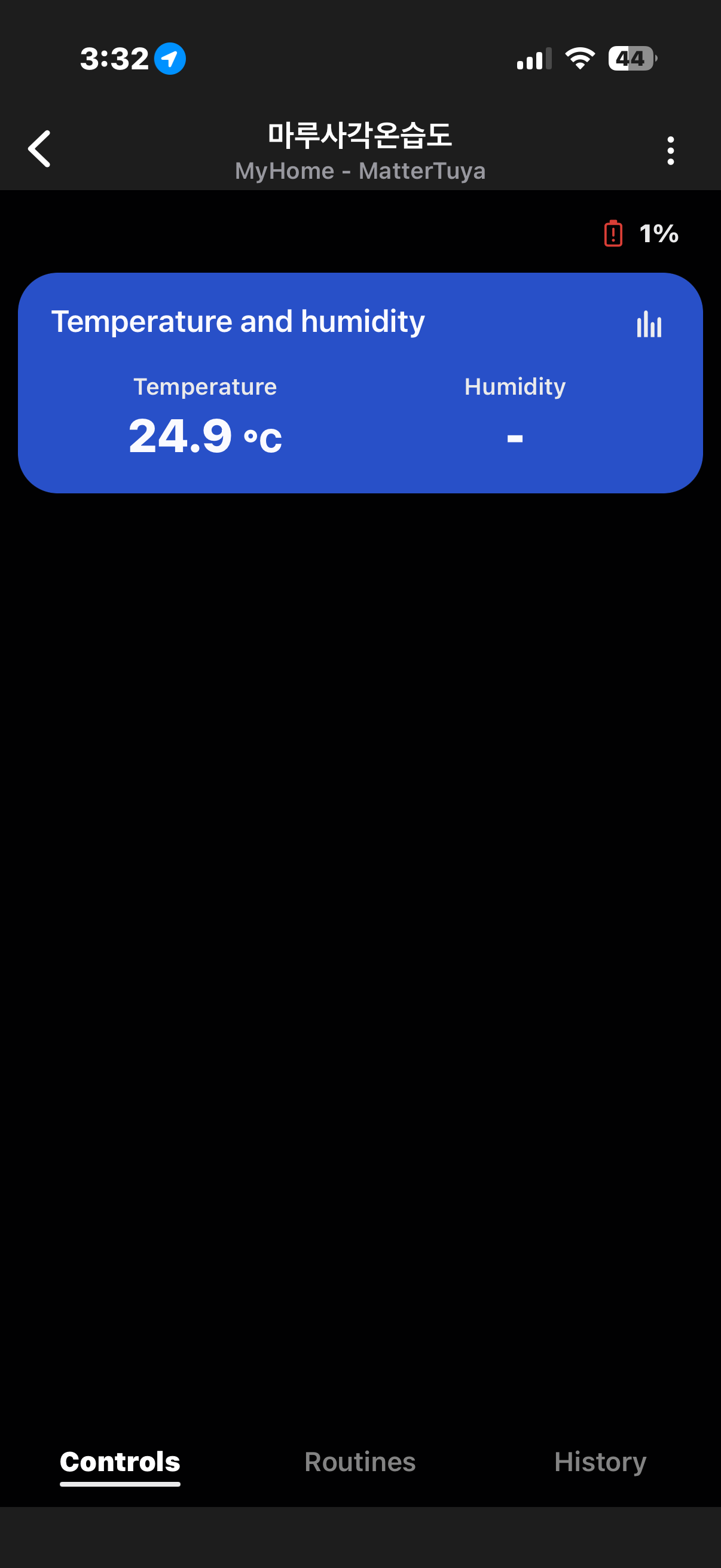

But I have two the temperature and humidity sensors :
eb14c252a015538f4fjgvh
eb8a3a6cae1b549cf4xuu9
The temperature and humidity sensor only shows the temperature.
Did you know why?

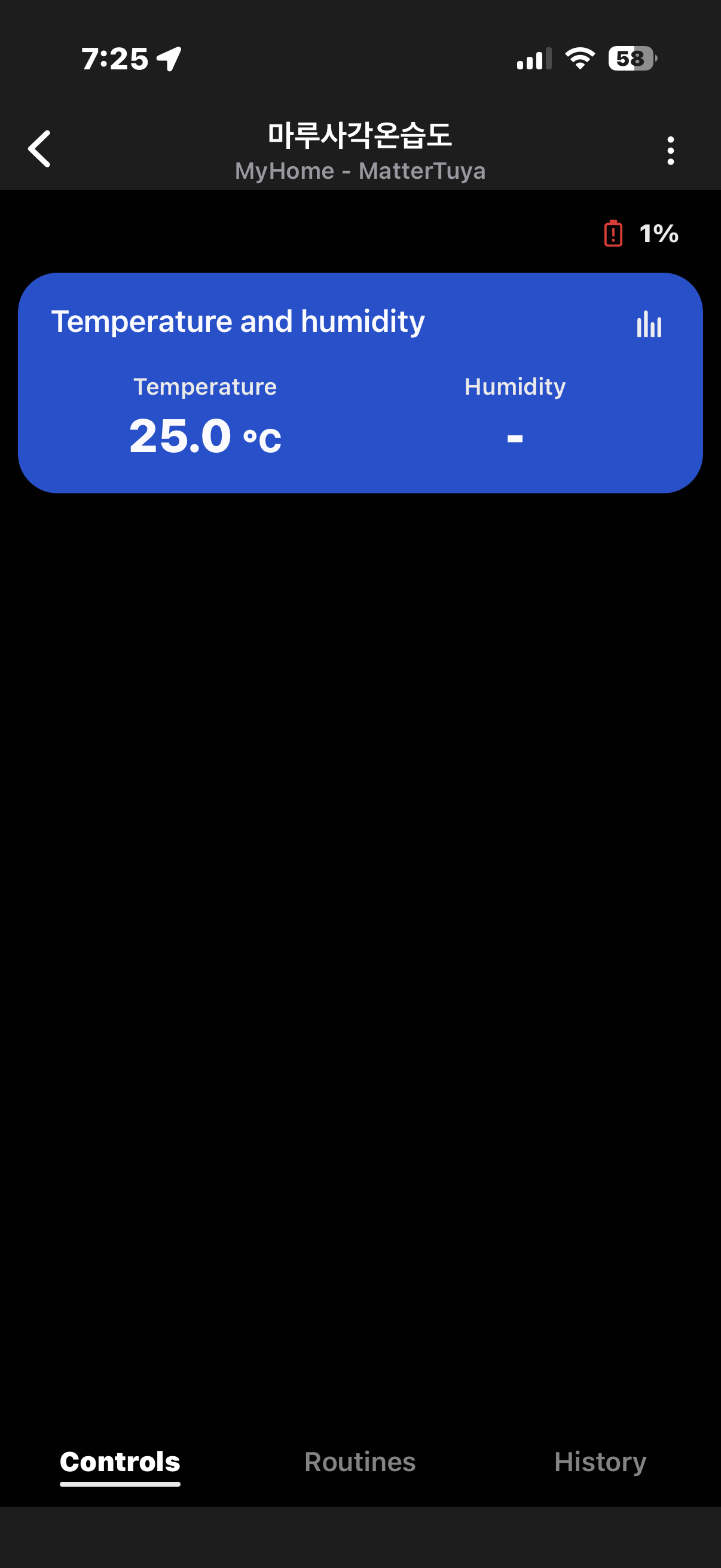

Hi, do you mean the temperature and humidity sensor only updates the temperature value but not the humidity value, or that the temperature and humidity sensor only displays the temperature interface and not the humidity interface? Could you provide a screenshot?
MatterPro
Posts: 7
Re: Sub-devices in Zemismart M1 is not exposed to Smartthings.
I attached the file.
The two temperature and humidity sensors are in the same situation.

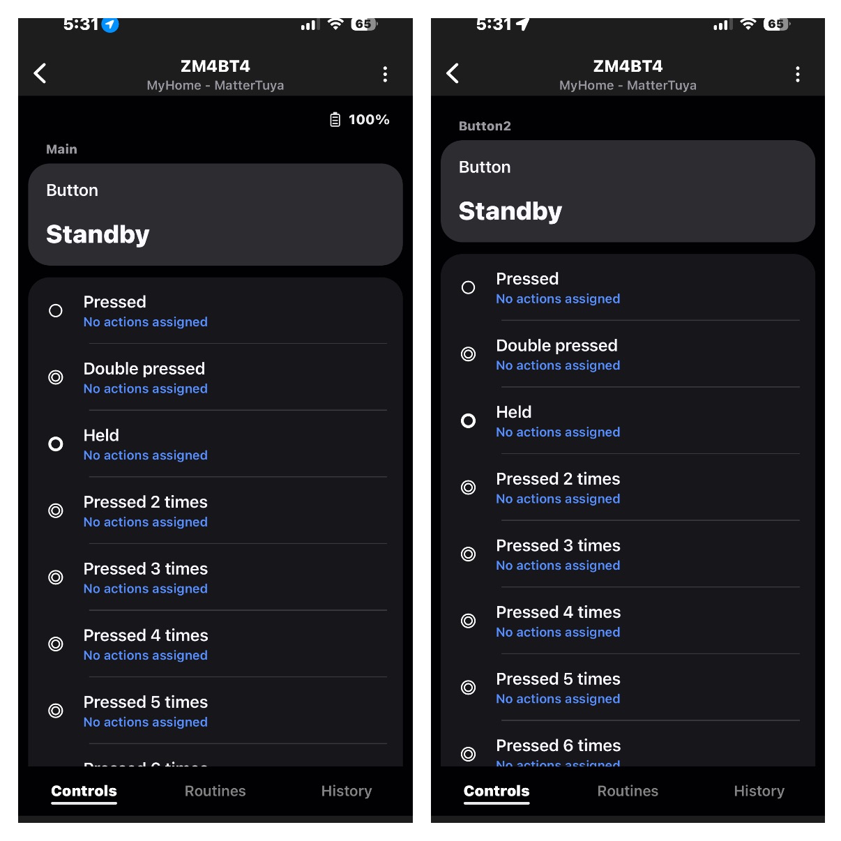

I have a wireless switch with 4 buttons.
The function of the button looks strange when it is shown on Smartthings.
one button has 3 functions(pressed, double-pressed, long pressed).
But It looks strange like the picture.
this ID : eb984cdd52ee9095d8oh43
thanks

Hello, I've adjusted the humidity scaling factor for the thermo-hygrometer sensor. Please restart the gateway for testing. Regarding the generic switch, this is the current design specification and I cannot make further modifications. Could you verify its functionality on platforms like Apple HomeKit or Home Assistant?

I rebooted M1 hub and Smartthings hub.
but the humidity value is not showed on Smartthings.
the same situation…
Also could you check the battery percentage value? the real value is not “1%”.
