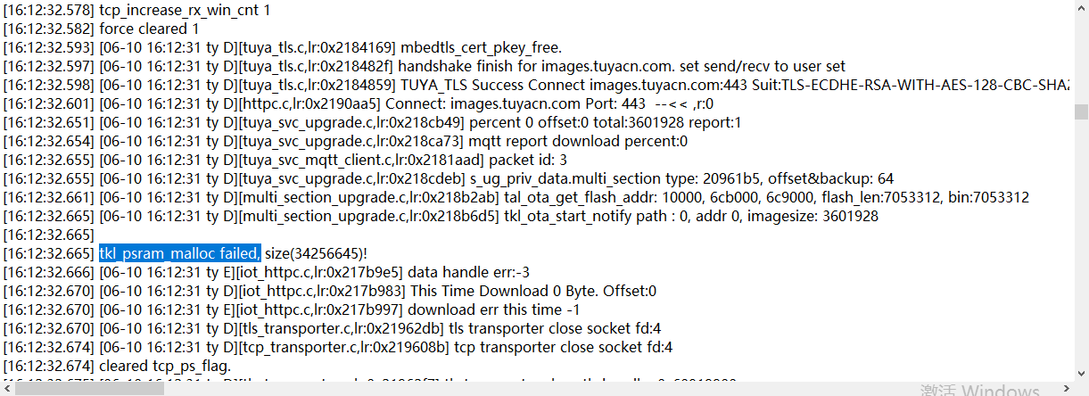

3.12.10版本,在OTA过程中重启,OTA失败
pwx1
Posts: 8
[16:12:32.593] [06-10 16:12:31 ty D][tuya_tls.c,lr:0x2184169] mbedtls_cert_pkey_free.
[16:12:32.597] [06-10 16:12:31 ty D][tuya_tls.c,lr:0x218482f] handshake finish for images.tuyacn.com. set send/recv to user set
[16:12:32.598] [06-10 16:12:31 ty D][tuya_tls.c,lr:0x2184859] TUYA_TLS Success Connect images.tuyacn.com:443 Suit:TLS-ECDHE-RSA-WITH-AES-128-CBC-SHA256
[16:12:32.601] [06-10 16:12:31 ty D][httpc.c,lr:0x2190aa5] Connect: images.tuyacn.com Port: 443 --<< ,r:0
[16:12:32.651] [06-10 16:12:31 ty D][tuya_svc_upgrade.c,lr:0x218cb49] percent 0 offset:0 total:3601928 report:1
[16:12:32.654] [06-10 16:12:31 ty D][tuya_svc_upgrade.c,lr:0x218ca73] mqtt report download percent:0
[16:12:32.655] [06-10 16:12:31 ty D][tuya_svc_mqtt_client.c,lr:0x2181aad] packet id: 3
[16:12:32.655] [06-10 16:12:31 ty D][tuya_svc_upgrade.c,lr:0x218cdeb] s_ug_priv_data.multi_section type: 20961b5, offset&backup: 64
[16:12:32.661] [06-10 16:12:31 ty D][multi_section_upgrade.c,lr:0x218b2ab] tal_ota_get_flash_addr: 10000, 6cb000, 6c9000, flash_len:7053312, bin:7053312
[16:12:32.665] [06-10 16:12:31 ty D][multi_section_upgrade.c,lr:0x218b6d5] tkl_ota_start_notify path : 0, addr 0, imagesize: 3601928
[16:12:32.665]
[16:12:32.665] tkl_psram_malloc failed, size(34256645)!

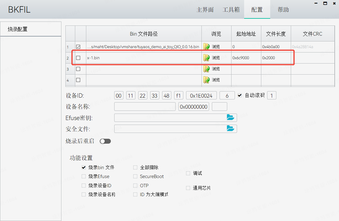

Posts: 955
Re: 3.12.10版本,在OTA过程中重启,OTA失败
3.12.10有个bug,会导致ota生i就失败,已经下线了。
恢复的方法:用原厂工具,把0x6c9000,8k大小的flash擦掉
然后升级到3.12.12版本。bug已经修复。
pwx1
Posts: 8
换成3.12.12版本,ota也还是报这个问题,请问这个需要怎么解决
