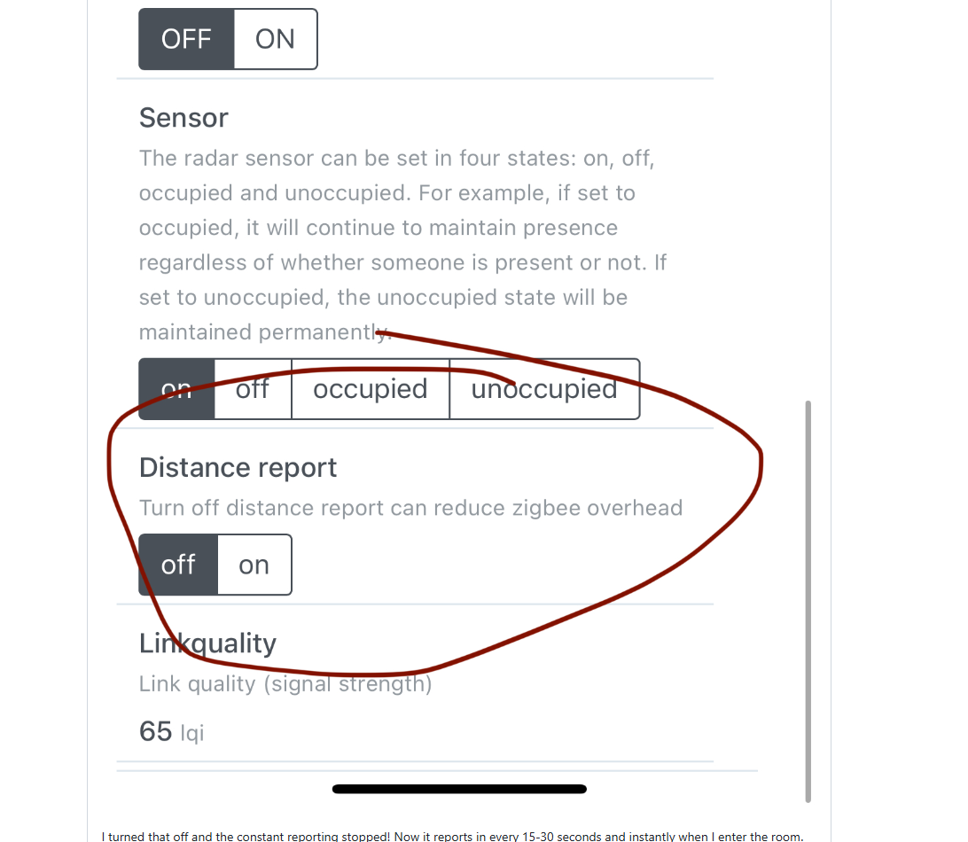

These presence detectors are reporting data every second.
The main reason for this is to get the distance feedback however this is flooding the zigbee network with data most people do not need.
There has been a reported fix to toggle on/off distance report - Can we get this published?
There are a few places this is being discussed -
https://github.com/Koenkk/zigbee2mqtt/issues/19045
https://github.com/wzwenzhi/Wenzhi-ZigBee2mqtt/issues/1
Distance Report
Distance Report
