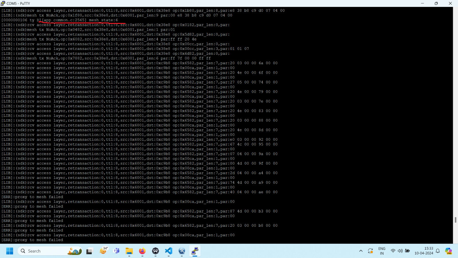

proxy to mesh failed error when device is in mesh state : 6 . Device has been added to the group for the first time and mesh commands are sent from the smartlife app . Mesh proxy error occurs and the device is unable to forward data to the mesh group .

According to your log information, the issue of “proxy fail” is due to the APP controlling too quickly. The proxy node is responsible for converting GATT data into ADV data for transmission, and the rate of GATT is much higher than that of mesh ADV. If control commands are sent too quickly, it will cause the fifo within the proxy node to be insufficient, leading to the loss of data exceeding the fifo, which will output the log “proxy to mesh failed”.
This problem is limited by the characteristics of the mesh proxy node and the size of the proxy fifo in the chip SDK. It is recommended to reduce the control speed according to the actual application scenario. If the application scenario indeed requires such a high rate of operation, then we need to discuss other special optimization methods.

We consulted with the chip manufacturer, and they do not recommend increasing the size of the FIFO. With the characteristics of the Proxy scheme, a larger FIFO could potentially cause data latency. For example, if there is rapid and substantial control from a mobile app, and then the control stops, the state of the device continues to change (because the control data in the FIFO is still queued for sending).
We have compared the Proxy schemes of several manufacturers, and most of them use a smaller Proxy FIFO to maintain the real-time nature of the data.
Additionally, according to the log screenshot you provided, a large number of color temperature control commands were sent after creating a group. Even if the FIFO is increased, if test data is sent rapidly for a long time, the Proxy FIFO may still be filled up, leading to a Proxy error (we can actually call this Proxy busy).

As for the problems you have left now, the first one is the probability of packet loss in fast group control devices. If most devices are successful and only a few devices lose packets, it can be determined that packets are lost during device scanning. There are multiple reasons for scanning packet loss, such as RF signals being interfered with or blocked on the hardware, or timers or other peripherals occupying interrupts for a high frequency and long time in the program, causing the Bluetooth interrupt to be unable to enter (the tlsr825x series chip does not support interrupt nesting and interrupt priority configuration). It is recommended that you check from these directions. In addition, the mesh protocol is through flood communication, by a large number of retransmissions to improve the success rate of communication, you can try to modify the mesh network transmit and relay retransmit parameters to increase the number of retransmissions to improve the success rate. You can use the following functions:
