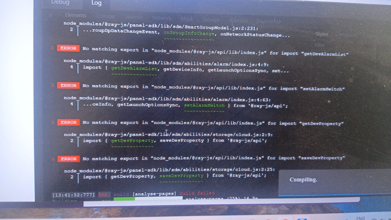

  • Log information:
  • Problem description (reproduction steps):
    • Install the package @ray-js/components-ty-slider@1.10.7.
    • Create a component using the code from above and start the project.
  • expected outcome:
    Circle Slider to appear on the Page
  • actual results:
    The App doesn't start and has error logs
Muzzzhi
Posts: 87
Re: Issue when using Tuya Slider Component
import React from 'react';
import Slider from '@ray-js/components-ty-slider';
export default function Home() {
  return (
    <Slider
      style={{ marginTop: 20 }}
      step={25}
      isShowTicks
      maxTrackHeight="8px"
      maxTrackRadius="8px"
      minTrackHeight="8px"
      minTrackColor="linear-gradient(to right, #158CFB, orange)"
      maxTrackTickHeight="4px"
      maxTrackTickWidth="4px"
      maxTrackTickRadius="2px"
      minTrackTickHeight="4px"
      minTrackTickWidth="4px"
      minTrackTickRadius="2px"
package.json
  "name": "app",
  "version": "1.0.0",
  "private": true,
  "devDependencies": {
    "@ray-js/cli": "latest",
    "@types/react": "^17.0.24",
    "@types/react-dom": "^17.0.9",
    "core-js": "^3.19.1",
    "react": "^17.0.2",
    "react-dom": "^17.0.2"
  "dependencies": {
    "@ray-js/components-ty-slider": "^0.2.40",
    "@ray-js/panel-sdk": "^1.10.0",
    "@ray-js/ray": "^1.4.45"
The version check is normal. It is recommended to delete the lock file and reinstall dependencies. "@ray-js/components-ty-slider" should not exist in version 1.10.7. You can use version 0.2.40 instead.
