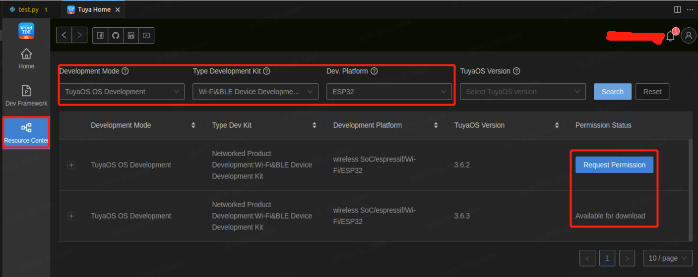

Re: control Tuya devices with esp via locale IP?
Posted: 2024年 Oct 5日 22:42
by bolinomartin
I am trying this but can not find ESP32 as Dec platform, when runing the project wizard
I have chosen Dev mode = TUYA OS
type dev kit = networked product Development/Wifi device
And under Dev platform i have wireless SOC and after that, nothing related to ESP32
My tuya ide version is 2.11.26
