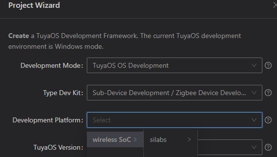

I am trying to make developement environment in a WindIde. Here comes the problem:
Developement mode: TuyaOS os developement
Type dev kit -> Subdevice developement->Zigbee device delelopement kit
Developement platform: Wireless soc -> Silabs (only Silabs is selectable)
Only soc wendor what I can select is Silabs. What I should select for STM32WB, whics is STMicroelectronics soc?

Dear Developer!
The development framework based on TuyaOS currently supported platform are:
  • EFR32MG21
  • EFR32MG24
  • TLSR8258
  • PHY622X
SDKs other than EFR32MG2x platforms need to apply for permission first.
the STM32WB platform is currently not supported,and can only be accessed as a three-party devices.
