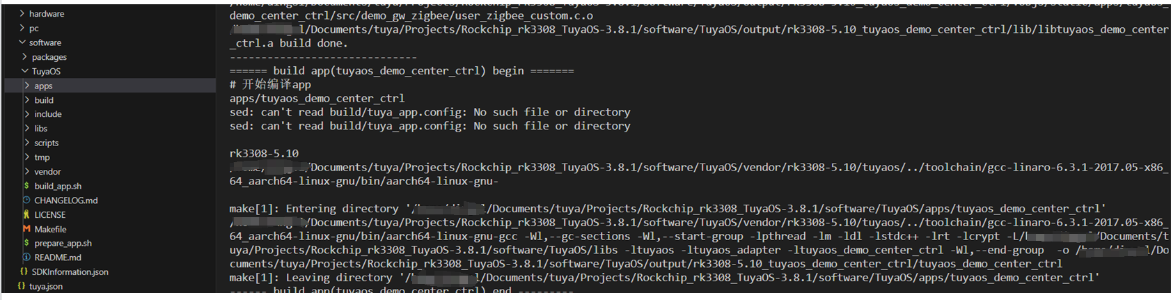

2) 问题现象:tuyaos_demo_center_ctrl demo编译报错
AR -rcs /home/kylin/Desktop/ty_plc_gw/software/TuyaOS/output/rk3308-5.10_tuyaos_demo_center_ctrl/lib/libtuyaos_demo_center_ctrl.a /home/kylin/Desktop/ty_plc_gw/software/TuyaOS/output/rk3308-5.10_tuyaos_demo_center_ctrl/.objs/static/apps/tuyaos_demo_center_ctrl/src/demo_gw_zigbee/user_zigbee_custom.c.o
/home/kylin/Desktop/ty_plc_gw/software/TuyaOS/output/rk3308-5.10_tuyaos_demo_center_ctrl/.objs/static/apps/tuyaos_demo_center_ctrl/src/demo_gw_zigbee/user_zigbee_local.c.o
/home/kylin/Desktop/ty_plc_gw/software/TuyaOS/output/rk3308-5.10_tuyaos_demo_center_ctrl/.objs/static/apps/tuyaos_demo_center_ctrl/src/demo_gw_zigbee/user_zigbee_svc.c.o
/home/kylin/Desktop/ty_plc_gw/software/TuyaOS/output/rk3308-5.10_tuyaos_demo_center_ctrl/.objs/static/apps/tuyaos_demo_center_ctrl/src/user_debug_svc.c.o
/home/kylin/Desktop/ty_plc_gw/software/TuyaOS/output/rk3308-5.10_tuyaos_demo_center_ctrl/.objs/static/apps/tuyaos_demo_center_ctrl/src/demo_home_ctrl/test_home_control_tv.c.o
/home/kylin/Desktop/ty_plc_gw/software/TuyaOS/output/rk3308-5.10_tuyaos_demo_center_ctrl/.objs/static/apps/tuyaos_demo_center_ctrl/src/demo_home_ctrl/test_home_ctrl_shortcut.c.o
/home/kylin/Desktop/ty_plc_gw/software/TuyaOS/output/rk3308-5.10_tuyaos_demo_center_ctrl/.objs/static/apps/tuyaos_demo_center_ctrl/src/demo_home_ctrl/test_home_ctrl_gas_alarm_sensor.c.o
/home/kylin/Desktop/ty_plc_gw/software/TuyaOS/output/rk3308-5.10_tuyaos_demo_center_ctrl/.objs/static/apps/tuyaos_demo_center_ctrl/src/demo_home_ctrl/test_home_control_voice.c.o
/home/kylin/Desktop/ty_plc_gw/software/TuyaOS/output/rk3308-5.10_tuyaos_demo_center_ctrl/.objs/static/apps/tuyaos_demo_center_ctrl/src/demo_home_ctrl/user_home_ctrl_svc.c.o
/home/kylin/Desktop/ty_plc_gw/software/TuyaOS/output/rk3308-5.10_tuyaos_demo_center_ctrl/.objs/static/apps/tuyaos_demo_center_ctrl/src/demo_home_ctrl/test_home_ctrl_fresh_air.c.o
/home/kylin/Desktop/ty_plc_gw/software/TuyaOS/output/rk3308-5.10_tuyaos_demo_center_ctrl/.objs/static/apps/tuyaos_demo_center_ctrl/src/demo_home_ctrl/test_home_control_sofa.c.o
/home/kylin/Desktop/ty_plc_gw/software/TuyaOS/output/rk3308-5.10_tuyaos_demo_center_ctrl/.objs/static/apps/tuyaos_demo_center_ctrl/src/demo_home_ctrl/test_home_ctrl_airer.c.o
/home/kylin/Desktop/ty_plc_gw/software/TuyaOS/output/rk3308-5.10_tuyaos_demo_center_ctrl/.objs/static/apps/tuyaos_demo_center_ctrl/src/demo_home_ctrl/test_home_ctrl_sos_sensor.c.o
/home/kylin/Desktop/ty_plc_gw/software/TuyaOS/output/rk3308-5.10_tuyaos_demo_center_ctrl/.objs/static/apps/tuyaos_demo_center_ctrl/src/demo_home_ctrl/test_home_ctrl_sockets.c.o
/home/kylin/Desktop/ty_plc_gw/software/TuyaOS/output/rk3308-5.10_tuyaos_demo_center_ctrl/.objs/static/apps/tuyaos_demo_center_ctrl/src/demo_home_ctrl/test_home_ctrl_air_purifier.c.o
/home/kylin/Desktop/ty_plc_gw/software/TuyaOS/output/rk3308-5.10_tuyaos_demo_center_ctrl/.objs/static/apps/tuyaos_demo_center_ctrl/src/demo_home_ctrl/tuya_home_control_sync.c.o
/home/kylin/Desktop/ty_plc_gw/software/TuyaOS/output/rk3308-5.10_tuyaos_demo_center_ctrl/.objs/static/apps/tuyaos_demo_center_ctrl/src/demo_home_ctrl/test_home_control_dev.c.o
/home/kylin/Desktop/ty_plc_gw/software/TuyaOS/output/rk3308-5.10_tuyaos_demo_center_ctrl/.objs/static/apps/tuyaos_demo_center_ctrl/src/demo_home_ctrl/test_home_ctrl_ac.c.o
/home/kylin/Desktop/ty_plc_gw/software/TuyaOS/output/rk3308-5.10_tuyaos_demo_center_ctrl/.objs/static/apps/tuyaos_demo_center_ctrl/src/demo_home_ctrl/tuya_home_control_demo.c.o
/home/kylin/Desktop/ty_plc_gw/software/TuyaOS/output/rk3308-5.10_tuyaos_demo_center_ctrl/.objs/static/apps/tuyaos_demo_center_ctrl/src/demo_home_ctrl/test_home_ctrl_pir_sensor.c.o
/home/kylin/Desktop/ty_plc_gw/software/TuyaOS/output/rk3308-5.10_tuyaos_demo_center_ctrl/.objs/static/apps/tuyaos_demo_center_ctrl/src/demo_home_ctrl/test_home_ctrl_scene_switch.c.o
/home/kylin/Desktop/ty_plc_gw/software/TuyaOS/output/rk3308-5.10_tuyaos_demo_center_ctrl/.objs/static/apps/tuyaos_demo_center_ctrl/src/demo_home_ctrl/test_home_ctrl_water_sensor.c.o
/home/kylin/Desktop/ty_plc_gw/software/TuyaOS/output/rk3308-5.10_tuyaos_demo_center_ctrl/.objs/static/apps/tuyaos_demo_center_ctrl/src/demo_home_ctrl/test_home_control_fanner.c.o
/home/kylin/Desktop/ty_plc_gw/software/TuyaOS/output/rk3308-5.10_tuyaos_demo_center_ctrl/.objs/static/apps/tuyaos_demo_center_ctrl/src/demo_home_ctrl/test_home_ctrl_socket.c.o
/home/kylin/Desktop/ty_plc_gw/software/TuyaOS/output/rk3308-5.10_tuyaos_demo_center_ctrl/.objs/static/apps/tuyaos_demo_center_ctrl/src/demo_home_ctrl/test_home_ctrl_door_sensor.c.o
/home/kylin/Desktop/ty_plc_gw/software/TuyaOS/output/rk3308-5.10_tuyaos_demo_center_ctrl/.objs/static/apps/tuyaos_demo_center_ctrl/src/demo_home_ctrl/test_home_ctrl_temp_ctrl.c.o
/home/kylin/Desktop/ty_plc_gw/software/TuyaOS/output/rk3308-5.10_tuyaos_demo_center_ctrl/.objs/static/apps/tuyaos_demo_center_ctrl/src/demo_home_ctrl/test_home_ctrl_light.c.o
/home/kylin/Desktop/ty_plc_gw/software/TuyaOS/output/rk3308-5.10_tuyaos_demo_center_ctrl/.objs/static/apps/tuyaos_demo_center_ctrl/src/demo_home_ctrl/test_home_ctrl_switch.c.o
/home/kylin/Desktop/ty_plc_gw/software/TuyaOS/output/rk3308-5.10_tuyaos_demo_center_ctrl/.objs/static/apps/tuyaos_demo_center_ctrl/src/demo_home_ctrl/test_home_ctrl_curtain.c.o
/home/kylin/Desktop/ty_plc_gw/software/TuyaOS/output/rk3308-5.10_tuyaos_demo_center_ctrl/.objs/static/apps/tuyaos_demo_center_ctrl/src/demo_home_ctrl/home_ctrl_demo_server.c.o
/home/kylin/Desktop/ty_plc_gw/software/TuyaOS/output/rk3308-5.10_tuyaos_demo_center_ctrl/.objs/static/apps/tuyaos_demo_center_ctrl/src/demo_home_ctrl/test_home_ctrl_thtb_sensor.c.o
/home/kylin/Desktop/ty_plc_gw/software/TuyaOS/output/rk3308-5.10_tuyaos_demo_center_ctrl/.objs/static/apps/tuyaos_demo_center_ctrl/src/user_iot_intf.c.o
/home/kylin/Desktop/ty_plc_gw/software/TuyaOS/output/rk3308-5.10_tuyaos_demo_center_ctrl/.objs/static/apps/tuyaos_demo_center_ctrl/src/user_main.c.o
/home/kylin/Desktop/ty_plc_gw/software/TuyaOS/output/rk3308-5.10_tuyaos_demo_center_ctrl/lib/libtuyaos_demo_center_ctrl.a build done.
====== build app(tuyaos_demo_center_ctrl) begin =======
开始编译app
sed: 无法读取 build/tuya_app.config: 没有那个文件或目录
rk3308-5.10
/home/kylin/Desktop/ty_plc_gw/software/TuyaOS/vendor/rk3308-5.10/tuyaos/../toolchain/gcc-linaro-6.3.1-2017.05-x86_64_aarch64-linux-gnu/bin/aarch64-linux-gnu-
make[1]: 进入目录“/home/kylin/Desktop/ty_plc_gw/software/TuyaOS/apps/tuyaos_demo_center_ctrl”
/home/kylin/Desktop/ty_plc_gw/software/TuyaOS/vendor/rk3308-5.10/tuyaos/../toolchain/gcc-linaro-6.3.1-2017.05-x86_64_aarch64-linux-gnu/bin/aarch64-linux-gnu-gcc -Wl,--gc-sections -Wl,--start-group -lpthread -lm -ldl -lstdc++ -lrt -lcrypt -L/home/kylin/Desktop/ty_plc_gw/software/TuyaOS/libs -ltuyaos -ltuyaos_adapter -ltuyaos_demo_center_ctrl -Wl,--end-group -o /home/kylin/Desktop/ty_plc_gw/software/TuyaOS/output/rk3308-5.10_tuyaos_demo_center_ctrl/tuyaos_demo_center_ctrl
make[1]: 离开目录“/home/kylin/Desktop/ty_plc_gw/software/TuyaOS/apps/tuyaos_demo_center_ctrl”
------ build app(tuyaos_demo_center_ctrl) end ---------

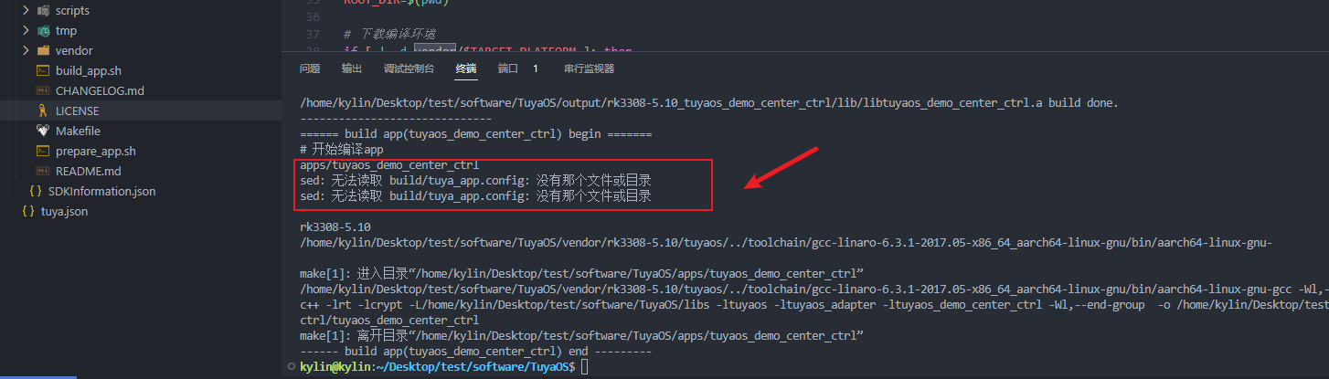

wyh
Posts: 59
Re: 【已处理】【中控】【TuyaOS SDK】RK3308 demo编译缺失tuya_app.config文件
这就是用wind IDE编译的呀
luoji
Posts: 119
这个截图有build end,代表已经编译成功了。这个.config文件的提示不用处理
