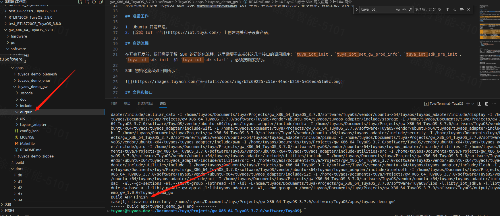

这个SDK可以在改了PID和授权信息后,能直接在ubuntu上编译运行吗? 编译的时候没有看到err,但是output目录下没有任何输出,这是什么原因?
./build_app.sh apps/tuyaos_demo_gw tuyaos_demo_gw 1.0.0
APP_PATH=apps/tuyaos_demo_gw
APP_NAME=tuyaos_demo_gw
APP_VERSION=1.0.0
USER_CMD=
/home/tuyaos/Documents/tuya/Projects/gw_X86_64_TuyaOS_3.7.0/software/TuyaOS/vendor/ubuntu-x64/tuyaos/build_path not found in vendor [ ubuntu-x64 ]!
APP_VERSION= 1.0.0
TARGET_PLATFORM= ubuntu-x64
Traceback (most recent call last):
File "./scripts/set_app_config.py", line 15, in <module>
from ruamel import yaml # pip3 install ruamel.yaml
ModuleNotFoundError: No module named 'ruamel'
grep: make.yaml: No such file or directory
toolchain Name: ubuntu-x64
toolchain Repo: https://airtake-public-data-1254153901. ... u-x64_.zip
toolchain Version:
++++++++++++++++++++ CI package fullname ++++++++++++++++++++
++++++++++++++++++++ the SDK ID tuyaos_demo_gw_1.0.0_ubuntu-x64 ++++++++++++++++++++
generate build_param for [ tuyaos_demo_gw ] AT [ ubuntu-x64 ]
Project [ tuyaos_demo_gw ] Param:
BUILD_DATE=2023_09_20
BUILD_TIME=10_15_30
GIT_USER=
IOT_SDK_VER=1.0.0
IPC_SDK_VER=1.0.0
SDK_FULL_VER=1.0.0
SDK_BETA_VER=
IOT_SDK_VER_MAJOR=1
IOT_SDK_VER_MINOR=0
IOT_SDK_VER_PATCH=0
KERNEL_VERSION=
PROJECT_NAME=tuyaos_demo_gw
TARGET_PLATFORM=ubuntu-x64
TARGET_PLATFORM_REPO=https://airtake-public-data-1254153901. ... u-x64_.zip
TARGET_PLATFORM_VERSION=
BUILD_STATIC=1
BUILD_SHARED=
SDK_ID=tuyaos_demo_gw_1.0.0_ubuntu-x64
ROOT_DIR=/home/tuyaos/Documents/tuya/Projects/gw_X86_64_TuyaOS_3.7.0/software/TuyaOS
OUTPUT_DIR=$(ROOT_DIR)/output/$(TARGET_PLATFORM)_$(PROJECT_NAME)
OUTPUT_DIR_INC=$(OUTPUT_DIR)/include
OUTPUT_DIR_STATIC_LIB=$(OUTPUT_DIR)/static/lib
OUTPUT_DIR_SHARED_LIB=$(OUTPUT_DIR)/shared/lib
OUTPUT_DIR_STATIC_OBJS=$(OUTPUT_DIR)/static/objs
OUTPUT_DIR_SHARED_OBJS=$(OUTPUT_DIR)/shared/objs
COMPILE_PREX =
TUYAOS_BUILD_PATH = /home/tuyaos/Documents/tuya/Projects/gw_X86_64_TuyaOS_3.7.0/software/TuyaOS/vendor/ubuntu-x64/tuyaos
AR = $(COMPILE_PREX)ar
CC = $(COMPILE_PREX)gcc
NM = $(COMPILE_PREX)nm
CPP = $(COMPILE_PREX)g++
STRIP = $(COMPILE_PREX)strip
OBJCOPY = $(COMPILE_PREX)objcopy
OBJDUMP = $(COMPILE_PREX)objdump
RANLIB = $(COMPILE_PREX)ranlib
CXX = $(COMPILE_PREX)g++
CFLAGS =
CFLAGS += -pipe -D_REENTRANT -Wall -Wno-unused-result -Wno-format-truncation -Wno-maybe-uninitialized
ifeq ($(CONFIG_OPERATING_SYSTEM), 100)
CFLAGS += -fPIC -std=gnu99 -ffunction-sections -fdata-sections -fstack-protector-all
endif
ifeq ($(CONFIG_TUYA_IOT_DEBUG), 1)
CFLAGS += -g
endif
ifdef PRJ_DEFINES
CFLAGS += $(PRJ_DEFINES)
endif
ifdef COMPILE_INCLUDE
CFLAGS += -I $(COMPILE_INCLUDE)
endif
ifdef COMPILE_LIB
export LD_LIBRARY_PATH=$(COMPILE_LIB)
endif
LINKFLAGS =
LINKFLAGS += -lpthread -lm -ldl
endif
ifdef PRJ_LINKS
LINKFLAGS += $(PRJ_LINKS)
endif
clean application static ...
AR -rcs /home/tuyaos/Documents/tuya/Projects/gw_X86_64_TuyaOS_3.7.0/software/TuyaOS/output/ubuntu-x64_tuyaos_demo_gw/lib/libtuyaapp_components.a
/home/tuyaos/Documents/tuya/Projects/gw_X86_64_TuyaOS_3.7.0/software/TuyaOS/output/ubuntu-x64_tuyaos_demo_gw/lib/libtuyaapp_components.a build done.
AR -rcs /home/tuyaos/Documents/tuya/Projects/gw_X86_64_TuyaOS_3.7.0/software/TuyaOS/output/ubuntu-x64_tuyaos_demo_gw/lib/libtuyaapp_drivers.a
/home/tuyaos/Documents/tuya/Projects/gw_X86_64_TuyaOS_3.7.0/software/TuyaOS/output/ubuntu-x64_tuyaos_demo_gw/lib/libtuyaapp_drivers.a build done.
AR -rcs /home/tuyaos/Documents/tuya/Projects/gw_X86_64_TuyaOS_3.7.0/software/TuyaOS/output/ubuntu-x64_tuyaos_demo_gw/lib/libtuyaos_demo_gw.a
/home/tuyaos/Documents/tuya/Projects/gw_X86_64_TuyaOS_3.7.0/software/TuyaOS/output/ubuntu-x64_tuyaos_demo_gw/lib/libtuyaos_demo_gw.a build done.
====== build app(tuyaos_demo_gw) begin =======
开始编译app
apps/tuyaos_demo_gw
make[1]: Entering directory '/home/tuyaos/Documents/tuya/Projects/gw_X86_64_TuyaOS_3.7.0/software/TuyaOS/apps/tuyaos_demo_gw'
gcc /home/tuyaos/Documents/tuya/Projects/gw_X86_64_TuyaOS_3.7.0/software/TuyaOS/output/tuyaos_demo_gw_1.0.0/.objs/./src/user_main.c.o /home/tuyaos/Documents/tuya/Projects/gw_X86_64_TuyaOS_3.7.0/software/TuyaOS/output/tuyaos_demo_gw_1.0.0/.objs/./src/user_dev_svc.c.o /home/tuyaos/Documents/tuya/Projects/gw_X86_64_TuyaOS_3.7.0/software/TuyaOS/output/tuyaos_demo_gw_1.0.0/.objs/./tuyaos_adapter/wired/tkl_wired.c.o /home/tuyaos/Documents/tuya/Projects/gw_X86_64_TuyaOS_3.7.0/software/TuyaOS/output/tuyaos_demo_gw_1.0.0/.objs/./tuyaos_adapter/system/tkl_thread.c.o /home/tuyaos/Documents/tuya/Projects/gw_X86_64_TuyaOS_3.7.0/software/TuyaOS/output/tuyaos_demo_gw_1.0.0/.objs/./tuyaos_adapter/system/tkl_watchdog.c.o /home/tuyaos/Documents/tuya/Projects/gw_X86_64_TuyaOS_3.7.0/software/TuyaOS/output/tuyaos_demo_gw_1.0.0/.objs/./tuyaos_adapter/system/tkl_semaphore.c.o /home/tuyaos/Documents/tuya/Projects/gw_X86_64_TuyaOS_3.7.0/software/TuyaOS/output/tuyaos_demo_gw_1.0.0/.objs/./tuyaos_adapter/system/tkl_sleep.c.o /home/tuyaos/Documents/tuya/Projects/gw_X86_64_TuyaOS_3.7.0/software/TuyaOS/output/tuyaos_demo_gw_1.0.0/.objs/./tuyaos_adapter/system/tkl_output.c.o /home/tuyaos/Documents/tuya/Projects/gw_X86_64_TuyaOS_3.7.0/software/TuyaOS/output/tuyaos_demo_gw_1.0.0/.objs/./tuyaos_adapter/system/tkl_system.c.o /home/tuyaos/Documents/tuya/Projects/gw_X86_64_TuyaOS_3.7.0/software/TuyaOS/output/tuyaos_demo_gw_1.0.0/.objs/./tuyaos_adapter/system/tkl_memory.c.o /home/tuyaos/Documents/tuya/Projects/gw_X86_64_TuyaOS_3.7.0/software/TuyaOS/output/tuyaos_demo_gw_1.0.0/.objs/./tuyaos_adapter/system/tkl_ota.c.o /home/tuyaos/Documents/tuya/Projects/gw_X86_64_TuyaOS_3.7.0/software/TuyaOS/output/tuyaos_demo_gw_1.0.0/.objs/./tuyaos_adapter/system/tkl_mutex.c.o /home/tuyaos/Documents/tuya/Projects/gw_X86_64_TuyaOS_3.7.0/software/TuyaOS/output/tuyaos_demo_gw_1.0.0/.objs/./tuyaos_adapter/system/tkl_fs.c.o /home/tuyaos/Documents/tuya/Projects/gw_X86_64_TuyaOS_3.7.0/software/TuyaOS/output/tuyaos_demo_gw_1.0.0/.objs/./tuyaos_adapter/system/tkl_queue.c.o /home/tuyaos/Documents/tuya/Projects/gw_X86_64_TuyaOS_3.7.0/software/TuyaOS/output/tuyaos_demo_gw_1.0.0/.objs/./tuyaos_adapter/uart/tkl_uart.c.o /home/tuyaos/Documents/tuya/Projects/gw_X86_64_TuyaOS_3.7.0/software/TuyaOS/output/tuyaos_demo_gw_1.0.0/.objs/./tuyaos_adapter/wifi/tkl_wifi.c.o /home/tuyaos/Documents/tuya/Projects/gw_X86_64_TuyaOS_3.7.0/software/TuyaOS/output/tuyaos_demo_gw_1.0.0/.objs/./tuyaos_adapter/bluetooth/tkl_bluetooth.c.o -g -fPIC -DAPP_BIN_NAME=\"tuyaos_demo_gw\" -DUSER_SW_VER=\"1.0.0\" -I ./include -I /home/tuyaos/Documents/tuya/Projects/gw_X86_64_TuyaOS_3.7.0/software/TuyaOS/include -I /home/tuyaos/Documents/tuya/Projects/gw_X86_64_TuyaOS_3.7.0/software/TuyaOS/include/components -I /home/tuyaos/Documents/tuya/Projects/gw_X86_64_TuyaOS_3.7.0/software/TuyaOS/include/components/svc_api_iot -I /home/tuyaos/Documents/tuya/Projects/gw_X86_64_TuyaOS_3.7.0/software/TuyaOS/include/components/svc_api_iot/include -I /home/tuyaos/Documents/tuya/Projects/gw_X86_64_TuyaOS_3.7.0/software/TuyaOS/include/components/svc_notification -I /home/tuyaos/Documents/tuya/Projects/gw_X86_64_TuyaOS_3.7.0/software/TuyaOS/include/components/svc_notification/include -I /home/tuyaos/Documents/tuya/Projects/gw_X86_64_TuyaOS_3.7.0/software/TuyaOS/include/components/gw_base_utilities -I /home/tuyaos/Documents/tuya/Projects/gw_X86_64_TuyaOS_3.7.0/software/TuyaOS/include/components/gw_base_utilities/include -I /home/tuyaos/Documents/tuya/Projects/gw_X86_64_TuyaOS_3.7.0/software/TuyaOS/include/components/tal_system -I /home/tuyaos/Documents/tuya/Projects/gw_X86_64_TuyaOS_3.7.0/software/TuyaOS/include/components/tal_system/include -I /home/tuyaos/Documents/tuya/Projects/gw_X86_64_TuyaOS_3.7.0/software/TuyaOS/include/components/svc_thread_dump_linux -I /home/tuyaos/Documents/tuya/Projects/gw_X86_64_TuyaOS_3.7.0/software/TuyaOS/include/components/svc_thread_dump_linux/include -I /home/tuyaos/Documents/tuya/Projects/gw_X86_64_TuyaOS_3.7.0/software/TuyaOS/include/components/svc_rpc -I /home/tuyaos/Documents/tuya/Projects/gw_X86_64_TuyaOS_3.7.0/software/TuyaOS/include/components/svc_rpc/include -I /home/tuyaos/Documents/tuya/Projects/gw_X86_64_TuyaOS_3.7.0/software/TuyaOS/include/components/svc_dp -I /home/tuyaos/Documents/tuya/Projects/gw_X86_64_TuyaOS_3.7.0/software/TuyaOS/include/components/svc_dp/include -I /home/tuyaos/Documents/tuya/Projects/gw_X86_64_TuyaOS_3.7.0/software/TuyaOS/include/components/svc_wifi -I /home/tuyaos/Documents/tuya/Projects/gw_X86_64_TuyaOS_3.7.0/software/TuyaOS/include/components/svc_wifi/include -I /home/tuyaos/Documents/tuya/Projects/gw_X86_64_TuyaOS_3.7.0/software/TuyaOS/include/components/lib_tls -I /home/tuyaos/Documents/tuya/Projects/gw_X86_64_TuyaOS_3.7.0/software/TuyaOS/include/components/lib_tls/include -I /home/tuyaos/Documents/tuya/Projects/gw_X86_64_TuyaOS_3.7.0/software/TuyaOS/include/components/lib_tls/include/mbedtls -I /home/tuyaos/Documents/tuya/Projects/gw_X86_64_TuyaOS_3.7.0/software/TuyaOS/include/components/sdk_adpt_com_api -I /home/tuyaos/Documents/tuya/Projects/gw_X86_64_TuyaOS_3.7.0/software/TuyaOS/include/components/sdk_adpt_com_api/common -I /home/tuyaos/Documents/tuya/Projects/gw_X86_64_TuyaOS_3.7.0/software/TuyaOS/include/components/sdk_adpt_com_api/common/include -I /home/tuyaos/Documents/tuya/Projects/gw_X86_64_TuyaOS_3.7.0/software/TuyaOS/include/components/sdk_adpt_com_api/dp -I /home/tuyaos/Documents/tuya/Projects/gw_X86_64_TuyaOS_3.7.0/software/TuyaOS/include/components/sdk_adpt_com_api/dp/include -I /home/tuyaos/Documents/tuya/Projects/gw_X86_64_TuyaOS_3.7.0/software/TuyaOS/include/components/sdk_adpt_com_api/subdev -I /home/tuyaos/Documents/tuya/Projects/gw_X86_64_TuyaOS_3.7.0/software/TuyaOS/include/components/sdk_adpt_com_api/subdev/include -I /home/tuyaos/Documents/tuya/Projects/gw_X86_64_TuyaOS_3.7.0/software/TuyaOS/include/components/sdk_adpt_com_api/config -I /home/tuyaos/Documents/tuya/Projects/gw_X86_64_TuyaOS_3.7.0/software/TuyaOS/include/components/sdk_adpt_com_api/config/include -I /home/tuyaos/Documents/tuya/Projects/gw_X86_64_TuyaOS_3.7.0/software/TuyaOS/include/components/sdk_adpt_com_api/event -I /home/tuyaos/Documents/tuya/Projects/gw_X86_64_TuyaOS_3.7.0/software/TuyaOS/include/components/sdk_adpt_com_api/event/include -I /home/tuyaos/Documents/tuya/Projects/gw_X86_64_TuyaOS_3.7.0/software/TuyaOS/include/components/svc_fault_replace -I /home/tuyaos/Documents/tuya/Projects/gw_X86_64_TuyaOS_3.7.0/software/TuyaOS/include/components/svc_fault_replace/include -I /home/tuyaos/Documents/tuya/Projects/gw_X86_64_TuyaOS_3.7.0/software/TuyaOS/include/components/svc_bt -I /home/tuyaos/Documents/tuya/Projects/gw_X86_64_TuyaOS_3.7.0/software/TuyaOS/include/components/svc_bt/include -I /home/tuyaos/Documents/tuya/Projects/gw_X86_64_TuyaOS_3.7.0/software/TuyaOS/include/components/tal_bluetooth -I /home/tuyaos/Documents/tuya/Projects/gw_X86_64_TuyaOS_3.7.0/software/TuyaOS/include/components/tal_bluetooth/include -I /home/tuyaos/Documents/tuya/Projects/gw_X86_64_TuyaOS_3.7.0/software/TuyaOS/include/components/svc_subdev -I /home/tuyaos/Documents/tuya/Projects/gw_X86_64_TuyaOS_3.7.0/software/TuyaOS/include/components/svc_subdev/include -I /home/tuyaos/Documents/tuya/Projects/gw_X86_64_TuyaOS_3.7.0/software/TuyaOS/include/components/svc_gw_mgr -I /home/tuyaos/Documents/tuya/Projects/gw_X86_64_TuyaOS_3.7.0/software/TuyaOS/include/components/svc_gw_mgr/include -I /home/tuyaos/Documents/tuya/Projects/gw_X86_64_TuyaOS_3.7.0/software/TuyaOS/include/components/gw_home_security_hal -I /home/tuyaos/Documents/tuya/Projects/gw_X86_64_TuyaOS_3.7.0/software/TuyaOS/include/components/gw_home_security_hal/include -I /home/tuyaos/Documents/tuya/Projects/gw_X86_64_TuyaOS_3.7.0/software/TuyaOS/include/components/gw_svc_ir_control -I /home/tuyaos/Documents/tuya/Projects/gw_X86_64_TuyaOS_3.7.0/software/TuyaOS/include/components/gw_svc_ir_control/include -I /home/tuyaos/Documents/tuya/Projects/gw_X86_64_TuyaOS_3.7.0/software/TuyaOS/include/components/lib_cJSON -I /home/tuyaos/Documents/tuya/Projects/gw_X86_64_TuyaOS_3.7.0/software/TuyaOS/include/components/lib_cJSON/include -I /home/tuyaos/Documents/tuya/Projects/gw_X86_64_TuyaOS_3.7.0/software/TuyaOS/include/components/svc_linkage_lan -I /home/tuyaos/Documents/tuya/Projects/gw_X86_64_TuyaOS_3.7.0/software/TuyaOS/include/components/svc_linkage_lan/include -I /home/tuyaos/Documents/tuya/Projects/gw_X86_64_TuyaOS_3.7.0/software/TuyaOS/include/components/base_security -I /home/tuyaos/Documents/tuya/Projects/gw_X86_64_TuyaOS_3.7.0/software/TuyaOS/include/components/base_security/include -I /home/tuyaos/Documents/tuya/Projects/gw_X86_64_TuyaOS_3.7.0/software/TuyaOS/include/components/svc_security -I /home/tuyaos/Documents/tuya/Projects/gw_X86_64_TuyaOS_3.7.0/software/TuyaOS/include/components/svc_security/include -I /home/tuyaos/Documents/tuya/Projects/gw_X86_64_TuyaOS_3.7.0/software/TuyaOS/include/components/gw_api_bt -I /home/tuyaos/Documents/tuya/Projects/gw_X86_64_TuyaOS_3.7.0/software/TuyaOS/include/components/gw_api_bt/include -I /home/tuyaos/Documents/tuya/Projects/gw_X86_64_TuyaOS_3.7.0/software/TuyaOS/include/components/base_event -I /home/tuyaos/Documents/tuya/Projects/gw_X86_64_TuyaOS_3.7.0/software/TuyaOS/include/components/base_event/include -I /home/tuyaos/Documents/tuya/Projects/gw_X86_64_TuyaOS_3.7.0/software/TuyaOS/include/components/svc_net_storage -I /home/tuyaos/Documents/tuya/Projects/gw_X86_64_TuyaOS_3.7.0/software/TuyaOS/include/components/svc_net_storage/include -I /home/tuyaos/Documents/tuya/Projects/gw_X86_64_TuyaOS_3.7.0/software/TuyaOS/include/components/tal_system_service -I /home/tuyaos/Documents/tuya/Projects/gw_X86_64_TuyaOS_3.7.0/software/TuyaOS/include/components/tal_system_service/include -I /home/tuyaos/Documents/tuya/Projects/gw_X86_64_TuyaOS_3.7.0/software/TuyaOS/include/components/tal_system_service/include/utilities -I /home/tuyaos/Documents/tuya/Projects/gw_X86_64_TuyaOS_3.7.0/software/TuyaOS/include/components/svc_mf_test -I /home/tuyaos/Documents/tuya/Projects/gw_X86_64_TuyaOS_3.7.0/software/TuyaOS/include/components/svc_mf_test/include -I /home/tuyaos/Documents/tuya/Projects/gw_X86_64_TuyaOS_3.7.0/software/TuyaOS/include/components/svc_api_wired -I /home/tuyaos/Documents/tuya/Projects/gw_X86_64_TuyaOS_3.7.0/software/TuyaOS/include/components/svc_api_wired/include -I /home/tuyaos/Documents/tuya/Projects/gw_X86_64_TuyaOS_3.7.0/software/TuyaOS/include/components/gw_svc_engineer -I /home/tuyaos/Documents/tuya/Projects/gw_X86_64_TuyaOS_3.7.0/software/TuyaOS/include/components/gw_svc_engineer/include -I /home/tuyaos/Documents/tuya/Projects/gw_X86_64_TuyaOS_3.7.0/software/TuyaOS/include/components/svc_api_wifi -I /home/tuyaos/Documents/tuya/Projects/gw_X86_64_TuyaOS_3.7.0/software/TuyaOS/include/components/svc_api_wifi/include -I /home/tuyaos/Documents/tuya/Projects/gw_X86_64_TuyaOS_3.7.0/software/TuyaOS/include/components/gw_off_linkage -I /home/tuyaos/Documents/tuya/Projects/gw_X86_64_TuyaOS_3.7.0/software/TuyaOS/include/components/gw_off_linkage/include -I /home/tuyaos/Documents/tuya/Projects/gw_X86_64_TuyaOS_3.7.0/software/TuyaOS/include/components/base_db -I /home/tuyaos/Documents/tuya/Projects/gw_X86_64_TuyaOS_3.7.0/software/TuyaOS/include/components/base_db/include -I /home/tuyaos/Documents/tuya/Projects/gw_X86_64_TuyaOS_3.7.0/software/TuyaOS/include/components/svc_enc_pic -I /home/tuyaos/Documents/tuya/Projects/gw_X86_64_TuyaOS_3.7.0/software/TuyaOS/include/components/svc_enc_pic/include -I /home/tuyaos/Documents/tuya/Projects/gw_X86_64_TuyaOS_3.7.0/software/TuyaOS/include/components/lib_mqtt -I /home/tuyaos/Documents/tuya/Projects/gw_X86_64_TuyaOS_3.7.0/software/TuyaOS/include/components/lib_mqtt/include -I /home/tuyaos/Documents/tuya/Projects/gw_X86_64_TuyaOS_3.7.0/software/TuyaOS/include/components/tal_wired -I /home/tuyaos/Documents/tuya/Projects/gw_X86_64_TuyaOS_3.7.0/software/TuyaOS/include/components/tal_wired/include -I /home/tuyaos/Documents/tuya/Projects/gw_X86_64_TuyaOS_3.7.0/software/TuyaOS/include/components/route_service -I /home/tuyaos/Documents/tuya/Projects/gw_X86_64_TuyaOS_3.7.0/software/TuyaOS/include/components/route_service/include -I /home/tuyaos/Documents/tuya/Projects/gw_X86_64_TuyaOS_3.7.0/software/TuyaOS/include/components/base_uf -I /home/tuyaos/Documents/tuya/Projects/gw_X86_64_TuyaOS_3.7.0/software/TuyaOS/include/components/base_uf/include -I /home/tuyaos/Documents/tuya/Projects/gw_X86_64_TuyaOS_3.7.0/software/TuyaOS/include/components/lib_transport -I /home/tuyaos/Documents/tuya/Projects/gw_X86_64_TuyaOS_3.7.0/software/TuyaOS/include/components/lib_transport/include -I /home/tuyaos/Documents/tuya/Projects/gw_X86_64_TuyaOS_3.7.0/software/TuyaOS/include/components/base_thread_pool_gw -I /home/tuyaos/Documents/tuya/Projects/gw_X86_64_TuyaOS_3.7.0/software/TuyaOS/include/components/base_thread_pool_gw/include -I /home/tuyaos/Documents/tuya/Projects/gw_X86_64_TuyaOS_3.7.0/software/TuyaOS/include/components/tal_security -I /home/tuyaos/Documents/tuya/Projects/gw_X86_64_TuyaOS_3.7.0/software/TuyaOS/include/components/tal_security/include -I /home/tuyaos/Documents/tuya/Projects/gw_X86_64_TuyaOS_3.7.0/software/TuyaOS/include/components/uart_com_mgr -I /home/tuyaos/Documents/tuya/Projects/gw_X86_64_TuyaOS_3.7.0/software/TuyaOS/include/components/uart_com_mgr/include -I /home/tuyaos/Documents/tuya/Projects/gw_X86_64_TuyaOS_3.7.0/software/TuyaOS/include/components/base_encrypt -I /home/tuyaos/Documents/tuya/Projects/gw_X86_64_TuyaOS_3.7.0/software/TuyaOS/include/components/base_encrypt/include -I /home/tuyaos/Documents/tuya/Projects/gw_X86_64_TuyaOS_3.7.0/software/TuyaOS/include/components/svc_subdev_local -I /home/tuyaos/Documents/tuya/Projects/gw_X86_64_TuyaOS_3.7.0/software/TuyaOS/include/components/svc_subdev_local/include -I /home/tuyaos/Documents/tuya/Projects/gw_X86_64_TuyaOS_3.7.0/software/TuyaOS/include/components/gw_api_zig -I /home/tuyaos/Documents/tuya/Projects/gw_X86_64_TuyaOS_3.7.0/software/TuyaOS/include/components/gw_api_zig/include -I /home/tuyaos/Documents/tuya/Projects/gw_X86_64_TuyaOS_3.7.0/software/TuyaOS/include/components/svc_linux_crash_dump -I /home/tuyaos/Documents/tuya/Projects/gw_X86_64_TuyaOS_3.7.0/software/TuyaOS/include/components/svc_linux_crash_dump/include -I /home/tuyaos/Documents/tuya/Projects/gw_X86_64_TuyaOS_3.7.0/software/TuyaOS/include/components/tbl_ir_rf_channel -I /home/tuyaos/Documents/tuya/Projects/gw_X86_64_TuyaOS_3.7.0/software/TuyaOS/include/components/tbl_ir_rf_channel/include -I /home/tuyaos/Documents/tuya/Projects/gw_X86_64_TuyaOS_3.7.0/software/TuyaOS/include/components/gw_svc_subdev -I /home/tuyaos/Documents/tuya/Projects/gw_X86_64_TuyaOS_3.7.0/software/TuyaOS/include/components/gw_svc_subdev/include -I /home/tuyaos/Documents/tuya/Projects/gw_X86_64_TuyaOS_3.7.0/software/TuyaOS/include/components/zigbee_gateway -I /home/tuyaos/Documents/tuya/Projects/gw_X86_64_TuyaOS_3.7.0/software/TuyaOS/include/components/zigbee_gateway/include -I /home/tuyaos/Documents/tuya/Projects/gw_X86_64_TuyaOS_3.7.0/software/TuyaOS/include/components/svc_upgrade -I /home/tuyaos/Documents/tuya/Projects/gw_X86_64_TuyaOS_3.7.0/software/TuyaOS/include/components/svc_upgrade/include -I /home/tuyaos/Documents/tuya/Projects/gw_X86_64_TuyaOS_3.7.0/software/TuyaOS/include/components/app_tuya_driver -I /home/tuyaos/Documents/tuya/Projects/gw_X86_64_TuyaOS_3.7.0/software/TuyaOS/include/components/app_tuya_driver/include -I /home/tuyaos/Documents/tuya/Projects/gw_X86_64_TuyaOS_3.7.0/software/TuyaOS/include/components/gw_fault_replace -I /home/tuyaos/Documents/tuya/Projects/gw_X86_64_TuyaOS_3.7.0/software/TuyaOS/include/components/gw_fault_replace/include -I /home/tuyaos/Documents/tuya/Projects/gw_X86_64_TuyaOS_3.7.0/software/TuyaOS/include/components/svc_engineering_mode -I /home/tuyaos/Documents/tuya/Projects/gw_X86_64_TuyaOS_3.7.0/software/TuyaOS/include/components/svc_engineering_mode/include -I /home/tuyaos/Documents/tuya/Projects/gw_X86_64_TuyaOS_3.7.0/software/TuyaOS/include/components/svc_devos -I /home/tuyaos/Documents/tuya/Projects/gw_X86_64_TuyaOS_3.7.0/software/TuyaOS/include/components/svc_devos/include -I /home/tuyaos/Documents/tuya/Projects/gw_X86_64_TuyaOS_3.7.0/software/TuyaOS/include/components/svc_lan_dev_base -I /home/tuyaos/Documents/tuya/Projects/gw_X86_64_TuyaOS_3.7.0/software/TuyaOS/include/components/svc_lan_dev_base/include -I /home/tuyaos/Documents/tuya/Projects/gw_X86_64_TuyaOS_3.7.0/software/TuyaOS/include/components/svc_lan_dev_base/include/lan_pub_sub_mq -I /home/tuyaos/Documents/tuya/Projects/gw_X86_64_TuyaOS_3.7.0/software/TuyaOS/include/components/svc_lan_dev_base/include/lan_dev_base -I /home/tuyaos/Documents/tuya/Projects/gw_X86_64_TuyaOS_3.7.0/software/TuyaOS/include/components/svc_lan_dev_base/include/lan_msg_reliable_trans -I /home/tuyaos/Documents/tuya/Projects/gw_X86_64_TuyaOS_3.7.0/software/TuyaOS/include/components/svc_lan_dev_base/include/lan_cluster -I /home/tuyaos/Documents/tuya/Projects/gw_X86_64_TuyaOS_3.7.0/software/TuyaOS/include/components/svc_lan_dev_base/include/lan_simple_mq -I /home/tuyaos/Documents/tuya/Projects/gw_X86_64_TuyaOS_3.7.0/software/TuyaOS/include/components/svc_lan_dev_base/include/lan_dp_report_cntl -I /home/tuyaos/Documents/tuya/Projects/gw_X86_64_TuyaOS_3.7.0/software/TuyaOS/include/components/svc_gw_base -I /home/tuyaos/Documents/tuya/Projects/gw_X86_64_TuyaOS_3.7.0/software/TuyaOS/include/components/svc_gw_base/include -I /home/tuyaos/Documents/tuya/Projects/gw_X86_64_TuyaOS_3.7.0/software/TuyaOS/include/components/gw_svc_sm -I /home/tuyaos/Documents/tuya/Projects/gw_X86_64_TuyaOS_3.7.0/software/TuyaOS/include/components/gw_svc_sm/include -I /home/tuyaos/Documents/tuya/Projects/gw_X86_64_TuyaOS_3.7.0/software/TuyaOS/include/components/svc_netmgr -I /home/tuyaos/Documents/tuya/Projects/gw_X86_64_TuyaOS_3.7.0/software/TuyaOS/include/components/svc_netmgr/include -I /home/tuyaos/Documents/tuya/Projects/gw_X86_64_TuyaOS_3.7.0/software/TuyaOS/include/components/tal_driver -I /home/tuyaos/Documents/tuya/Projects/gw_X86_64_TuyaOS_3.7.0/software/TuyaOS/include/components/tal_driver/include -I /home/tuyaos/Documents/tuya/Projects/gw_X86_64_TuyaOS_3.7.0/software/TuyaOS/include/components/route_fast_join -I /home/tuyaos/Documents/tuya/Projects/gw_X86_64_TuyaOS_3.7.0/software/TuyaOS/include/components/route_fast_join/include -I /home/tuyaos/Documents/tuya/Projects/gw_X86_64_TuyaOS_3.7.0/software/TuyaOS/include/components/gw_svc_upgrade -I /home/tuyaos/Documents/tuya/Projects/gw_X86_64_TuyaOS_3.7.0/software/TuyaOS/include/components/gw_svc_upgrade/include -I /home/tuyaos/Documents/tuya/Projects/gw_X86_64_TuyaOS_3.7.0/software/TuyaOS/include/components/svc_lan -I /home/tuyaos/Documents/tuya/Projects/gw_X86_64_TuyaOS_3.7.0/software/TuyaOS/include/components/svc_lan/include -I /home/tuyaos/Documents/tuya/Projects/gw_X86_64_TuyaOS_3.7.0/software/TuyaOS/include/components/tal_compatible -I /home/tuyaos/Documents/tuya/Projects/gw_X86_64_TuyaOS_3.7.0/software/TuyaOS/include/components/tal_compatible/include -I /home/tuyaos/Documents/tuya/Projects/gw_X86_64_TuyaOS_3.7.0/software/TuyaOS/include/components/svc_scene_group -I /home/tuyaos/Documents/tuya/Projects/gw_X86_64_TuyaOS_3.7.0/software/TuyaOS/include/components/svc_scene_group/include -I /home/tuyaos/Documents/tuya/Projects/gw_X86_64_TuyaOS_3.7.0/software/TuyaOS/include/components/svc_wired -I /home/tuyaos/Documents/tuya/Projects/gw_X86_64_TuyaOS_3.7.0/software/TuyaOS/include/components/svc_wired/include -I /home/tuyaos/Documents/tuya/Projects/gw_X86_64_TuyaOS_3.7.0/software/TuyaOS/include/components/tal_network -I /home/tuyaos/Documents/tuya/Projects/gw_X86_64_TuyaOS_3.7.0/software/TuyaOS/include/components/tal_network/include -I /home/tuyaos/Documents/tuya/Projects/gw_X86_64_TuyaOS_3.7.0/software/TuyaOS/include/components/gw_app_debug_linux -I /home/tuyaos/Documents/tuya/Projects/gw_X86_64_TuyaOS_3.7.0/software/TuyaOS/include/components/gw_app_debug_linux/include -I /home/tuyaos/Documents/tuya/Projects/gw_X86_64_TuyaOS_3.7.0/software/TuyaOS/include/components/svc_tuya_cloud -I /home/tuyaos/Documents/tuya/Projects/gw_X86_64_TuyaOS_3.7.0/software/TuyaOS/include/components/svc_tuya_cloud/include -I /home/tuyaos/Documents/tuya/Projects/gw_X86_64_TuyaOS_3.7.0/software/TuyaOS/include/components/svc_tuya_cloud/include/tls -I /home/tuyaos/Documents/tuya/Projects/gw_X86_64_TuyaOS_3.7.0/software/TuyaOS/include/components/svc_tuya_cloud/include/mqtt -I /home/tuyaos/Documents/tuya/Projects/gw_X86_64_TuyaOS_3.7.0/software/TuyaOS/include/components/svc_tuya_cloud/include/http -I /home/tuyaos/Documents/tuya/Projects/gw_X86_64_TuyaOS_3.7.0/software/TuyaOS/include/components/svc_tuya_cloud/include/timer_task -I /home/tuyaos/Documents/tuya/Projects/gw_X86_64_TuyaOS_3.7.0/software/TuyaOS/include/components/svc_tuya_cloud/include/online_log -I /home/tuyaos/Documents/tuya/Projects/gw_X86_64_TuyaOS_3.7.0/software/TuyaOS/include/components/svc_tuya_cloud/include/netcfg_qrcode -I /home/tuyaos/Documents/tuya/Projects/gw_X86_64_TuyaOS_3.7.0/software/TuyaOS/include/components/svc_tuya_cloud/include/protocol -I /home/tuyaos/Documents/tuya/Projects/gw_X86_64_TuyaOS_3.7.0/software/TuyaOS/include/components/svc_tuya_cloud/include/log_seq -I /home/tuyaos/Documents/tuya/Projects/gw_X86_64_TuyaOS_3.7.0/software/TuyaOS/include/components/svc_tuya_cloud/include/iot_dns -I /home/tuyaos/Documents/tuya/Projects/gw_X86_64_TuyaOS_3.7.0/software/TuyaOS/include/components/svc_thread_check_linux -I /home/tuyaos/Documents/tuya/Projects/gw_X86_64_TuyaOS_3.7.0/software/TuyaOS/include/components/svc_thread_check_linux/inc -I /home/tuyaos/Documents/tuya/Projects/gw_X86_64_TuyaOS_3.7.0/software/TuyaOS/include/components/svc_thread_check_linux/include -I /home/tuyaos/Documents/tuya/Projects/gw_X86_64_TuyaOS_3.7.0/software/TuyaOS/include/components/tal_mesh_prov_protocol -I /home/tuyaos/Documents/tuya/Projects/gw_X86_64_TuyaOS_3.7.0/software/TuyaOS/include/components/tal_mesh_prov_protocol/include -I /home/tuyaos/Documents/tuya/Projects/gw_X86_64_TuyaOS_3.7.0/software/TuyaOS/include/components/gw_engine_file_download -I /home/tuyaos/Documents/tuya/Projects/gw_X86_64_TuyaOS_3.7.0/software/TuyaOS/include/components/gw_engine_file_download/include -I /home/tuyaos/Documents/tuya/Projects/gw_X86_64_TuyaOS_3.7.0/software/TuyaOS/include/components/svc_subdev_nvr -I /home/tuyaos/Documents/tuya/Projects/gw_X86_64_TuyaOS_3.7.0/software/TuyaOS/include/components/svc_subdev_nvr/include -I /home/tuyaos/Documents/tuya/Projects/gw_X86_64_TuyaOS_3.7.0/software/TuyaOS/include/components/svc_wifi_ffc -I /home/tuyaos/Documents/tuya/Projects/gw_X86_64_TuyaOS_3.7.0/software/TuyaOS/include/components/svc_wifi_ffc/include -I /home/tuyaos/Documents/tuya/Projects/gw_X86_64_TuyaOS_3.7.0/software/TuyaOS/include/components/svc_gw_sdk_interface -I /home/tuyaos/Documents/tuya/Projects/gw_X86_64_TuyaOS_3.7.0/software/TuyaOS/include/components/svc_gw_sdk_interface/include -I /home/tuyaos/Documents/tuya/Projects/gw_X86_64_TuyaOS_3.7.0/software/TuyaOS/include/components/gw_svc_engineer_zb -I /home/tuyaos/Documents/tuya/Projects/gw_X86_64_TuyaOS_3.7.0/software/TuyaOS/include/components/gw_svc_engineer_zb/include -I /home/tuyaos/Documents/tuya/Projects/gw_X86_64_TuyaOS_3.7.0/software/TuyaOS/include/components/production_test_service -I /home/tuyaos/Documents/tuya/Projects/gw_X86_64_TuyaOS_3.7.0/software/TuyaOS/include/components/production_test_service/include -I /home/tuyaos/Documents/tuya/Projects/gw_X86_64_TuyaOS_3.7.0/software/TuyaOS/include/components/production_test_service/include/prod_test -I /home/tuyaos/Documents/tuya/Projects/gw_X86_64_TuyaOS_3.7.0/software/TuyaOS/include/components/lib_http -I /home/tuyaos/Documents/tuya/Projects/gw_X86_64_TuyaOS_3.7.0/software/TuyaOS/include/components/lib_http/include -I /home/tuyaos/Documents/tuya/Projects/gw_X86_64_TuyaOS_3.7.0/software/TuyaOS/include/components/tuya_matter_trans_engine -I /home/tuyaos/Documents/tuya/Projects/gw_X86_64_TuyaOS_3.7.0/software/TuyaOS/include/components/tuya_matter_trans_engine/include -I /home/tuyaos/Documents/tuya/Projects/gw_X86_64_TuyaOS_3.7.0/software/TuyaOS/include/components/gw_matter_engine -I /home/tuyaos/Documents/tuya/Projects/gw_X86_64_TuyaOS_3.7.0/software/TuyaOS/include/components/gw_matter_engine/include -I /home/tuyaos/Documents/tuya/Projects/gw_X86_64_TuyaOS_3.7.0/software/TuyaOS/include/components/tuya_matter_c_lib_sys -I /home/tuyaos/Documents/tuya/Projects/gw_X86_64_TuyaOS_3.7.0/software/TuyaOS/include/components/tuya_matter_c_lib_sys/include -I /home/tuyaos/Documents/tuya/Projects/gw_X86_64_TuyaOS_3.7.0/software/TuyaOS/include/components/dp_engine_intf -I /home/tuyaos/Documents/tuya/Projects/gw_X86_64_TuyaOS_3.7.0/software/TuyaOS/include/components/dp_engine_intf/include -I /home/tuyaos/Documents/tuya/Projects/gw_X86_64_TuyaOS_3.7.0/software/TuyaOS/include/components/base_rcd -I /home/tuyaos/Documents/tuya/Projects/gw_X86_64_TuyaOS_3.7.0/software/TuyaOS/include/components/base_rcd/include -I /home/tuyaos/Documents/tuya/Projects/gw_X86_64_TuyaOS_3.7.0/software/TuyaOS/include/components/gw_api_home_security -I /home/tuyaos/Documents/tuya/Projects/gw_X86_64_TuyaOS_3.7.0/software/TuyaOS/include/components/gw_api_home_security/include -I /home/tuyaos/Documents/tuya/Projects/gw_X86_64_TuyaOS_3.7.0/software/TuyaOS/include/components/svc_linkage_local -I /home/tuyaos/Documents/tuya/Projects/gw_X86_64_TuyaOS_3.7.0/software/TuyaOS/include/components/svc_linkage_local/include -I /home/tuyaos/Documents/tuya/Projects/gw_X86_64_TuyaOS_3.7.0/software/TuyaOS/include/components/tal_wifi -I /home/tuyaos/Documents/tuya/Projects/gw_X86_64_TuyaOS_3.7.0/software/TuyaOS/include/components/tal_wifi/include -I /home/tuyaos/Documents/tuya/Projects/gw_X86_64_TuyaOS_3.7.0/software/TuyaOS/include/base -I /home/tuyaos/Documents/tuya/Projects/gw_X86_64_TuyaOS_3.7.0/software/TuyaOS/include/base/include -I /home/tuyaos/Documents/tuya/Projects/gw_X86_64_TuyaOS_3.7.0/software/TuyaOS/include/components/svc_api_iot/include -I /home/tuyaos/Documents/tuya/Projects/gw_X86_64_TuyaOS_3.7.0/software/TuyaOS/include/components/svc_notification/include -I /home/tuyaos/Documents/tuya/Projects/gw_X86_64_TuyaOS_3.7.0/software/TuyaOS/include/components/gw_base_utilities/include -I /home/tuyaos/Documents/tuya/Projects/gw_X86_64_TuyaOS_3.7.0/software/TuyaOS/include/components/tal_system/include -I /home/tuyaos/Documents/tuya/Projects/gw_X86_64_TuyaOS_3.7.0/software/TuyaOS/include/components/svc_thread_dump_linux/include -I /home/tuyaos/Documents/tuya/Projects/gw_X86_64_TuyaOS_3.7.0/software/TuyaOS/include/components/svc_rpc/include -I /home/tuyaos/Documents/tuya/Projects/gw_X86_64_TuyaOS_3.7.0/software/TuyaOS/include/components/svc_dp/include -I /home/tuyaos/Documents/tuya/Projects/gw_X86_64_TuyaOS_3.7.0/software/TuyaOS/include/components/svc_wifi/include -I /home/tuyaos/Documents/tuya/Projects/gw_X86_64_TuyaOS_3.7.0/software/TuyaOS/include/components/lib_tls/include -I /home/tuyaos/Documents/tuya/Projects/gw_X86_64_TuyaOS_3.7.0/software/TuyaOS/include/components/lib_tls/include/mbedtls -I /home/tuyaos/Documents/tuya/Projects/gw_X86_64_TuyaOS_3.7.0/software/TuyaOS/include/components/sdk_adpt_com_api/common/include -I /home/tuyaos/Documents/tuya/Projects/gw_X86_64_TuyaOS_3.7.0/software/TuyaOS/include/components/sdk_adpt_com_api/dp/include -I /home/tuyaos/Documents/tuya/Projects/gw_X86_64_TuyaOS_3.7.0/software/TuyaOS/include/components/sdk_adpt_com_api/subdev/include -I /home/tuyaos/Documents/tuya/Projects/gw_X86_64_TuyaOS_3.7.0/software/TuyaOS/include/components/sdk_adpt_com_api/config/include -I /home/tuyaos/Documents/tuya/Projects/gw_X86_64_TuyaOS_3.7.0/software/TuyaOS/include/components/sdk_adpt_com_api/event/include -I /home/tuyaos/Documents/tuya/Projects/gw_X86_64_TuyaOS_3.7.0/software/TuyaOS/include/components/svc_fault_replace/include -I /home/tuyaos/Documents/tuya/Projects/gw_X86_64_TuyaOS_3.7.0/software/TuyaOS/include/components/svc_bt/include -I /home/tuyaos/Documents/tuya/Projects/gw_X86_64_TuyaOS_3.7.0/software/TuyaOS/include/components/tal_bluetooth/include -I /home/tuyaos/Documents/tuya/Projects/gw_X86_64_TuyaOS_3.7.0/software/TuyaOS/include/components/svc_subdev/include -I /home/tuyaos/Documents/tuya/Projects/gw_X86_64_TuyaOS_3.7.0/software/TuyaOS/include/components/svc_gw_mgr/include -I /home/tuyaos/Documents/tuya/Projects/gw_X86_64_TuyaOS_3.7.0/software/TuyaOS/include/components/gw_home_security_hal/include -I /home/tuyaos/Documents/tuya/Projects/gw_X86_64_TuyaOS_3.7.0/software/TuyaOS/include/components/gw_svc_ir_control/include -I /home/tuyaos/Documents/tuya/Projects/gw_X86_64_TuyaOS_3.7.0/software/TuyaOS/include/components/lib_cJSON/include -I /home/tuyaos/Documents/tuya/Projects/gw_X86_64_TuyaOS_3.7.0/software/TuyaOS/include/components/svc_linkage_lan/include -I /home/tuyaos/Documents/tuya/Projects/gw_X86_64_TuyaOS_3.7.0/software/TuyaOS/include/components/base_security/include -I /home/tuyaos/Documents/tuya/Projects/gw_X86_64_TuyaOS_3.7.0/software/TuyaOS/include/components/svc_security/include -I /home/tuyaos/Documents/tuya/Projects/gw_X86_64_TuyaOS_3.7.0/software/TuyaOS/include/components/gw_api_bt/include -I /home/tuyaos/Documents/tuya/Projects/gw_X86_64_TuyaOS_3.7.0/software/TuyaOS/include/components/base_event/include -I /home/tuyaos/Documents/tuya/Projects/gw_X86_64_TuyaOS_3.7.0/software/TuyaOS/include/components/svc_net_storage/include -I /home/tuyaos/Documents/tuya/Projects/gw_X86_64_TuyaOS_3.7.0/software/TuyaOS/include/components/tal_system_service/include -I /home/tuyaos/Documents/tuya/Projects/gw_X86_64_TuyaOS_3.7.0/software/TuyaOS/include/components/tal_system_service/include/utilities -I /home/tuyaos/Documents/tuya/Projects/gw_X86_64_TuyaOS_3.7.0/software/TuyaOS/include/components/svc_mf_test/include -I /home/tuyaos/Documents/tuya/Projects/gw_X86_64_TuyaOS_3.7.0/software/TuyaOS/include/components/svc_api_wired/include -I /home/tuyaos/Documents/tuya/Projects/gw_X86_64_TuyaOS_3.7.0/software/TuyaOS/include/components/gw_svc_engineer/include -I /home/tuyaos/Documents/tuya/Projects/gw_X86_64_TuyaOS_3.7.0/software/TuyaOS/include/components/svc_api_wifi/include -I /home/tuyaos/Documents/tuya/Projects/gw_X86_64_TuyaOS_3.7.0/software/TuyaOS/include/components/gw_off_linkage/include -I /home/tuyaos/Documents/tuya/Projects/gw_X86_64_TuyaOS_3.7.0/software/TuyaOS/include/components/base_db/include -I /home/tuyaos/Documents/tuya/Projects/gw_X86_64_TuyaOS_3.7.0/software/TuyaOS/include/components/svc_enc_pic/include -I /home/tuyaos/Documents/tuya/Projects/gw_X86_64_TuyaOS_3.7.0/software/TuyaOS/include/components/lib_mqtt/include -I /home/tuyaos/Documents/tuya/Projects/gw_X86_64_TuyaOS_3.7.0/software/TuyaOS/include/components/tal_wired/include -I /home/tuyaos/Documents/tuya/Projects/gw_X86_64_TuyaOS_3.7.0/software/TuyaOS/include/components/route_service/include -I /home/tuyaos/Documents/tuya/Projects/gw_X86_64_TuyaOS_3.7.0/software/TuyaOS/include/components/base_uf/include -I /home/tuyaos/Documents/tuya/Projects/gw_X86_64_TuyaOS_3.7.0/software/TuyaOS/include/components/lib_transport/include -I /home/tuyaos/Documents/tuya/Projects/gw_X86_64_TuyaOS_3.7.0/software/TuyaOS/include/components/base_thread_pool_gw/include -I /home/tuyaos/Documents/tuya/Projects/gw_X86_64_TuyaOS_3.7.0/software/TuyaOS/include/components/tal_security/include -I /home/tuyaos/Documents/tuya/Projects/gw_X86_64_TuyaOS_3.7.0/software/TuyaOS/include/components/uart_com_mgr/include -I /home/tuyaos/Documents/tuya/Projects/gw_X86_64_TuyaOS_3.7.0/software/TuyaOS/include/components/base_encrypt/include -I /home/tuyaos/Documents/tuya/Projects/gw_X86_64_TuyaOS_3.7.0/software/TuyaOS/include/components/svc_subdev_local/include -I /home/tuyaos/Documents/tuya/Projects/gw_X86_64_TuyaOS_3.7.0/software/TuyaOS/include/components/gw_api_zig/include -I /home/tuyaos/Documents/tuya/Projects/gw_X86_64_TuyaOS_3.7.0/software/TuyaOS/include/components/svc_linux_crash_dump/include -I /home/tuyaos/Documents/tuya/Projects/gw_X86_64_TuyaOS_3.7.0/software/TuyaOS/include/components/tbl_ir_rf_channel/include -I /home/tuyaos/Documents/tuya/Projects/gw_X86_64_TuyaOS_3.7.0/software/TuyaOS/include/components/gw_svc_subdev/include -I /home/tuyaos/Documents/tuya/Projects/gw_X86_64_TuyaOS_3.7.0/software/TuyaOS/include/components/zigbee_gateway/include -I /home/tuyaos/Documents/tuya/Projects/gw_X86_64_TuyaOS_3.7.0/software/TuyaOS/include/components/svc_upgrade/include -I /home/tuyaos/Documents/tuya/Projects/gw_X86_64_TuyaOS_3.7.0/software/TuyaOS/include/components/app_tuya_driver/include -I /home/tuyaos/Documents/tuya/Projects/gw_X86_64_TuyaOS_3.7.0/software/TuyaOS/include/components/gw_fault_replace/include -I /home/tuyaos/Documents/tuya/Projects/gw_X86_64_TuyaOS_3.7.0/software/TuyaOS/include/components/svc_engineering_mode/include -I /home/tuyaos/Documents/tuya/Projects/gw_X86_64_TuyaOS_3.7.0/software/TuyaOS/include/components/svc_devos/include -I /home/tuyaos/Documents/tuya/Projects/gw_X86_64_TuyaOS_3.7.0/software/TuyaOS/include/components/svc_lan_dev_base/include -I /home/tuyaos/Documents/tuya/Projects/gw_X86_64_TuyaOS_3.7.0/software/TuyaOS/include/components/svc_lan_dev_base/include/lan_pub_sub_mq -I /home/tuyaos/Documents/tuya/Projects/gw_X86_64_TuyaOS_3.7.0/software/TuyaOS/include/components/svc_lan_dev_base/include/lan_dev_base -I /home/tuyaos/Documents/tuya/Projects/gw_X86_64_TuyaOS_3.7.0/software/TuyaOS/include/components/svc_lan_dev_base/include/lan_msg_reliable_trans -I /home/tuyaos/Documents/tuya/Projects/gw_X86_64_TuyaOS_3.7.0/software/TuyaOS/include/components/svc_lan_dev_base/include/lan_cluster -I /home/tuyaos/Documents/tuya/Projects/gw_X86_64_TuyaOS_3.7.0/software/TuyaOS/include/components/svc_lan_dev_base/include/lan_simple_mq -I /home/tuyaos/Documents/tuya/Projects/gw_X86_64_TuyaOS_3.7.0/software/TuyaOS/include/components/svc_lan_dev_base/include/lan_dp_report_cntl -I /home/tuyaos/Documents/tuya/Projects/gw_X86_64_TuyaOS_3.7.0/software/TuyaOS/include/components/svc_gw_base/include -I /home/tuyaos/Documents/tuya/Projects/gw_X86_64_TuyaOS_3.7.0/software/TuyaOS/include/components/gw_svc_sm/include -I /home/tuyaos/Documents/tuya/Projects/gw_X86_64_TuyaOS_3.7.0/software/TuyaOS/include/components/svc_netmgr/include -I /home/tuyaos/Documents/tuya/Projects/gw_X86_64_TuyaOS_3.7.0/software/TuyaOS/include/components/tal_driver/include -I /home/tuyaos/Documents/tuya/Projects/gw_X86_64_TuyaOS_3.7.0/software/TuyaOS/include/components/route_fast_join/include -I /home/tuyaos/Documents/tuya/Projects/gw_X86_64_TuyaOS_3.7.0/software/TuyaOS/include/components/gw_svc_upgrade/include -I /home/tuyaos/Documents/tuya/Projects/gw_X86_64_TuyaOS_3.7.0/software/TuyaOS/include/components/svc_lan/include -I /home/tuyaos/Documents/tuya/Projects/gw_X86_64_TuyaOS_3.7.0/software/TuyaOS/include/components/tal_compatible/include -I /home/tuyaos/Documents/tuya/Projects/gw_X86_64_TuyaOS_3.7.0/software/TuyaOS/include/components/svc_scene_group/include -I /home/tuyaos/Documents/tuya/Projects/gw_X86_64_TuyaOS_3.7.0/software/TuyaOS/include/components/svc_wired/include -I /home/tuyaos/Documents/tuya/Projects/gw_X86_64_TuyaOS_3.7.0/software/TuyaOS/include/components/tal_network/include -I /home/tuyaos/Documents/tuya/Projects/gw_X86_64_TuyaOS_3.7.0/software/TuyaOS/include/components/gw_app_debug_linux/include -I /home/tuyaos/Documents/tuya/Projects/gw_X86_64_TuyaOS_3.7.0/software/TuyaOS/include/components/svc_tuya_cloud/include -I /home/tuyaos/Documents/tuya/Projects/gw_X86_64_TuyaOS_3.7.0/software/TuyaOS/include/components/svc_tuya_cloud/include/tls -I /home/tuyaos/Documents/tuya/Projects/gw_X86_64_TuyaOS_3.7.0/software/TuyaOS/include/components/svc_tuya_cloud/include/mqtt -I /home/tuyaos/Documents/tuya/Projects/gw_X86_64_TuyaOS_3.7.0/software/TuyaOS/include/components/svc_tuya_cloud/include/http -I /home/tuyaos/Documents/tuya/Projects/gw_X86_64_TuyaOS_3.7.0/software/TuyaOS/include/components/svc_tuya_cloud/include/timer_task -I /home/tuyaos/Documents/tuya/Projects/gw_X86_64_TuyaOS_3.7.0/software/TuyaOS/include/components/svc_tuya_cloud/include/online_log -I /home/tuyaos/Documents/tuya/Projects/gw_X86_64_TuyaOS_3.7.0/software/TuyaOS/include/components/svc_tuya_cloud/include/netcfg_qrcode -I /home/tuyaos/Documents/tuya/Projects/gw_X86_64_TuyaOS_3.7.0/software/TuyaOS/include/components/svc_tuya_cloud/include/protocol -I /home/tuyaos/Documents/tuya/Projects/gw_X86_64_TuyaOS_3.7.0/software/TuyaOS/include/components/svc_tuya_cloud/include/log_seq -I /home/tuyaos/Documents/tuya/Projects/gw_X86_64_TuyaOS_3.7.0/software/TuyaOS/include/components/svc_tuya_cloud/include/iot_dns -I /home/tuyaos/Documents/tuya/Projects/gw_X86_64_TuyaOS_3.7.0/software/TuyaOS/include/components/svc_thread_check_linux/include -I /home/tuyaos/Documents/tuya/Projects/gw_X86_64_TuyaOS_3.7.0/software/TuyaOS/include/components/tal_mesh_prov_protocol/include -I /home/tuyaos/Documents/tuya/Projects/gw_X86_64_TuyaOS_3.7.0/software/TuyaOS/include/components/gw_engine_file_download/include -I /home/tuyaos/Documents/tuya/Projects/gw_X86_64_TuyaOS_3.7.0/software/TuyaOS/include/components/svc_subdev_nvr/include -I /home/tuyaos/Documents/tuya/Projects/gw_X86_64_TuyaOS_3.7.0/software/TuyaOS/include/components/svc_wifi_ffc/include -I /home/tuyaos/Documents/tuya/Projects/gw_X86_64_TuyaOS_3.7.0/software/TuyaOS/include/components/svc_gw_sdk_interface/include -I /home/tuyaos/Documents/tuya/Projects/gw_X86_64_TuyaOS_3.7.0/software/TuyaOS/include/components/gw_svc_engineer_zb/include -I /home/tuyaos/Documents/tuya/Projects/gw_X86_64_TuyaOS_3.7.0/software/TuyaOS/include/components/production_test_service/include -I /home/tuyaos/Documents/tuya/Projects/gw_X86_64_TuyaOS_3.7.0/software/TuyaOS/include/components/production_test_service/include/prod_test -I /home/tuyaos/Documents/tuya/Projects/gw_X86_64_TuyaOS_3.7.0/software/TuyaOS/include/components/lib_http/include -I /home/tuyaos/Documents/tuya/Projects/gw_X86_64_TuyaOS_3.7.0/software/TuyaOS/include/components/tuya_matter_trans_engine/include -I /home/tuyaos/Documents/tuya/Projects/gw_X86_64_TuyaOS_3.7.0/software/TuyaOS/include/components/gw_matter_engine/include -I /home/tuyaos/Documents/tuya/Projects/gw_X86_64_TuyaOS_3.7.0/software/TuyaOS/include/components/tuya_matter_c_lib_sys/include -I /home/tuyaos/Documents/tuya/Projects/gw_X86_64_TuyaOS_3.7.0/software/TuyaOS/include/components/dp_engine_intf/include -I /home/tuyaos/Documents/tuya/Projects/gw_X86_64_TuyaOS_3.7.0/software/TuyaOS/include/components/base_rcd/include -I /home/tuyaos/Documents/tuya/Projects/gw_X86_64_TuyaOS_3.7.0/software/TuyaOS/include/components/gw_api_home_security/include -I /home/tuyaos/Documents/tuya/Projects/gw_X86_64_TuyaOS_3.7.0/software/TuyaOS/include/components/svc_linkage_local/include -I /home/tuyaos/Documents/tuya/Projects/gw_X86_64_TuyaOS_3.7.0/software/TuyaOS/include/components/tal_wifi/include -I /home/tuyaos/Documents/tuya/Projects/gw_X86_64_TuyaOS_3.7.0/software/TuyaOS/include/base/include -I /home/tuyaos/Documents/tuya/Projects/gw_X86_64_TuyaOS_3.7.0/software/TuyaOS/vendor/ubuntu-x64/tuyaos/tuyaos_adapter/include -I /home/tuyaos/Documents/tuya/Projects/gw_X86_64_TuyaOS_3.7.0/software/TuyaOS/vendor/ubuntu-x64/tuyaos/tuyaos_adapter/include/spi -I /home/tuyaos/Documents/tuya/Projects/gw_X86_64_TuyaOS_3.7.0/software/TuyaOS/vendor/ubuntu-x64/tuyaos/tuyaos_adapter/include/init -I /home/tuyaos/Documents/tuya/Projects/gw_X86_64_TuyaOS_3.7.0/software/TuyaOS/vendor/ubuntu-x64/tuyaos/tuyaos_adapter/include/init/src -I /home/tuyaos/Documents/tuya/Projects/gw_X86_64_TuyaOS_3.7.0/software/TuyaOS/vendor/ubuntu-x64/tuyaos/tuyaos_adapter/include/init/include -I /home/tuyaos/Documents/tuya/Projects/gw_X86_64_TuyaOS_3.7.0/software/TuyaOS/vendor/ubuntu-x64/tuyaos/tuyaos_adapter/include/watchdog -I /home/tuyaos/Documents/tuya/Projects/gw_X86_64_TuyaOS_3.7.0/software/TuyaOS/vendor/ubuntu-x64/tuyaos/tuyaos_adapter/include/wired -I /home/tuyaos/Documents/tuya/Projects/gw_X86_64_TuyaOS_3.7.0/software/TuyaOS/vendor/ubuntu-x64/tuyaos/tuyaos_adapter/include/subg -I /home/tuyaos/Documents/tuya/Projects/gw_X86_64_TuyaOS_3.7.0/software/TuyaOS/vendor/ubuntu-x64/tuyaos/tuyaos_adapter/include/pm -I /home/tuyaos/Documents/tuya/Projects/gw_X86_64_TuyaOS_3.7.0/software/TuyaOS/vendor/ubuntu-x64/tuyaos/tuyaos_adapter/include/register -I /home/tuyaos/Documents/tuya/Projects/gw_X86_64_TuyaOS_3.7.0/software/TuyaOS/vendor/ubuntu-x64/tuyaos/tuyaos_adapter/include/timer -I /home/tuyaos/Documents/tuya/Projects/gw_X86_64_TuyaOS_3.7.0/software/TuyaOS/vendor/ubuntu-x64/tuyaos/tuyaos_adapter/include/network -I /home/tuyaos/Documents/tuya/Projects/gw_X86_64_TuyaOS_3.7.0/software/TuyaOS/vendor/ubuntu-x64/tuyaos/tuyaos_adapter/include/system -I /home/tuyaos/Documents/tuya/Projects/gw_X86_64_TuyaOS_3.7.0/software/TuyaOS/vendor/ubuntu-x64/tuyaos/tuyaos_adapter/include/adc -I /home/tuyaos/Documents/tuya/Projects/gw_X86_64_TuyaOS_3.7.0/software/TuyaOS/vendor/ubuntu-x64/tuyaos/tuyaos_adapter/include/i2s -I /home/tuyaos/Documents/tuya/Projects/gw_X86_64_TuyaOS_3.7.0/software/TuyaOS/vendor/ubuntu-x64/tuyaos/tuyaos_adapter/include/uart -I /home/tuyaos/Documents/tuya/Projects/gw_X86_64_TuyaOS_3.7.0/software/TuyaOS/vendor/ubuntu-x64/tuyaos/tuyaos_adapter/include/rtc -I /home/tuyaos/Documents/tuya/Projects/gw_X86_64_TuyaOS_3.7.0/software/TuyaOS/vendor/ubuntu-x64/tuyaos/tuyaos_adapter/include/zigbee -I /home/tuyaos/Documents/tuya/Projects/gw_X86_64_TuyaOS_3.7.0/software/TuyaOS/vendor/ubuntu-x64/tuyaos/tuyaos_adapter/include/wakeup -I /home/tuyaos/Documents/tuya/Projects/gw_X86_64_TuyaOS_3.7.0/software/TuyaOS/vendor/ubuntu-x64/tuyaos/tuyaos_adapter/include/cellular_catx -I /home/tuyaos/Documents/tuya/Projects/gw_X86_64_TuyaOS_3.7.0/software/TuyaOS/vendor/ubuntu-x64/tuyaos/tuyaos_adapter/include/display -I /home/tuyaos/Documents/tuya/Projects/gw_X86_64_TuyaOS_3.7.0/software/TuyaOS/vendor/ubuntu-x64/tuyaos/tuyaos_adapter/include/storage -I /home/tuyaos/Documents/tuya/Projects/gw_X86_64_TuyaOS_3.7.0/software/TuyaOS/vendor/ubuntu-x64/tuyaos/tuyaos_adapter/include/media -I /home/tuyaos/Documents/tuya/Projects/gw_X86_64_TuyaOS_3.7.0/software/TuyaOS/vendor/ubuntu-x64/tuyaos/tuyaos_adapter/include/wifi -I /home/tuyaos/Documents/tuya/Projects/gw_X86_64_TuyaOS_3.7.0/software/TuyaOS/vendor/ubuntu-x64/tuyaos/tuyaos_adapter/include/nb -I /home/tuyaos/Documents/tuya/Projects/gw_X86_64_TuyaOS_3.7.0/software/TuyaOS/vendor/ubuntu-x64/tuyaos/tuyaos_adapter/include/security -I /home/tuyaos/Documents/tuya/Projects/gw_X86_64_TuyaOS_3.7.0/software/TuyaOS/vendor/ubuntu-x64/tuyaos/tuyaos_adapter/include/pinmux -I /home/tuyaos/Documents/tuya/Projects/gw_X86_64_TuyaOS_3.7.0/software/TuyaOS/vendor/ubuntu-x64/tuyaos/tuyaos_adapter/include/pwm -I /home/tuyaos/Documents/tuya/Projects/gw_X86_64_TuyaOS_3.7.0/software/TuyaOS/vendor/ubuntu-x64/tuyaos/tuyaos_adapter/include/gpio -I /home/tuyaos/Documents/tuya/Projects/gw_X86_64_TuyaOS_3.7.0/software/TuyaOS/vendor/ubuntu-x64/tuyaos/tuyaos_adapter/include/utilities -I /home/tuyaos/Documents/tuya/Projects/gw_X86_64_TuyaOS_3.7.0/software/TuyaOS/vendor/ubuntu-x64/tuyaos/tuyaos_adapter/include/utilities/src -I /home/tuyaos/Documents/tuya/Projects/gw_X86_64_TuyaOS_3.7.0/software/TuyaOS/vendor/ubuntu-x64/tuyaos/tuyaos_adapter/include/utilities/include -I /home/tuyaos/Documents/tuya/Projects/gw_X86_64_TuyaOS_3.7.0/software/TuyaOS/vendor/ubuntu-x64/tuyaos/tuyaos_adapter/include/flash -I /home/tuyaos/Documents/tuya/Projects/gw_X86_64_TuyaOS_3.7.0/software/TuyaOS/vendor/ubuntu-x64/tuyaos/tuyaos_adapter/include/bluetooth -I /home/tuyaos/Documents/tuya/Projects/gw_X86_64_TuyaOS_3.7.0/software/TuyaOS/vendor/ubuntu-x64/tuyaos/tuyaos_adapter/include/i2c -I /home/tuyaos/Documents/tuya/Projects/gw_X86_64_TuyaOS_3.7.0/software/TuyaOS/vendor/ubuntu-x64/tuyaos/tuyaos_adapter/include/hci -I /home/tuyaos/Documents/tuya/Projects/gw_X86_64_TuyaOS_3.7.0/software/TuyaOS/vendor/ubuntu-x64/tuyaos/tuyaos_adapter/include/dac -I /home/tuyaos/Documents/tuya/Projects/gw_X86_64_TuyaOS_3.7.0/software/TuyaOS/vendor/ubuntu-x64/tuyaos/tuyaos_adapter/include/spi -I /home/tuyaos/Documents/tuya/Projects/gw_X86_64_TuyaOS_3.7.0/software/TuyaOS/vendor/ubuntu-x64/tuyaos/tuyaos_adapter/include/init -I /home/tuyaos/Documents/tuya/Projects/gw_X86_64_TuyaOS_3.7.0/software/TuyaOS/vendor/ubuntu-x64/tuyaos/tuyaos_adapter/include/init/src -I /home/tuyaos/Documents/tuya/Projects/gw_X86_64_TuyaOS_3.7.0/software/TuyaOS/vendor/ubuntu-x64/tuyaos/tuyaos_adapter/include/init/include -I /home/tuyaos/Documents/tuya/Projects/gw_X86_64_TuyaOS_3.7.0/software/TuyaOS/vendor/ubuntu-x64/tuyaos/tuyaos_adapter/include/init/src -I /home/tuyaos/Documents/tuya/Projects/gw_X86_64_TuyaOS_3.7.0/software/TuyaOS/vendor/ubuntu-x64/tuyaos/tuyaos_adapter/include/init/include -I /home/tuyaos/Documents/tuya/Projects/gw_X86_64_TuyaOS_3.7.0/software/TuyaOS/vendor/ubuntu-x64/tuyaos/tuyaos_adapter/include/watchdog -I /home/tuyaos/Documents/tuya/Projects/gw_X86_64_TuyaOS_3.7.0/software/TuyaOS/vendor/ubuntu-x64/tuyaos/tuyaos_adapter/include/wired -I /home/tuyaos/Documents/tuya/Projects/gw_X86_64_TuyaOS_3.7.0/software/TuyaOS/vendor/ubuntu-x64/tuyaos/tuyaos_adapter/include/subg -I /home/tuyaos/Documents/tuya/Projects/gw_X86_64_TuyaOS_3.7.0/software/TuyaOS/vendor/ubuntu-x64/tuyaos/tuyaos_adapter/include/pm -I /home/tuyaos/Documents/tuya/Projects/gw_X86_64_TuyaOS_3.7.0/software/TuyaOS/vendor/ubuntu-x64/tuyaos/tuyaos_adapter/include/register -I /home/tuyaos/Documents/tuya/Projects/gw_X86_64_TuyaOS_3.7.0/software/TuyaOS/vendor/ubuntu-x64/tuyaos/tuyaos_adapter/include/timer -I /home/tuyaos/Documents/tuya/Projects/gw_X86_64_TuyaOS_3.7.0/software/TuyaOS/vendor/ubuntu-x64/tuyaos/tuyaos_adapter/include/network -I /home/tuyaos/Documents/tuya/Projects/gw_X86_64_TuyaOS_3.7.0/software/TuyaOS/vendor/ubuntu-x64/tuyaos/tuyaos_adapter/include/system -I /home/tuyaos/Documents/tuya/Projects/gw_X86_64_TuyaOS_3.7.0/software/TuyaOS/vendor/ubuntu-x64/tuyaos/tuyaos_adapter/include/adc -I /home/tuyaos/Documents/tuya/Projects/gw_X86_64_TuyaOS_3.7.0/software/TuyaOS/vendor/ubuntu-x64/tuyaos/tuyaos_adapter/include/i2s -I /home/tuyaos/Documents/tuya/Projects/gw_X86_64_TuyaOS_3.7.0/software/TuyaOS/vendor/ubuntu-x64/tuyaos/tuyaos_adapter/include/uart -I /home/tuyaos/Documents/tuya/Projects/gw_X86_64_TuyaOS_3.7.0/software/TuyaOS/vendor/ubuntu-x64/tuyaos/tuyaos_adapter/include/rtc -I /home/tuyaos/Documents/tuya/Projects/gw_X86_64_TuyaOS_3.7.0/software/TuyaOS/vendor/ubuntu-x64/tuyaos/tuyaos_adapter/include/zigbee -I /home/tuyaos/Documents/tuya/Projects/gw_X86_64_TuyaOS_3.7.0/software/TuyaOS/vendor/ubuntu-x64/tuyaos/tuyaos_adapter/include/wakeup -I /home/tuyaos/Documents/tuya/Projects/gw_X86_64_TuyaOS_3.7.0/software/TuyaOS/vendor/ubuntu-x64/tuyaos/tuyaos_a........(一直到最后)
Build APP Finish
make[1]: Leaving directory '/home/tuyaos/Documents/tuya/Projects/gw_X86_64_TuyaOS_3.7.0/software/TuyaOS/apps/tuyaos_demo_gw'
------ build app(tuyaos_demo_gw) end ---------
Kyson
Posts: 275
Re: 【求助】【网关】【TuyaOS SDK】【gw_x86_64_TuyaOS_3.7.0】编译问题
看你提供的日志没啥问题,编译的程序是可以直接在 Ubuntu 上运行的,编译的程序在 software/TuyaOS/output 目录下,不是在 apps 目录下哈~
