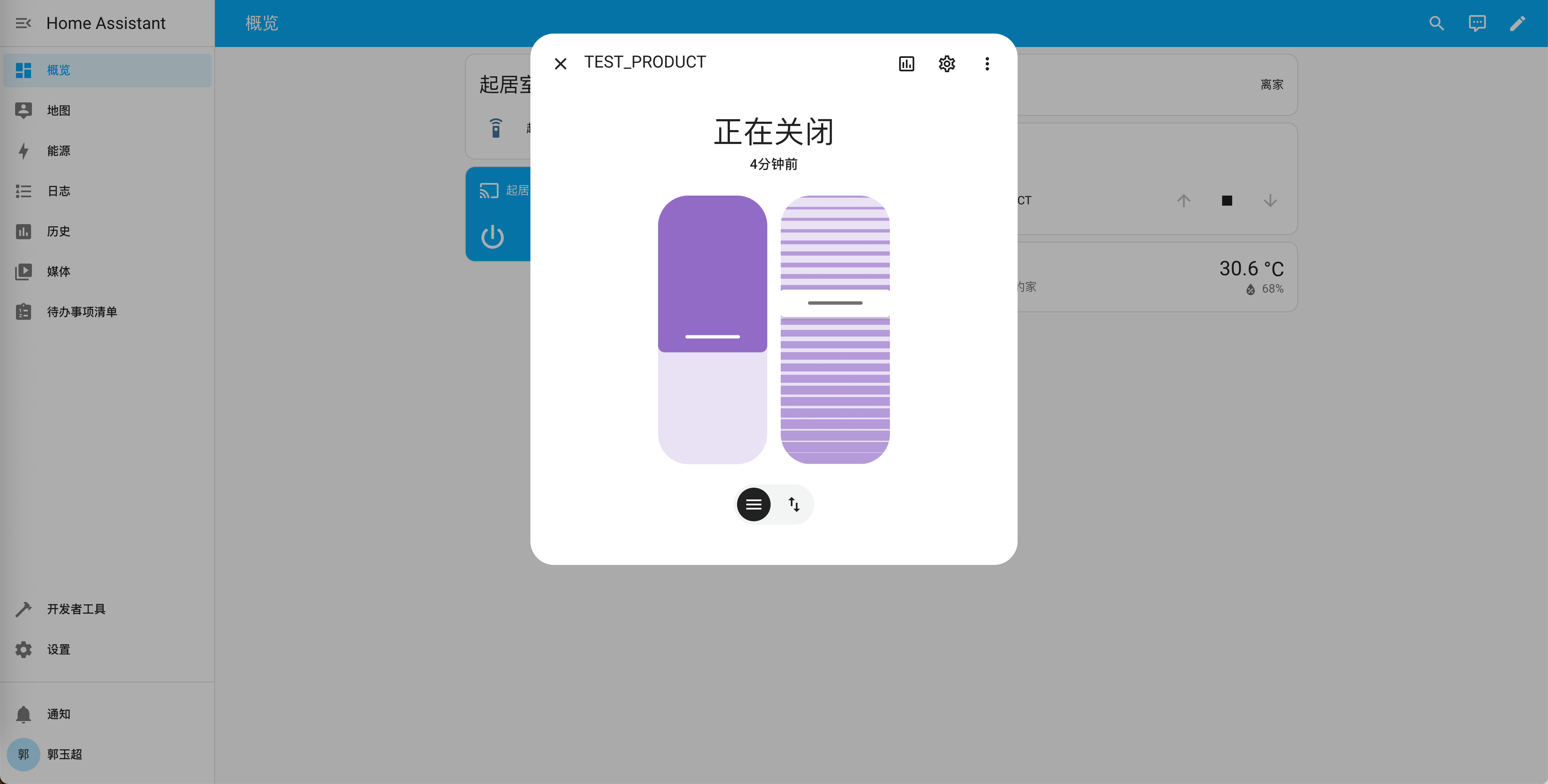

I tested adding to home assistant using the native matter curtain device and it really doesn't show the actual percentage. I'm guessing this is not a device side issue.

fangping.guo 2025年 Jul 21日 09:55I tested adding to home assistant using the native matter curtain device and it really doesn't show the actual percentage. I'm guessing this is not a device side issue.
As I mentioned here, even native Matter devices cannot display the percentage feature, so this is not an issue with TUYA or the bridge.
