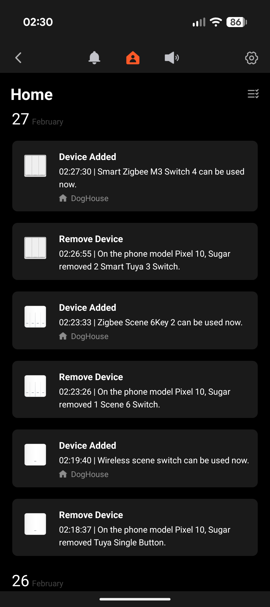

2:20 UK time zone - single button, readded to gateway plus single press, double press and long press, id: bf2995d1b34b65748ekioe
2:23 UK time zone - 6 switch button, readded to gateway plus single press, double press and long press, id: bf9805546bee09e64cxtos
2:27 UK time zone - 3 switch button, deadded to gateway plus single press, double press and long press, id: bf2215970e556cc6b4qqkp
Thanks.
