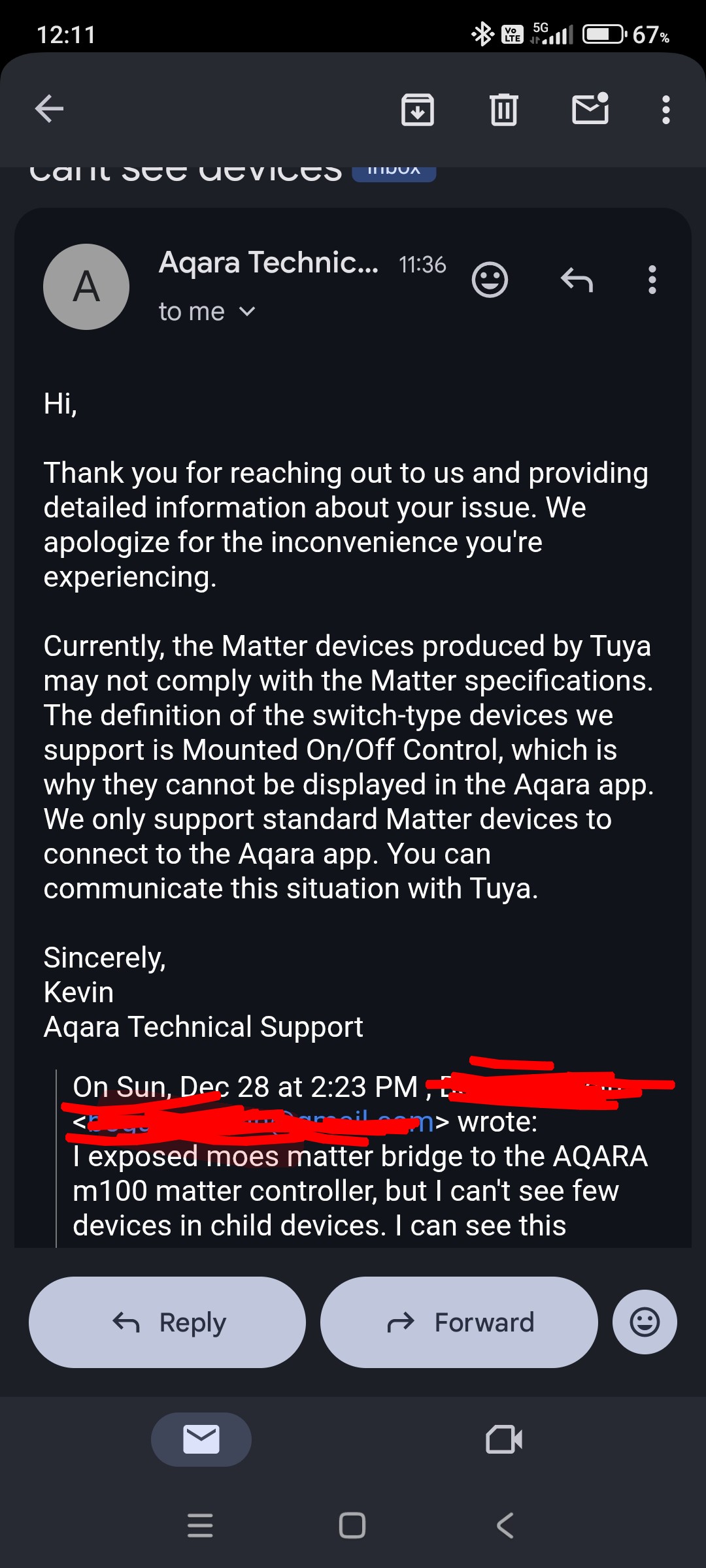

It' answer from AQARA support about relay and usb switch why it's not showing in their app.

In that case, we are currently unable to provide support because we need to ensure compatibility with lower versions of the Matter ecosystem. The "Mounted On/Off Control" device type mentioned by Aqara was introduced in Matter 1.5. We have verified support for various switch types—including On/Off Plug-in Unit, On/Off Light Switch, and Generic Switch—across ecosystems like Apple and Google.
