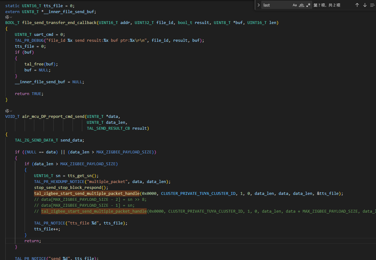

VOID_T air_mcu_DP_report_cmd_send(UINT8_T *data,
UINT8_T data_len,
TAL_SEND_RESULT_CB result)
TAL_ZG_SEND_DATA_T send_data;
if ((NULL == data) || (data_len > MAX_ZIGBEE_PAYLOAD_SIZE))
    if (data_len > MAX_ZIGBEE_PAYLOAD_SIZE)
        UINT16_T sn = tts_get_sn();
        TAL_PR_HEXDUMP_NOTICE("multiple_packet", data, data_len);
        //    stop_send_stop_block_respond();
        tal_zigbee_start_send_multiple_packet_handle(0x0000, CLUSTER_PRIVATE_TUYA_CLUSTER_ID, 1, 0, data_len, data, data_len, &tts_file);
        // data[MAX_ZIGBEE_PAYLOAD_SIZE - 2] = sn >> 8;
        // data[MAX_ZIGBEE_PAYLOAD_SIZE - 1] = sn;
        // tal_zigbee_start_send_multiple_packet_handle(0x0000, CLUSTER_PRIVATE_TUYA_CLUSTER_ID, 1, 0, data_len, data + MAX_ZIGBEE_PAYLOAD_SIZE, data_len - MAX_ZIGBEE_PAYLOAD_SIZE, &tts_file);
        TAL_PR_NOTICE("tts_file %d", tts_file);
        tts_file++;
    return;
TAL_PR_NOTICE("send %d", tts_file);
tal_system_memset(&send_data, 0, sizeof(TAL_ZG_SEND_DATA_T));
insert_private_command_send_buffer(SERIAL_PROTOCOL_DATA_REPORT, &send_data);
send_data.zcl_id = data[2];
//   (UINT8_T) ZCL_ID_DP_REPORT;
tal_system_memcpy(send_data.data.private.data, data, data_len);
send_data.data.private.len = data_len;
tal_zg_clear_send_data(ZG_CLEAR_ALL_ZCL_ID, &send_data.zcl_id);
if (NULL != result)
    tal_zg_send_data(&send_data, result, TAL_SEND_DATA_TIMEOUT);
else
    tal_zg_send_data(&send_data, NULL, TAL_SEND_DATA_TIMEOUT);

您好:
1.麻烦在tuya_init_first中增加tal_zigbee_local_auto_func_enable(); (需是router设备)
2.非router设备增加,router设备hulve:
BOOL_T __tal_inner_local_auto_action_device_enable(VOID_T)
return TRUE;
3.修改file_send_transfer_end_callback如下:
extern UINT8_T *__inner_file_send_buf;
BOOL_T file_send_transfer_end_callback(UINT16_T addr,UINT32_T file_id,bool_t result,UINT8_T *buf,UINT16_T len)
UINT8_T uart_cmd = 0;
TAL_PR_DEBUG("file_id %x send result:%x buf ptr:%x\r\n",file_id,result,buf);
if(buf){
    tal_free(buf);
    buf = NULL;
__inner_file_send_buf = NULL;
return TRUE;
4.每次发送前增加调用stop_send_stop_block_respond();
