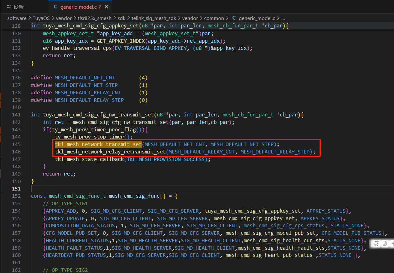

修改程序里的这个位置的参数吗?
怎么确定cnt 与 step修改的值是否合适?

修改程序里的这个位置的参数吗?
可以在配网成功后的回调函数中修改,参考如下
VOID_T tal_mesh_state_callback(TAL_MESH_NET_STATE_T state)
    tal_main_debug("mesh_state:%d", state);
    switch (state) {
        case TAL_MESH_PROVISION_SUCCESS:
            // Use to update mesh network transmit param, if developer don't know how to set, please don't change!
            tkl_mesh_network_transmit_set(7, 0);
            tkl_mesh_network_relay_retransmit_set(4, 0);
        break;
        default:
        break;
