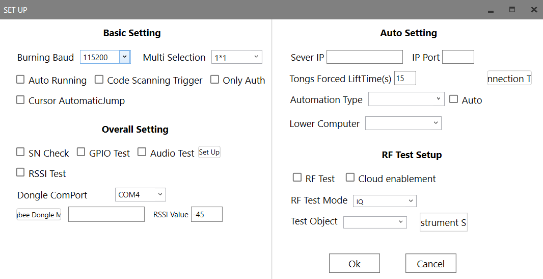

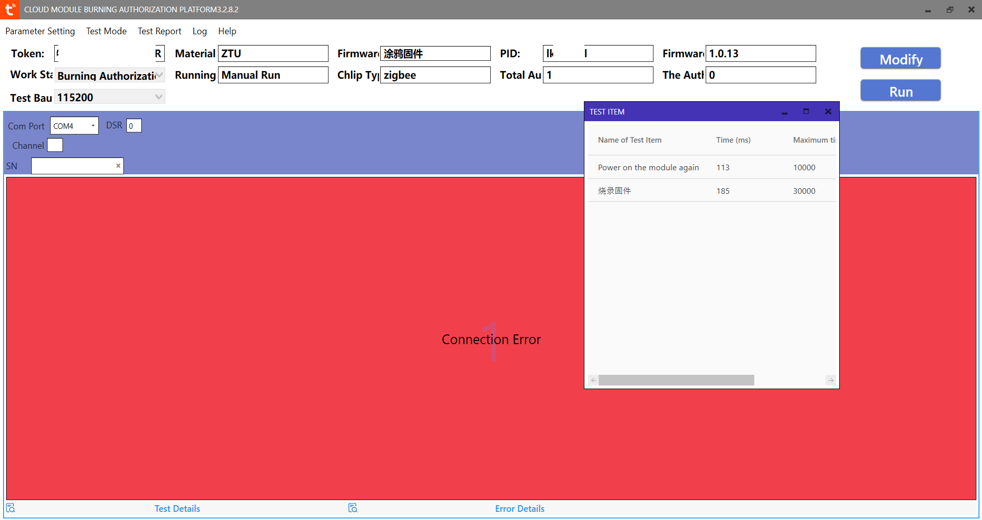

What I am stuck on now is the Module burning. As far as I understand I need to burn in the firmware for the DP to be recognized. Sadly I am not able to do so. My understanding is that the SOC should have the UART communication chip on it so it should be just a matter of having the driver installed which I have, having the pins correctly setup and running the Cloud Module Burning Authorization Platform tool with my token to burn the firmware with the appropriate DPs setup.
Sadly all I get is a "Connection Error". I even purchased an external UART chip and wired it with the same result, tried on two separate SOC boards to validate it is not a product issue but most likely something between the keyboard and chair.

  1. Hello, for the production test part, you can check the \TuyaOS\docs\2_产测说明.md 文档 document;
  2. ZT series module you need to use telink BDT burning tool for burning, please confirm whether you have it;
  3. Do you need burn authorization or do you just need to write the required pid to the module through the serial port? ;
