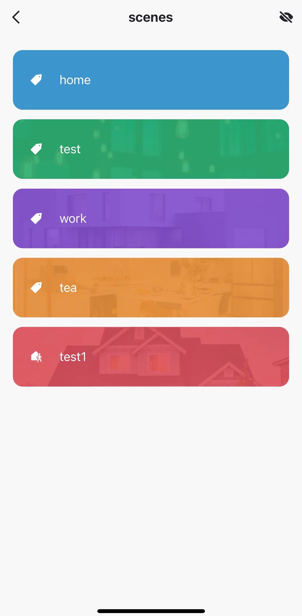

Tuya Central Control can manage devices and scenes in the home uniformly. The Central Control SDK can also hide devices and scenes, as well as restore them after hiding; additionally, the hidden status is consistent with the hide/show status of the central control panel in the app.
2. Usage Process
Based on the TuyaOS Central Control SDK, you can use the interface tuya_dev_display_list_get_all to obtain the current list of devices to be displayed and the list of devices to be hidden. Through tuya_dev_display_list_modify, you can inform the cloud of the list of devices to be hidden and the list of devices to be displayed.
For scenes, use the interface tuya_scene_all_info_list_get to obtain the current list of scenes to be displayed and the list of scenes to be hidden. Through tuya_scene_display_list_modify, you can inform the cloud of the list of scenes to be hidden and the list of scenes to be displayed.
