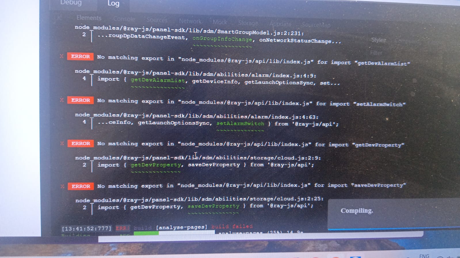

  • Log information:
  • Problem description (reproduction steps):
    • Install the package @ray-js/components-ty-slider@1.10.7.
    • Create a component using the code from above and start the project.
  • expected outcome:
    Circle Slider to appear on the Page
  • actual results:
    The App doesn't start and has error logs

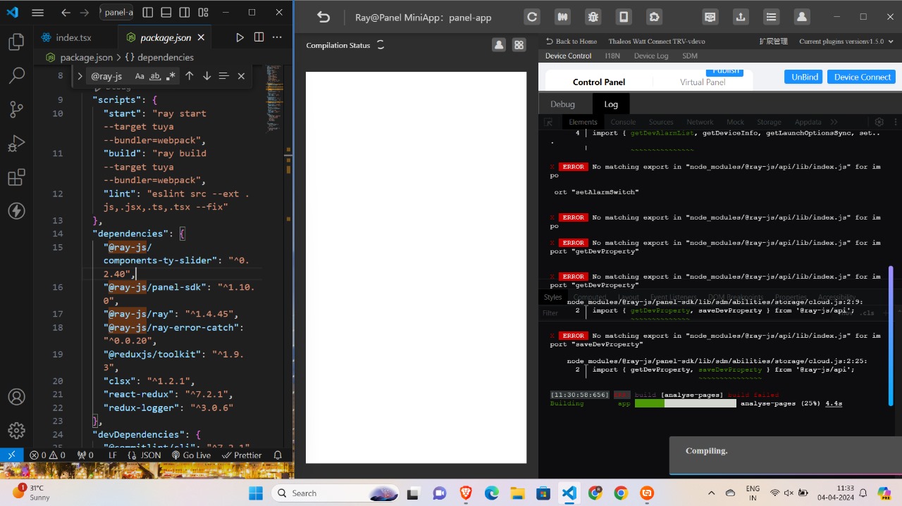

Mywatt Dev
Posts: 7
Re: Issue when using Tuya Slider Component
I have installed the recommended version and I still see the error same error.
Muzzzhi
Posts: 86
Mywatt Dev 2024年 Apr 4日 14:20
I tried using your dependency but found no problem.
:!: It seems that a lock is being placed on an incompatible version. Try deleting the lock file and re-installing the yarn dependency. If there are still problems, post git repository or you can send out the lock file.
Mywatt Dev
Posts: 7
I have attached the package-lock.json.
package-lock.json.txt
(2.22 MiB) Downloaded 522 times
Muzzzhi
Posts: 86
Mywatt Dev 2024年 Apr 5日 23:53
Oh, look at the lock file because of the sub-dependency problem of @ray-js/panel-sdk, you can first use 'npm install --legacy-peer-deps' or' yarn 'to install the dependency, we will update @ray-js/panel-sdk.
Muzzzhi
Posts: 86
Muzzzhi 2024年 Apr 7日 11:13
We upgraded @ray-js/panel-sdk, using version 1.10.2 to confirm.
