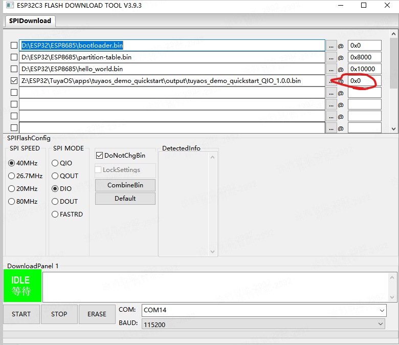

I uses TuyaOS Development ESP32C3_TuyaOS-3.6.5
Linux Mint 22, python3.8, cmake 3.28.3
after compile tuyaos_demo_quickstart and download tuyaos_demo_quickstart_QIO_1.0.1.bin the module just print startup message.
it will not continue to run and will not enter the tuya_app_main() function.
The log is.

Hi Hashim,
It looks like the partition table incorrect, the partition table of Tuya's as follows(vendor\esp32\tuyaos\partitions.csv):
Name, Type, SubType, Offset, Size
nvs, data, nvs, 0x9000, 0x4000
otadata, data, ota, 0xd000, 0x2000
phy_init, data, phy, 0xf000, 0x1000
ota_0,0, ota_0, 0x10000, 0x180000
ota_1,0, ota_1, 0x190000, 0x180000
tuya, data, 0xAA, 0x3b0000, 0x28000
factory_nvs, data, nvs, 0x3e0000, 0x4000
What's the offset address use for download tuyaos_demo_quickstart_QIO_1.0.1.bin?
You can try to download it like that:
Thanks,

I have set the offset address of tuyaos_demo_quickstart_QIO_1.0.1.bin to 0x0, same problem.
