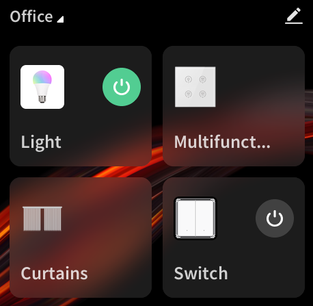

I. Basic Introduction
The Central Control SDK provides interfaces to obtain a list of devices under the home that comply with standard commands and to control the devices.
