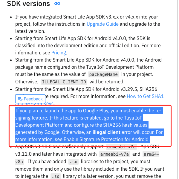

I understand the reason for the issue now. It is due to the fact that when you publish your app on Google Play, Google Play will re-sign your app. You need to fill in the re-signed SHA256 back into the Tuya IoT platform.
Certainly, here's a draft translation based on the provided document:https://developer.tuya.com/en/docs/iot/ ... gle%20Play

Hello, you can double check whether it is caused by Google re-signing the signature file of the listed APP. A year ago, I wrote a similar post, sorry that it is only in Chinese at the moment.
viewtopic.php?t=46
Re: Google App Review Team can't login
Posted: 2023年 Nov 22日 19:38
by taoyuanxiaoqi
If it is the problem I am talking about, the typical phenomenon is that our local development and installation package is normal, but there will be problems when it is put on Google Play. The reason is that Google re-signing was turned on and the SHA256 value of Google's new signature file was not updated back to the Tuya platform. You can refer to the tips in this document:https://developer.tuya.com/en/docs/app- ... 20versions
