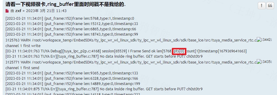

【已解决】【SDK】请看一下视频很卡,ring_buffer里面时间戳不是我给的.
zxf
Posts: 20
[2023-03-21 11:34:01] (put_frame:152)frame len:5768,type:1,timestamp:0
[2023-03-21 11:34:01] (put_frame:152)frame len:15312,type:0,timestamp:33
[2023-03-21 11:34:01] (put_frame:152)frame len:6865,type:0,timestamp:66
[2023-03-21 11:34:01] (put_frame:152)frame len:18743,type:0,timestamp:99
3125763 WARN /root/workspace_temp/EmbedSDKs/ty_ipc_wr_wl_linux_sdk/ty_ipc_wr_wl_linux_sdk/sdk/base_ice/src/tuya_media_service_rtc.c:3442: channel 1 first write
[03-21 11:34:01:763 TUYA Debug][tuya_ipc_p2p.c:4168] session[65539] I Frame Send ok len[5768] pts[0] count[1]timestamp[1679369641663]
[03-21 11:34:01:763 TUYA Err][tuya_ring_buffer.c:787] No data inside ring buffer. GET starts before PUT? ch0st0tr9
3125771 WARN /root/workspace_temp/EmbedSDKs/ty_ipc_wr_wl_linux_sdk/ty_ipc_wr_wl_linux_sdk/sdk/base_ice/src/tuya_media_service_rtc.c:3435: channel 1 first send
[2023-03-21 11:34:01] (put_frame:152)frame len:9365,type:0,timestamp:133
[2023-03-21 11:34:01] (put_frame:152)frame len:6328,type:0,timestamp:166
[2023-03-21 11:34:01] (put_frame:152)frame len:14889,type:0,timestamp:199
[03-21 11:34:01:875 TUYA Err][tuya_ring_buffer.c:787] No data inside ring buffer. GET starts before PUT? ch0st0tr9
[2023-03-21 11:34:01] (put_frame:152)frame len:14118,type:0,timestamp:233
3125901 WARN /root/workspace_temp/EmbedSDKs/ty_ipc_wr_wl_linux_sdk/ty_ipc_wr_wl_linux_sdk/sdk/base_ice/src/tuya_media_service_rtc.c:3461: channel 1 get first data
[2023-03-21 11:34:01] (put_frame:152)frame len:7484,type:0,timestamp:266
[2023-03-21 11:34:01] (put_frame:152)frame len:5344,type:0,timestamp:299
[03-21 11:34:01:986 TUYA Err][tuya_ring_buffer.c:787] No data inside ring buffer. GET starts before PUT? ch0st0tr9
[2023-03-21 11:34:01] (put_frame:152)frame len:8192,type:0,timestamp:333
[2023-03-21 11:34:01] (put_frame:152)frame len:3271,type:0,timestamp:366
[2023-03-21 11:34:01] (put_frame:152)frame len:2149,type:0,timestamp:399
[2023-03-21 11:34:01] (put_frame:152)frame len:5175,type:0,timestamp:433
[03-21 11:34:02:97 TUYA Err][tuya_ring_buffer.c:787] No data inside ring buffer. GET starts before PUT? ch0st0tr9

pippin-bobo
Posts: 262
Re: 请看一下视频很卡,ring_buffer里面时间戳不是我给的.
1.请按照 “【必看】多媒体论坛技术问题指导”,方便技术沟通
2.常供电设备,数据塞入ringbuffer之前请先使用涂鸦获取时间接口,同步云端时间;低功耗产品需要维护一下启动自己维护下时间
fallen-queen
Posts: 145
1.往ring buffer塞视频帧时,没有给pts,pts需要微秒为单位的时间戳。

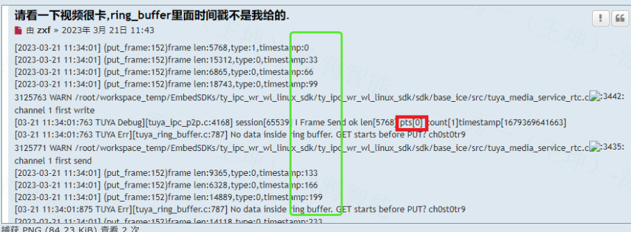

zxf
Posts: 20
fallen-queen 2023年 Mar 21日 11:54
附件中框出来就是给ring_buffer的时间戳
zxf
Posts: 20
zxf 2023年 Mar 21日 12:04
回头试一下以微妙为单位播放
zxf
Posts: 20
时间戳改成微秒,问题还是一样,ring_buffer并不是我给的时间戳

[2023-03-21 14:00:25] (put_frame:153)frame len:6489,type:0,timestamp:8331000
[03-21 14:00:27:155 TUYA Err][tuya_ring_buffer.c:787] No data inside ring buffer. GET starts before PUT? ch0st0tr9
[2023-03-21 14:00:25] (put_frame:153)frame len:8107,type:0,timestamp:8364000
[2023-03-21 14:00:25] (put_frame:153)frame len:6628,type:0,timestamp:8397000
[2023-03-21 14:00:25] (put_frame:153)frame len:8113,type:0,timestamp:8430000
[2023-03-21 14:00:25] (put_frame:153)frame len:6459,type:0,timestamp:8464000
[03-21 14:00:27:265 TUYA Debug][tuya_ring_buffer.c:229] ch0st0tr0 delay too much:1836886025-1836708250<196608
[03-21 14:00:27:265 TUYA Debug][tuya_ring_buffer.c:903] skip to next frame, type(1) node 136 seqNo 136 ch0st0tr0
[03-21 14:00:27:266 TUYA Err][tuya_ring_buffer.c:787] No data inside ring buffer. GET starts before PUT? ch0st0tr9
[2023-03-21 14:00:25] (put_frame:153)frame len:24072,type:1,timestamp:8497000
[2023-03-21 14:00:26] (put_frame:153)frame len:7269,type:0,timestamp:8530000
[2023-03-21 14:00:26] (put_frame:153)frame len:8457,type:0,timestamp:8563000
[03-21 14:00:27:376 TUYA Err][tuya_ring_buffer.c:787] No data inside ring buffer. GET starts before PUT? ch0st0tr9
[2023-03-21 14:00:26] (put_frame:153)frame len:8261,type:0,timestamp:8597000
[2023-03-21 14:00:26] (put_frame:153)frame len:8132,type:0,timestamp:8630000
[2023-03-21 14:00:26] (put_frame:153)frame len:7993,type:0,timestamp:8663000
[03-21 14:00:27:487 TUYA Err][tuya_ring_buffer.c:787] No data inside ring buffer. GET starts before PUT? ch0st0tr9
[2023-03-21 14:00:26] (put_frame:153)frame len:7944,type:0,timestamp:8697000
[2023-03-21 14:00:26] (put_frame:153)frame len:8049,type:0,timestamp:8730000
[2023-03-21 14:00:26] (put_frame:153)frame len:7988,type:0,timestamp:8763000
[2023-03-21 14:00:26] (put_frame:153)frame len:6515,type:0,timestamp:8797000
[03-21 14:00:27:598 TUYA Err][tuya_ring_buffer.c:787] No data inside ring buffer. GET starts before PUT? ch0st0tr9
[2023-03-21 14:00:26] (put_frame:153)frame len:7956,type:0,timestamp:8830000
[2023-03-21 14:00:26] (put_frame:153)frame len:6544,type:0,timestamp:8863000
[2023-03-21 14:00:26] (put_frame:153)frame len:7985,type:0,timestamp:8897000
[03-21 14:00:27:709 TUYA Debug][tuya_ring_buffer.c:229] ch0st0tr0 delay too much:1837009608-1836825415<196608
[03-21 14:00:27:709 TUYA Debug][tuya_ring_buffer.c:903] skip to next frame, type(1) node 1 seqNo 151 ch0st0tr0
[03-21 14:00:27:710 TUYA Err][tuya_ring_buffer.c:787] No data inside ring buffer. GET starts before PUT? ch0st0tr9
[2023-03-21 14:00:26] (put_frame:153)frame len:6486,type:0,timestamp:8930000
[2023-03-21 14:00:26] (put_frame:153)frame len:8006,type:0,timestamp:8963000
[2023-03-21 14:00:26] (put_frame:153)frame len:23928,type:1,timestamp:8997000
[03-21 14:00:27:821 TUYA Err][tuya_ring_buffer.c:787] No data inside ring buffer. GET starts before PUT? ch0st0tr9
[2023-03-21 14:00:26] (put_frame:153)frame len:7146,type:0,timestamp:9030000
[2023-03-21 14:00:26] (put_frame:153)frame len:8382,type:0,timestamp:9063000
[2023-03-21 14:00:26] (put_frame:153)frame len:8175,type:0,timestamp:9097000
[2023-03-21 14:00:26] (put_frame:153)frame len:8021,type:0,timestamp:9130000
[03-21 14:00:27:932 TUYA Err][tuya_ring_buffer.c:787] No data inside ring buffer. GET starts before PUT? ch0st0tr9
[2023-03-21 14:00:26] (put_frame:153)frame len:8335,type:0,timestamp:9163000
[2023-03-21 14:00:26] (put_frame:153)frame len:8059,type:0,timestamp:9197000
[2023-03-21 14:00:26] (put_frame:153)frame len:7949,type:0,timestamp:9230000
[03-21 14:00:28:42 TUYA Debug][tuya_ring_buffer.c:245] ch0st0tr0 delay too much:1835790352 1837101072 1835821294 1836919902
[03-21 14:00:28:42 TUYA Debug][tuya_ring_buffer.c:245] ch0st0tr0 delay too much:1835790352 1837101072 1835921626 1836919902
[03-21 14:00:28:42 TUYA Debug][tuya_ring_buffer.c:903] skip to next frame, type(1) node 31 seqNo 181 ch0st0tr0
[03-21 14:00:28:43 TUYA Err][tuya_ring_buffer.c:787] No data inside ring buffer. GET starts before PUT? ch0st0tr9
[2023-03-21 14:00:26] (put_frame:153)frame len:7901,type:0,timestamp:9263000
[2023-03-21 14:00:26] (put_frame:153)frame len:6455,type:0,timestamp:9297000
[2023-03-21 14:00:26] (put_frame:153)frame len:7987,type:0,timestamp:9330000
[03-21 14:00:28:154 TUYA Err][tuya_ring_buffer.c:787] No data inside ring buffer. GET starts before PUT? ch0st0tr9
[2023-03-21 14:00:26] (put_frame:153)frame len:6465,type:0,timestamp:9363000
[2023-03-21 14:00:26] (put_frame:153)frame len:8015,type:0,timestamp:9396000
[2023-03-21 14:00:26] (put_frame:153)frame len:6508,type:0,timestamp:9430000
[2023-03-21 14:00:26] (put_frame:153)frame len:8017,type:0,timestamp:9463000
[03-21 14:00:28:265 TUYA Err][tuya_ring_buffer.c:787] No data inside ring buffer. GET starts before PUT? ch0st0tr9
[2023-03-21 14:00:26] (put_frame:153)frame len:24097,type:1,timestamp:9496000
[2023-03-21 14:00:27] (put_frame:153)frame len:7124,type:0,timestamp:9530000
[2023-03-21 14:00:27] (put_frame:153)frame len:8283,type:0,timestamp:9563000
[03-21 14:00:28:376 TUYA Err][tuya_ring_buffer.c:787] No data inside ring buffer. GET starts before PUT? ch0st0tr9
[2023-03-21 14:00:27] (put_frame:153)frame len:8112,type:0,timestamp:9596000
[2023-03-21 14:00:27] (put_frame:153)frame len:7998,type:0,timestamp:9630000
[2023-03-21 14:00:27] (put_frame:153)frame len:7920,type:0,timestamp:9663000
[03-21 14:00:28:487 TUYA Err][tuya_ring_buffer.c:787] No data inside ring buffer. GET starts before PUT? ch0st0tr9
[2023-03-21 14:00:27] (put_frame:153)frame len:7830,type:0,timestamp:9696000
[2023-03-21 14:00:27] (put_frame:153)frame len:7903,type:0,timestamp:9731000
[2023-03-21 14:00:27] (put_frame:153)frame len:7848,type:0,timestamp:9763000
[2023-03-21 14:00:27] (put_frame:153)frame len:7890,type:0,timestamp:9796000
[03-21 14:00:28:598 TUYA Err][tuya_ring_buffer.c:787] No data inside ring buffer. GET starts before PUT? ch0st0tr9
[2023-03-21 14:00:27] (put_frame:153)frame len:6434,type:0,timestamp:9830000
[2023-03-21 14:00:27] (put_frame:153)frame len:7947,type:0,timestamp:9863000
[2023-03-21 14:00:27] (put_frame:153)frame len:6509,type:0,timestamp:9896000
[03-21 14:00:28:709 TUYA Err][tuya_ring_buffer.c:787] No data inside ring buffer. GET starts before PUT? ch0st0tr9
[2023-03-21 14:00:27] (put_frame:153)frame len:7951,type:0,timestamp:9930000
[2023-03-21 14:00:27] (put_frame:153)frame len:6401,type:0,timestamp:9963000
[2023-03-21 14:00:27] (put_frame:153)frame len:24213,type:1,timestamp:9996000
[03-21 14:00:28:819 TUYA Err][tuya_ring_buffer.c:787] No data inside ring buffer. GET starts before PUT? ch0st0tr9
[2023-03-21 14:00:27] (put_frame:153)frame len:7154,type:0,timestamp:10030000
[2023-03-21 14:00:27] (put_frame:153)frame len:8193,type:0,timestamp:10063000
[2023-03-21 14:00:27] (put_frame:153)frame len:8113,type:0,timestamp:10096000
[2023-03-21 14:00:27] (put_frame:153)frame len:8084,type:0,timestamp:10130000
[03-21 14:00:28:930 TUYA Err][tuya_ring_buffer.c:787] No data inside ring buffer. GET starts before PUT? ch0st0tr9
[2023-03-21 14:00:27] (put_frame:153)frame len:8021,type:0,timestamp:10163000
[2023-03-21 14:00:27] (put_frame:153)frame len:7902,type:0,timestamp:10196000
[2023-03-21 14:00:27] (put_frame:153)frame len:7937,type:0,timestamp:10229000
[03-21 14:00:29:41 TUYA Err][tuya_ring_buffer.c:787] No data inside ring buffer. GET starts before PUT? ch0st0tr9
[2023-03-21 14:00:27] (put_frame:153)frame len:7888,type:0,timestamp:10263000
[2023-03-21 14:00:27] (put_frame:153)frame len:7967,type:0,timestamp:10296000
[2023-03-21 14:00:27] (put_frame:153)frame len:6497,type:0,timestamp:10329000
[03-21 14:00:29:133 TUYA Debug][tuya_ipc_p2p.c:5030] session[65537] detech staticCnt[2]lstCnt[6]vIFrameCnt[6]
[03-21 14:00:29:133 TUYA Debug][tuya_ipc_p2p.c:5030] session[65538] detech staticCnt[0]lstCnt[12]vIFrameCnt[12]
[03-21 14:00:29:152 TUYA Err][tuya_ring_buffer.c:787] No data inside ring buffer. GET starts before PUT? ch0st0tr9
[2023-03-21 14:00:27] (put_frame:153)frame len:7979,type:0,timestamp:10363000
[2023-03-21 14:00:27] (put_frame:153)frame len:6648,type:0,timestamp:10396000
[2023-03-21 14:00:27] (put_frame:153)frame len:8110,type:0,timestamp:10429000
[2023-03-21 14:00:27] (put_frame:153)frame len:6578,type:0,timestamp:10463000
[03-21 14:00:29:262 TUYA Err][tuya_ring_buffer.c:787] No data inside ring buffer. GET starts before PUT? ch0st0tr9
[2023-03-21 14:00:27] (put_frame:153)frame len:23849,type:1,timestamp:10496000
[2023-03-21 14:00:27] (put_frame:153)frame len:7117,type:0,timestamp:10529000
[2023-03-21 14:00:28] (put_frame:153)frame len:8257,type:0,timestamp:10563000
[03-21 14:00:29:373 TUYA Debug][tuya_ring_buffer.c:229] ch0st0tr0 delay too much:1836153500-1835967260<196608
[03-21 14:00:29:373 TUYA Debug][tuya_ring_buffer.c:903] skip to next frame, type(1) node 46 seqNo 196 ch0st0tr0
[03-21 14:00:29:374 TUYA Err][tuya_ring_buffer.c:787] No data inside ring buffer. GET starts before PUT? ch0st0tr9
[2023-03-21 14:00:28] (put_frame:153)frame len:8112,type:0,timestamp:10596000
[2023-03-21 14:00:28] (put_frame:153)frame len:7977,type:0,timestamp:10629000
[2023-03-21 14:00:28] (put_frame:153)frame len:7978,type:0,timestamp:10663000
[03-21 14:00:29:485 TUYA Debug][tuya_ring_buffer.c:229] ch0st0tr0 delay too much:1836183948-1835991327<196608
[03-21 14:00:29:485 TUYA Debug][tuya_ring_buffer.c:903] skip to next frame, type(1) node 61 seqNo 211 ch0st0tr0
[03-21 14:00:29:486 TUYA Err][tuya_ring_buffer.c:787] No data inside ring buffer. GET starts before PUT? ch0st0tr9

1.看上去有点像网络卡顿引起,日志麻烦以txt格式,放在附件中,方便我们这边进一步排查

好的,但是网络是单独,我们推到其他服务器是正常播放的,日志选项如何查看ring_buffer是不是我发送的时间戳?

日志改成TRACE级别,ring buffer会有打印

麻烦看一下,开了trace日志,ring_buffer是我给的时间戳,但是播放卡顿
