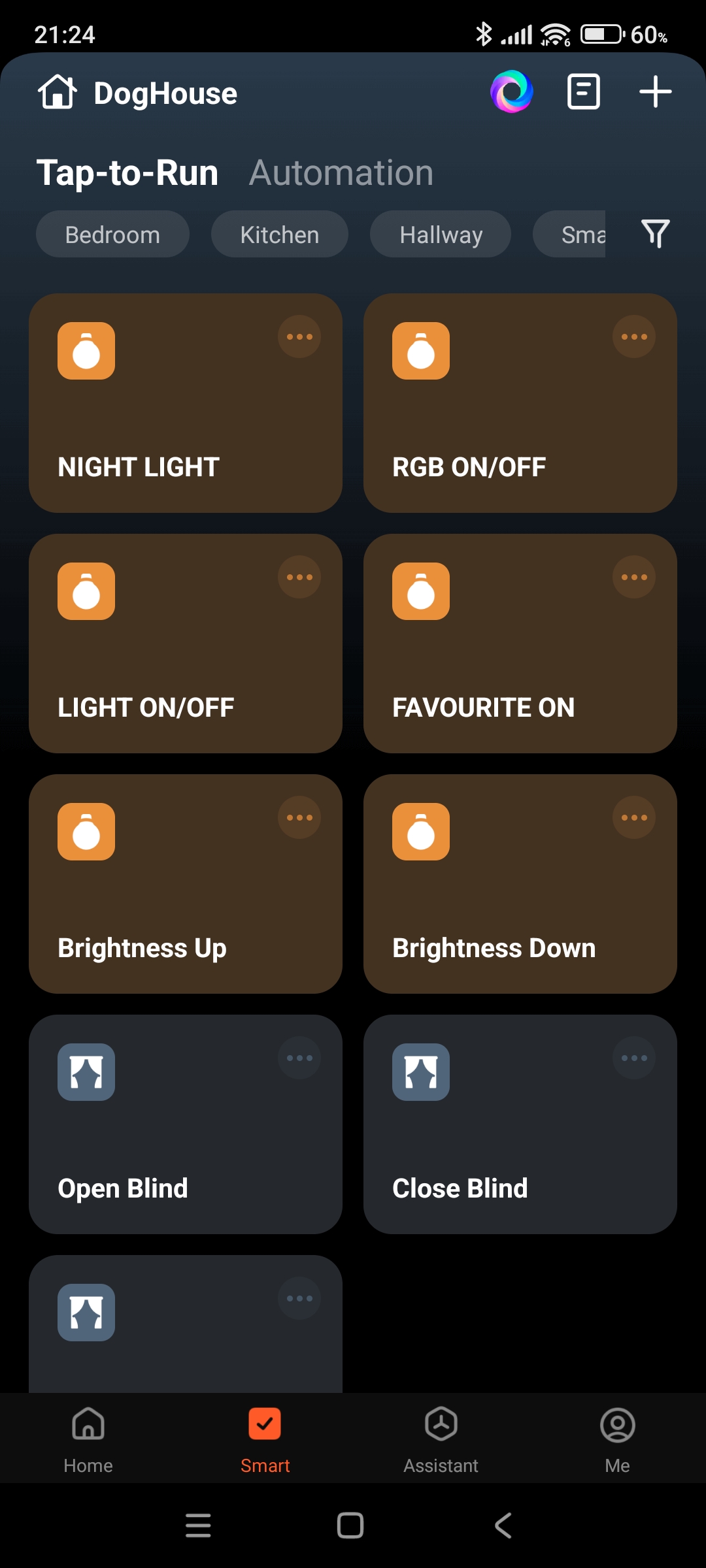

Tap to run actions
Sugar
Posts: 77
How is tap to run exposed in matter protocol? What type of device.
I noticed that they are showing in google with matter integration, but not in aqara.
Thank you for any answer :)
