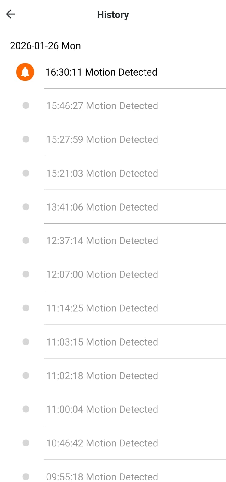

Hollako
Posts: 21
Re: 2 Buttons Keypad shows as 6 Buttons on HA via Matter
Hello,
I am not sure if the attached is the needed logs. However i was comparing between the Door contact which are working normally with HA and the Motion sensor, i found that the clusters are same for both items Door Contact and Motion Detectors. i have a doubt maybe it's a problem from between Home Assistant and the Matter Add-on in HAOS.
