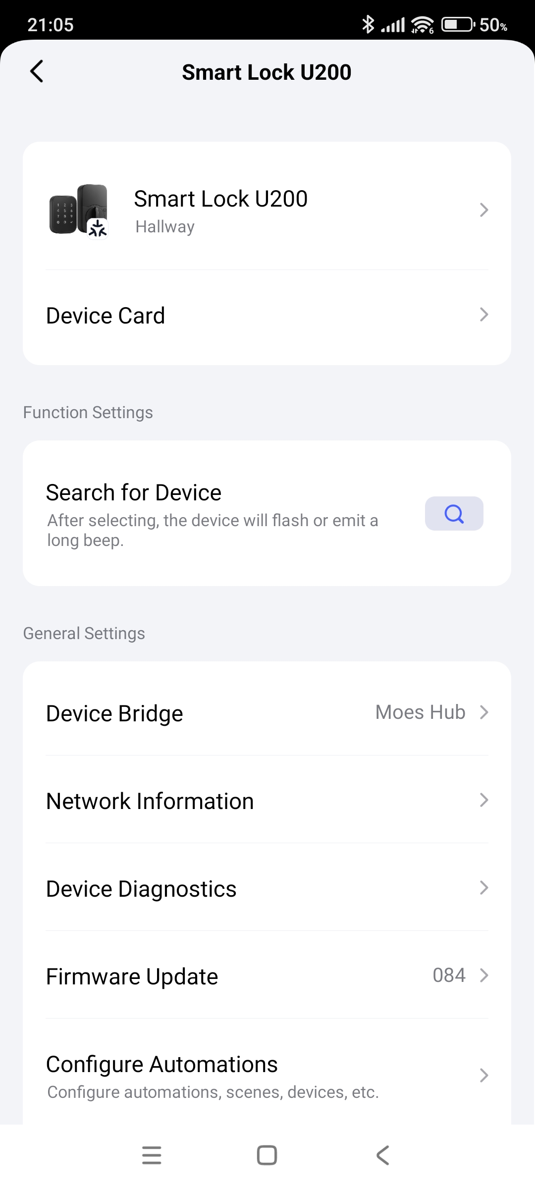

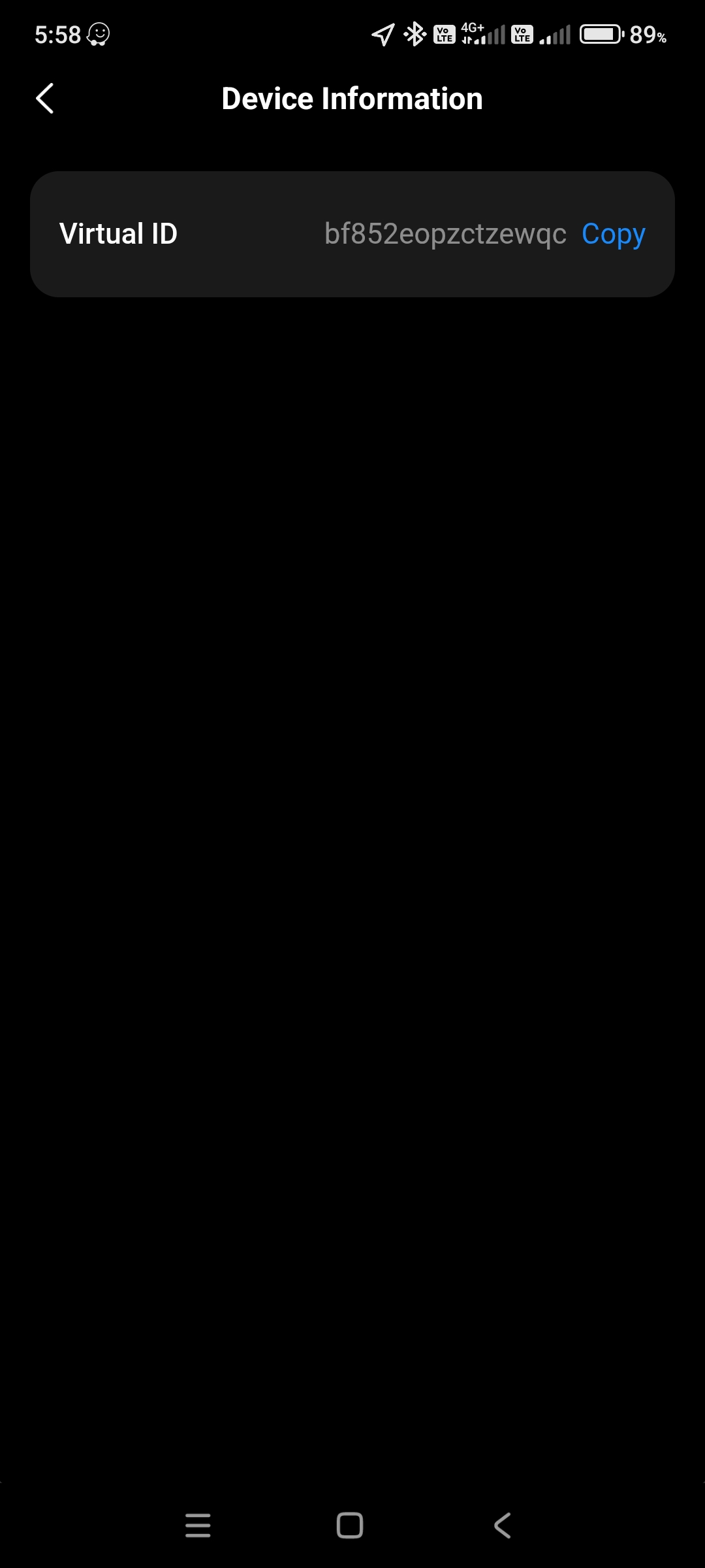

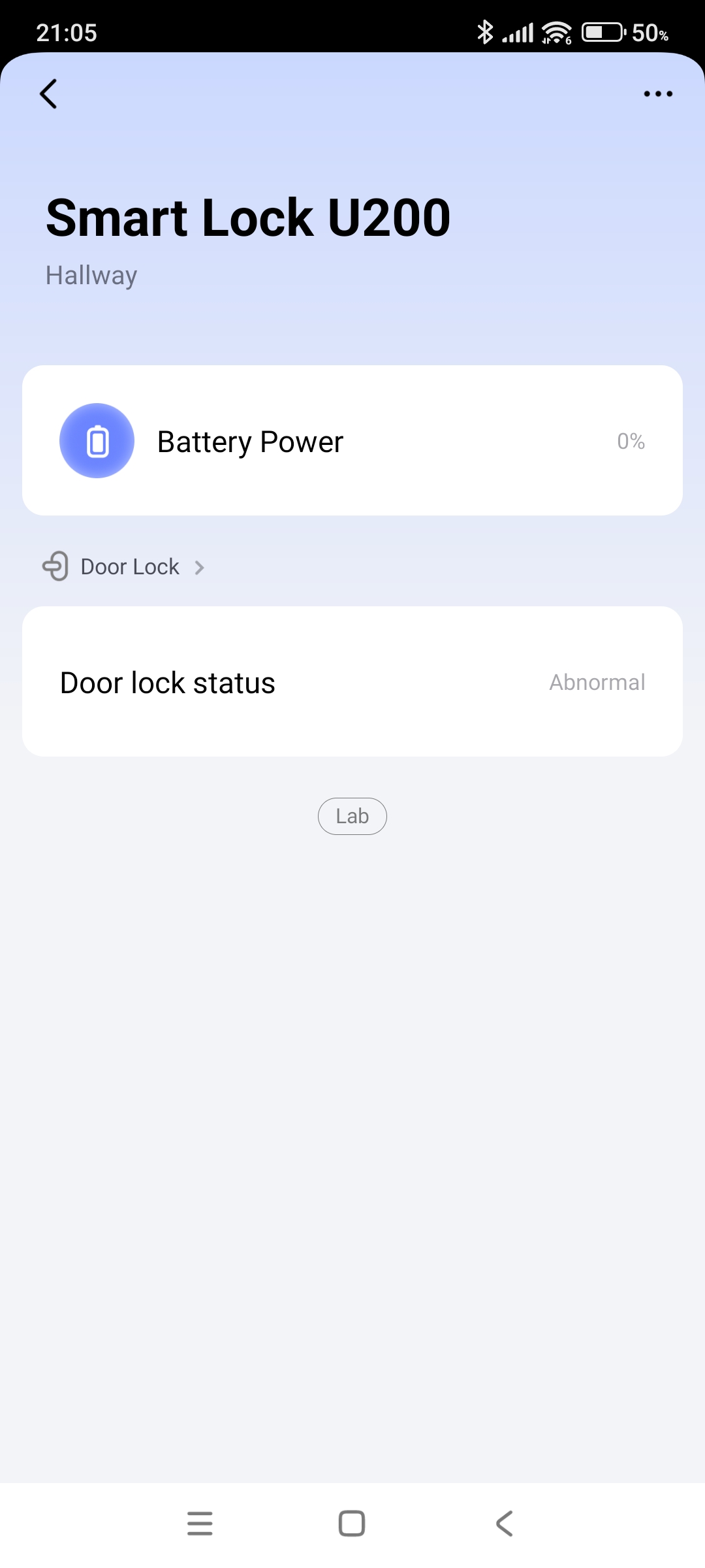

Virtual ID of the lock: bf852eopzctzewqc
Virtual ID of the Moe's Hub: bfdd385cadc34fdb76jlx7
Battery status is all the time 0 percent, and door lock status is abnormal, plus you can't open it or close it.

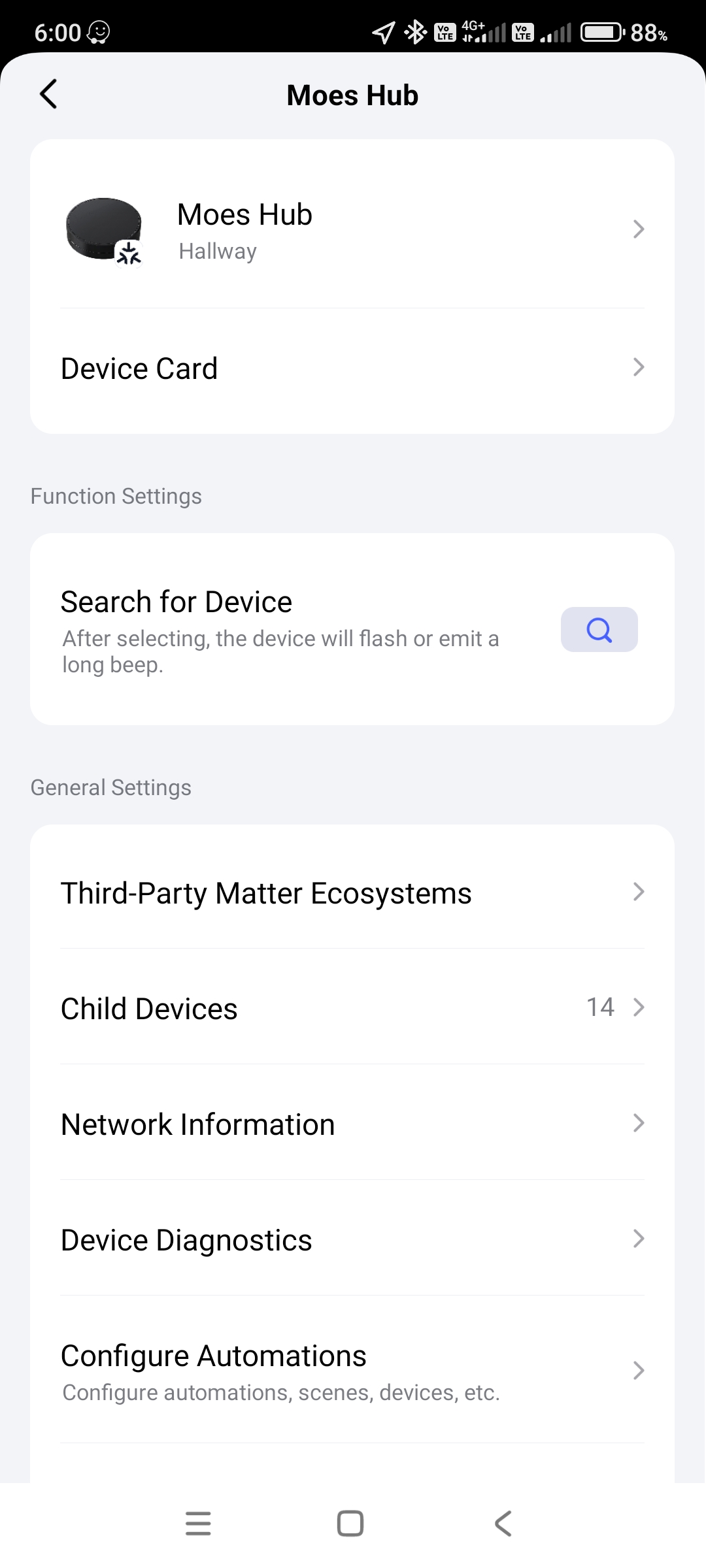

This lock is connected to the Moes hub by the thread network, and then I shared it to the Aqara Matter controller.
Thank you if it can be fixed :)

Update:
Battery status and door lock status is correct now, but it's still not possible to open or close the lock.

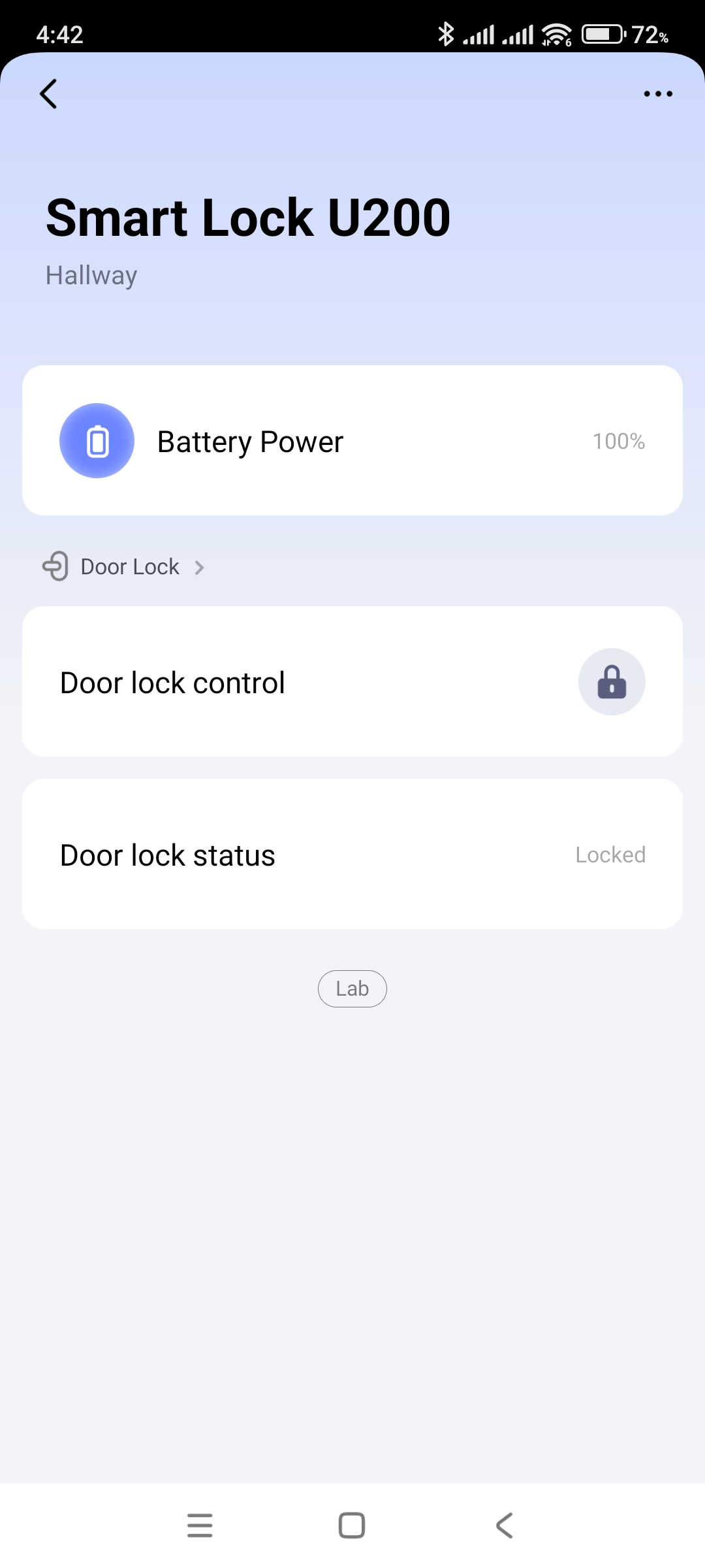

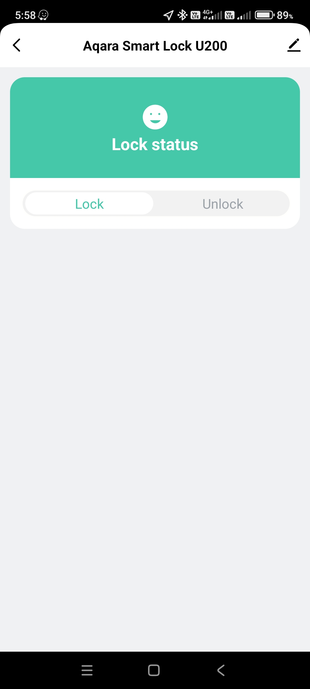

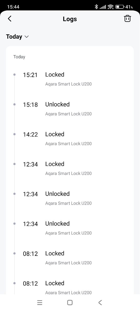

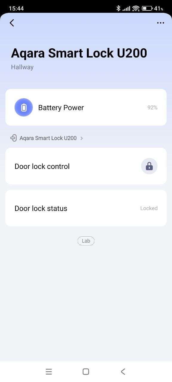

Anyway, with the next firmware, Tuya could improve the lock layout in their own app. If the Matter Bridge is exposing LOGS, BATTERY STATUS, DOOR LOCK STATUS and DOOR LOCK CONTROL, then I don't see a reason why dont add it to tuya app as well.
They could add it for 3rd-party matter, and matter over thread locks in their own app.
Just copy the layout from aqara app to the Tuya app.
Aqara app layout:

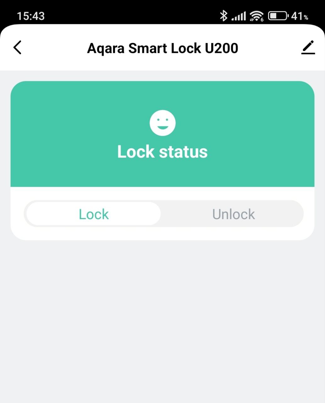

Tuya app layout, you can only control opening and closing the lock:
Thanks.
