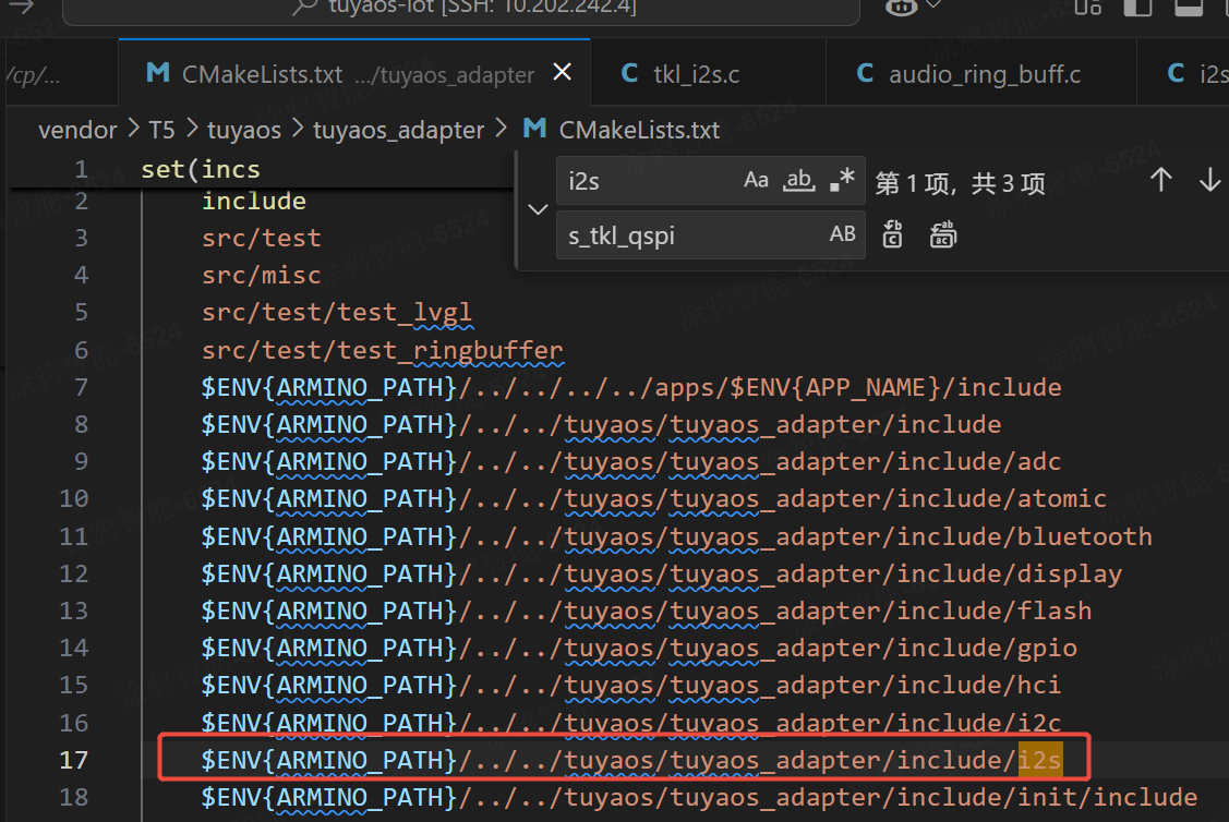

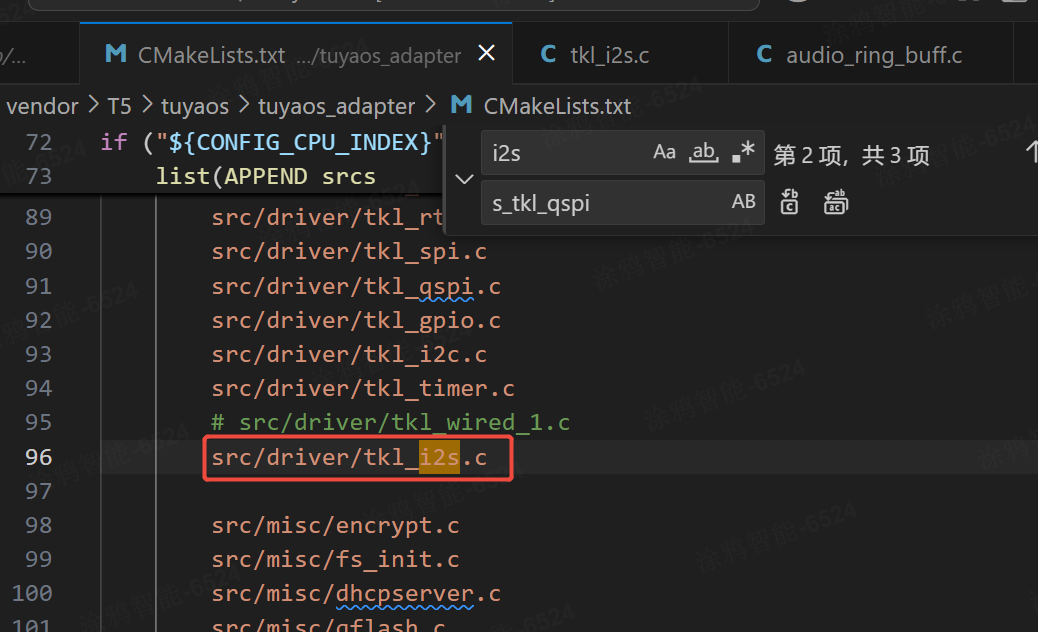

请将代码放至tkl驱动适配层vendor/T5/tuyaos/tuyaos_adapter/src/driver/tkl_i2s.c vendor/T5/tuyaos/tuyaos_adapter/include/i2s/tkl_i2s.h下进行使用,并修改vendor/T5/tuyaos/tuyaos_adapter/CMakeLists.txt文件,如附图17531772406217.png、17531772232866.png所示
添加对应文件编译路径

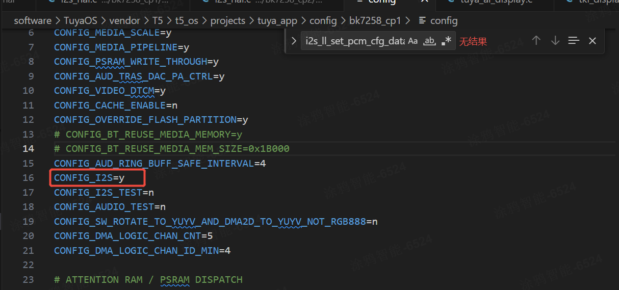

1.请问是否合入0001-i2s.zip中的patch后clean再编译?
2.需要在config文件中打开i2s宏,CONFIG_I2S=y

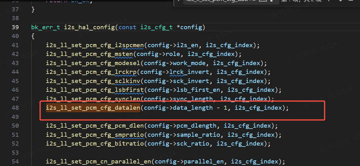

您好,请替换掉附件中最新tkl_i2s相关文件
software/TuyaOS/vendor/T5/tuyaos/tuyaos_adapter/src中存放tkl_i2s.c
software/TuyaOS/vendor/T5/tuyaos/tuyaos_adapter/include/i2s存放tkl_i2s.h,若无此文件夹请创建
确认software/TuyaOS/vendor/T5/t5_os/bk_idk/middleware/soc/bk7258_cp1/hal/i2s_hal.c、
software/TuyaOS/vendor/T5/t5_os/bk_idk/middleware/soc/bk7258/hal/i2s_hal.c 文件中对应代码是否如附图i2s_hal.c.png所示
config路径位于software/TuyaOS/vendor/T5/t5_os/projects/tuya_app/config/bk7258/config 、software/TuyaOS/vendor/T5/t5_os/projects/tuya_app/config/bk7258_cp1/config 两个路径中文件均需修改

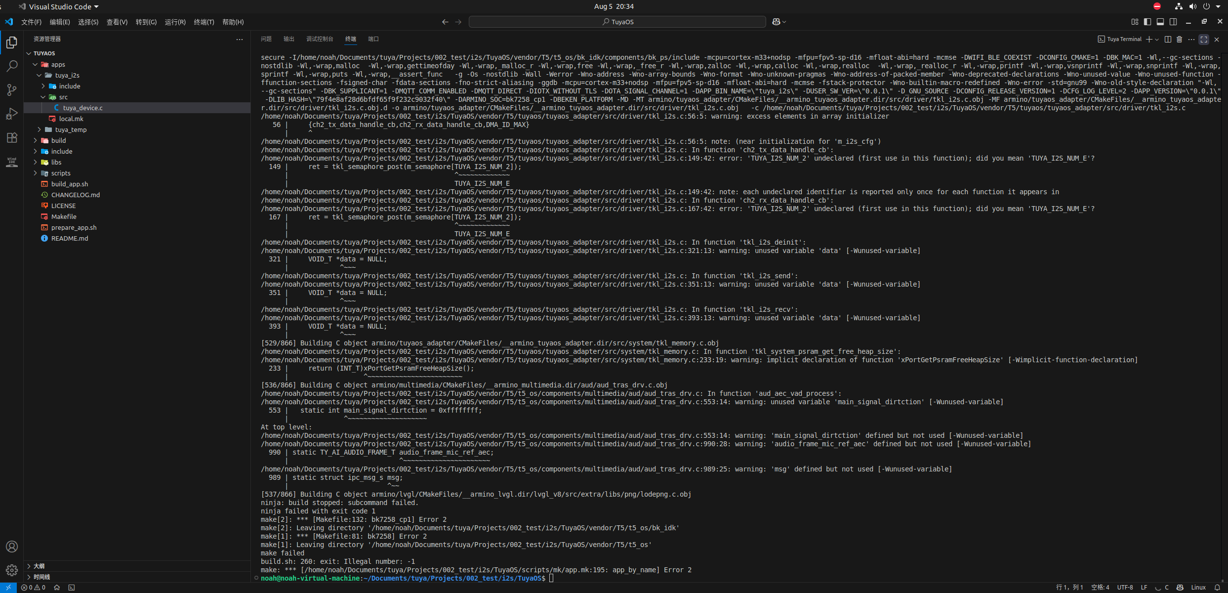

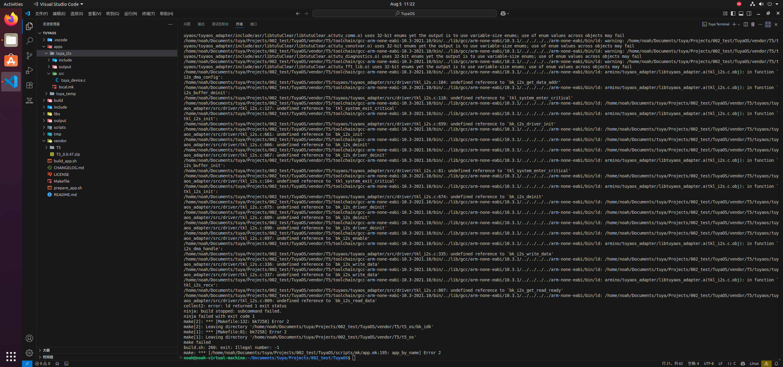

noah
Posts: 10
Re: T5支持I2S的接口,芯片本身是支持的,但是涂鸦层未能适配。可以实现吗?
你们有实际测试过的吗?实际测试编译sdk都有问题!!

第二步:修改脚本
在$ENV{ARMINO_PATH}/../../tuyaos/tuyaos_adapter/include/i2c下一行添加$ENV{ARMINO_PATH}/../../tuyaos/tuyaos_adapter/include/i2s
在src/driver/tkl_i2c.c下一行添加src/driver/tkl_i2s.c
第三步:
在TuyaOS/vendor/T5/t5_os/projects/tuya_app/config/bk7258/config修改CONFIG_I2S=y
在TuyaOS/vendor/T5/t5_os/projects/tuya_app/config/bk7258_cp1/config修改CONFIG_I2S=y

在TuyaOS/vendor/T5/t5_os/bk_idk/middleware/soc/bk7258/hal/i2s_hal.c修改i2s_ll_set_pcm_cfg_datalen(config->data_length - 1, i2s_cfg_index);
在vendor/T5/t5_os/bk_idk/middleware/soc/bk7258_cp1/hal/i2s_hal.c修改i2s_ll_set_pcm_cfg_datalen(config->data_length - 1, i2s_cfg_index);

最后编译不过!!
