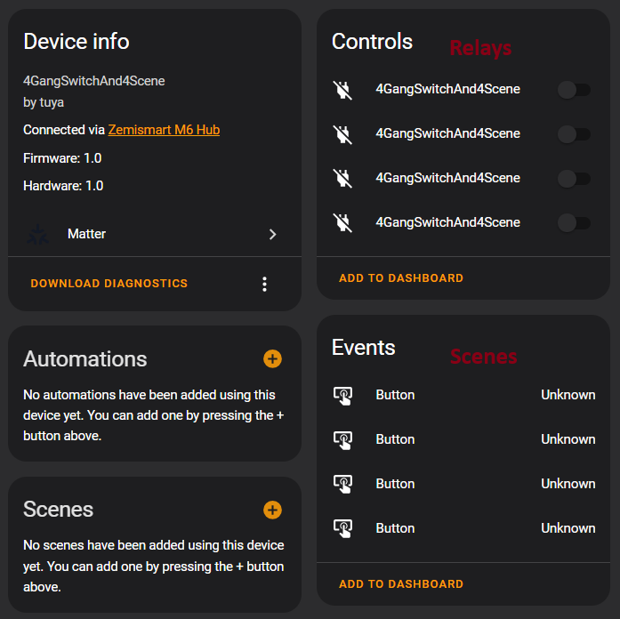

Hi Again,
In addition to my previous email, let me note that the M8 Pro Keypad is working very good with Home Assistant and it's showing both Relays and Scenes via Matter Integration. Here is attached pictures for the the M8 Pro and the integration with Home Assistant via Matter. It's working Good!!
So the other Keypads should be the same, showing both Relays and Scenes.
Regards,

fangping.guo
Posts: 275
Re: Tuya Zigbee Devices not Published on Matter properly
Hi, we have updated the object model files for the devices and they should now show both relay and scene.
Please unpair the devices and re-pair them to test, and we welcome your continued feedback.
