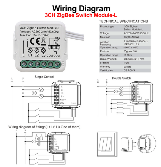

Hi all,
I was looking for modular devices like the one in the photo, of the zigbee type which use multi-control via zigbee to turn on a light from multiple points and I thought they worked like 3 gangs switchs (see the video), that is, you set the multi-control if you then disconnect the internet , the multi control continues to work via zigbee. In reality I purchased 2 types of 3-line zigbee modules (as in the photo), but with these modules connected behind the same zigbee gateway as the gangs switch, the multicontrol stops working if I don't have internet. Why this difference? What allows the 3 gangs switch to operate with multiple controls even without the internet?

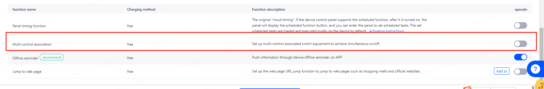

It is necessary to set up the Tuya Iot platform, select the pid details of your product, there is a switch button of "multi-control association" at the bottom of the "Function definition" interface, we need to enable it, save the Settings, re-configure the device network, and finally view the multi-control function of the device on the App.
Tuyar
Posts: 10
Re: how to reconize module work in zigbee
like this

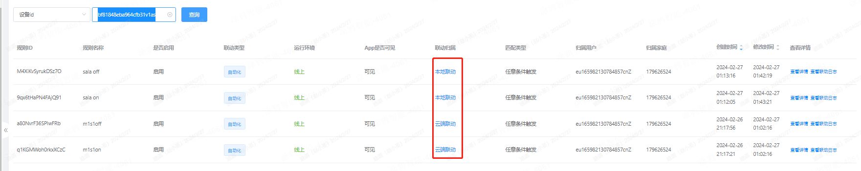

Do you mean that M1 and M2 can create multicontrol , but cannot be used when not connected to the Internet?
Only four linkage information related to M1 M2 is queried in the background, namely, sala off, sala on, m1s1off, and m1s1on. The first two can be executed without a network, and the second two require a network to be executed, because it is the cloud that is responsible for it.
