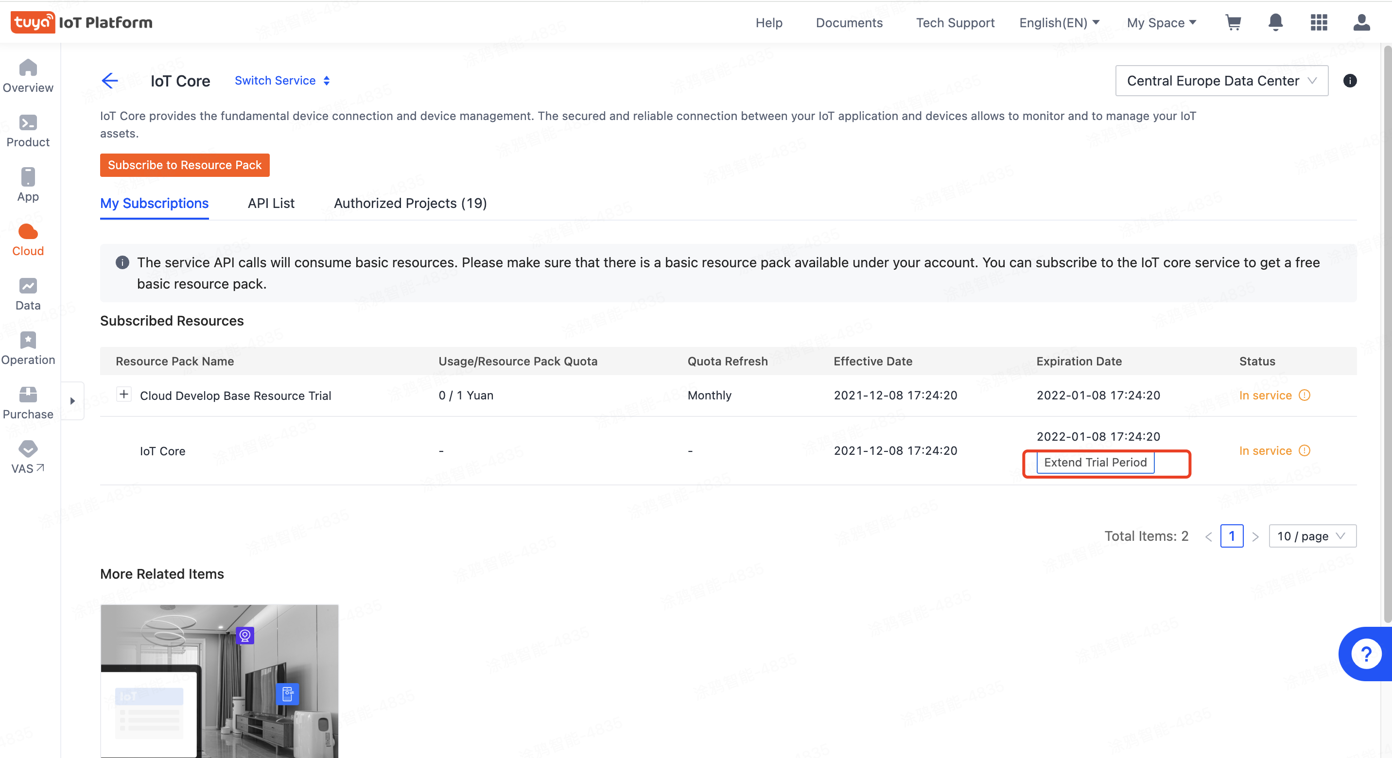

1.The IoT Core connection service has expired and been deactivated, resulting in devices not being able to query it
The error code 28841002 is reported when OpenApi is invoked,Need to renew IoT Core on Tuya IoT platform
For details, refer to the error code documentation and search 28841002
https://developer.tuya.com/en/docs/iot/ ... 9ruxx88swc

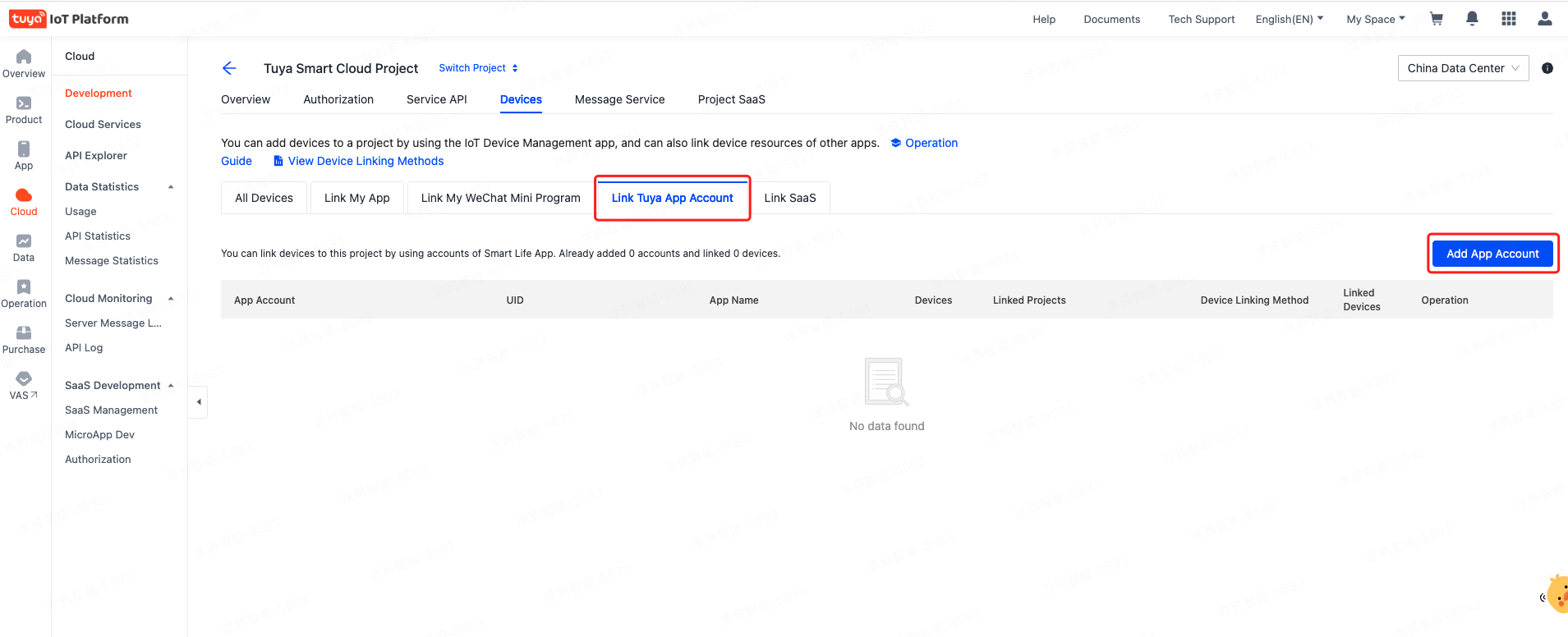

2.No Tuya smart/smart lifestyle account associated, causing the device to be unable to find it
Need to link the account to the cloud project on the Tuya IoT platform
