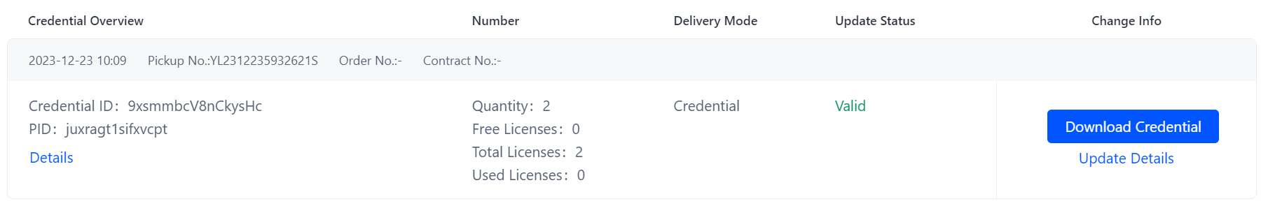

1- I got a license according to the attachment :

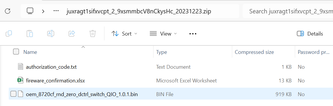

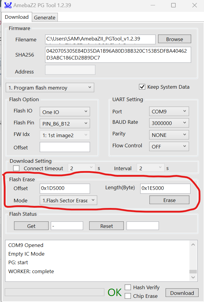

and "Flash Erase" WBR3 chip with file "3.png"

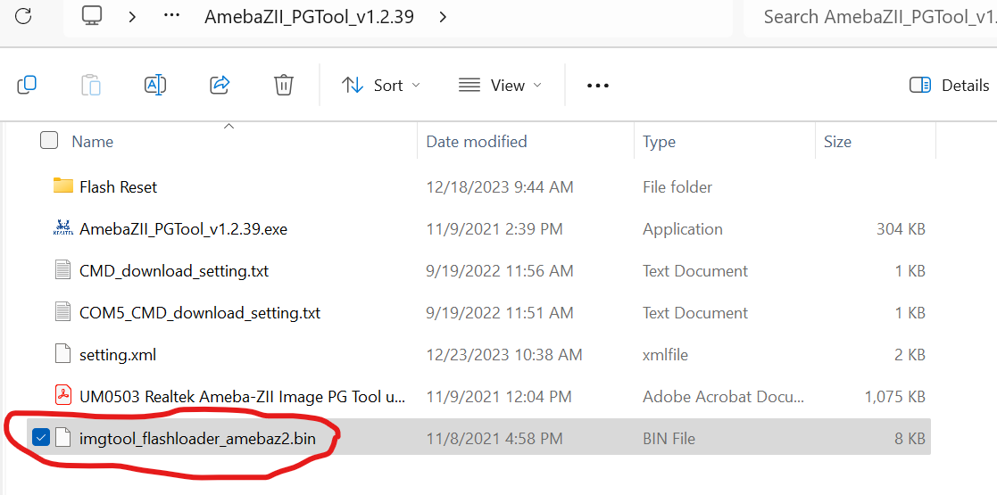

and burn it with "imagetools_flashloader_....bin" see "4.png" attachment file
and then burn it with file "oem_8720cf_rnd_zero_dctrl_switch_QIO_1.0.1.bin" see attachment file "2.png" (credential .bin file)
So far everything has gone well and I see OK in the AmebaZ2 chip burner App.

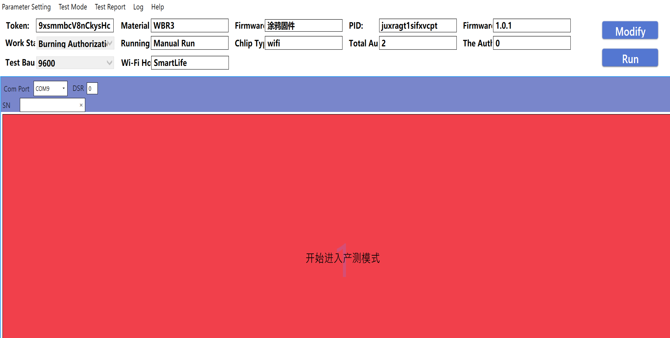

and I tried to burn "WBR3" with "TYProductionToolkit" see the attachment file "5.png"
THAT I DIDN'T BURN WBR3 with TYProductionToolkit
what is my fault?

                                My wiring for "TYProductionToolkit" was :
Module pin Serial port pin
TX RX
RX TX
GND GND
VCC3.3V VCC3.3V
What is my fault?
IS THERE ANY MOVIE (STEP-BY-STEP) ABOUT THAT?
I was forgetting that the total time to complete was not more than 15 minutes
