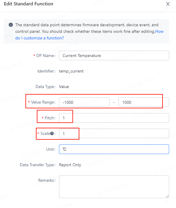

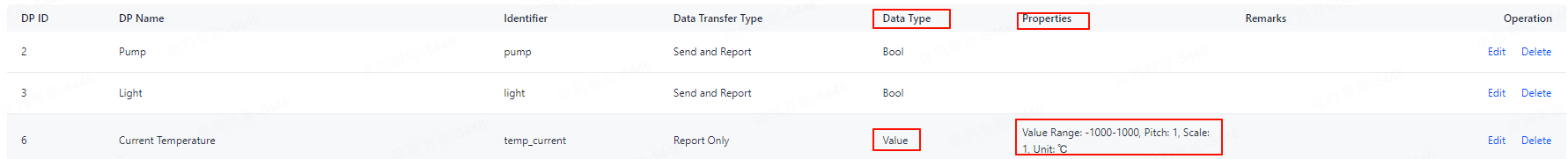

yangjie
Posts: 225
Re: Readings not updating in Tuya app
Open the product you want to develop:
click edit:
This means: -100.0 to 100.0.
