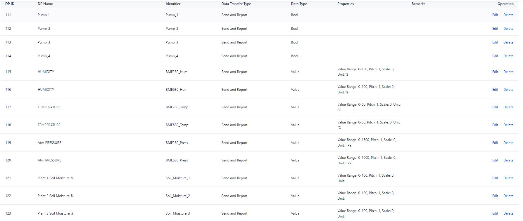

But how about the functions which are specific to my product (attached), which I added in the Tuya Platform?
