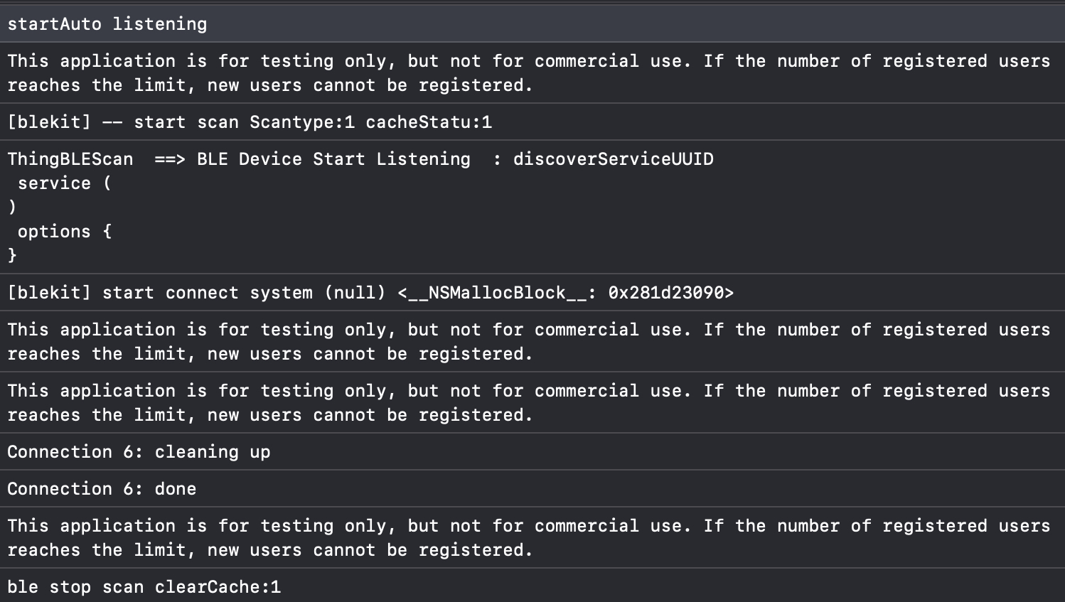

Hi! I'm developing an app using SDK to control Ambiance Light device. I've run an example https://github.com/tuya/tuya-home-ios-sdk-sample-objc and wasn't able to find my device through Bluetooth. While with Smart Life app I can find, connect and control it.
All permissions for app are granted.
Thank you for any help!
My env:
iPhone 13 Pro
iOS 17.1.2
Xcode 15.2
I'm adding zip file with screen records from both sdk example app and Smart Life app, also adding logs.
Logs
Logs
Archive.zip
Screen records
(19.1 MiB) Downloaded 377 times

From the attachment, it appears that you are using Single-Point Bluetooth scanning, and your Smart Ambient Light is a BLE& WIFI device, so it cannot be scanned. You can use 'Dual Mode' to scan the device.

It has absolutely the same result for Dual Mode scanning.
And why did you suggest that this device is Dual Mode? This product registered as Bluetooth device (just wondering, because maybe I'm missing something)
Device Type - Common Device
Protocol - Bluetooth
Data Protocol - Tuya Standard Protocol
Also, just saw this warning, maybe it can be connected too?
API MISUSE: <CBCentralManager: 0x2801e4a00> has no restore identifier but the delegate implements the centralManager:willRestoreState: method. Restoring will not be supported
And noticed
Bluetooth Background Permission is not enabled in the current application
But all required permissions according to documentation are there (and Capabilities Access Wi-Fi Information is added)

Ok, so I added another permission (which wasn't mentioned in any documentation) and it fixed warnings mentioned above, but it still can't find the device and doesn't trigger didDiscoveryDeviceWithDeviceInfo
