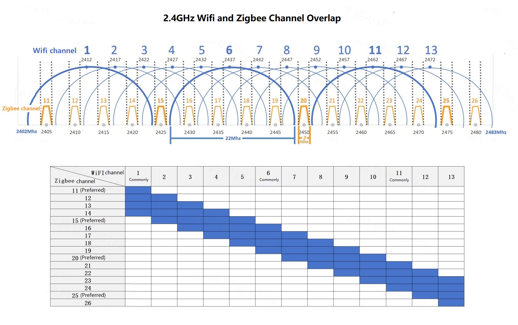

(4) Electromagnetic interference: For example, wifi devices, Bluetooth devices, etc., may share the 2.4 GHz frequency band with Zigbee devices, resulting in co-channel interference. In general, the wifi router and the gateway are placed as far away as possible, and then you can use the app that supports channel scanning, such as "Wifi Magic Box", etc., to scan the wifi channel and strength in the current environment, and combined with the zigbee network channel obtained in the second chapter, refer to the following chart to determine whether there is channel overlap between the two, such as zigbee's 20 channel and wifi's 7, 8, 9, There is a conflict in 10 channels. Since the common channels of WiFi are 1, 6, and 11, the preferred channels for Zigbee are 11, 15, 20, and 25. At present, the Zigbee channel of the gateway is automatically selected when creating a network, whether each gateway has the function of manually selecting the channel, please refer to the corresponding manual, and the gateway can only modify the channel when creating the network, once a device joins, it cannot change the channel. In addition, the WiFi channel can be adjusted through the router's configuration interface, and generally can also be adjusted to automatic or manual setting mode, please refer to the actual device usage documentation. In summary, if there is signal interference, the impact can be reduced by shutting down, adjusting the channel of the interfering device, or reducing the signal strength of the interference;
