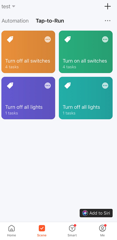

The Scene of Tuya APP are divided into automation and tap-to-run. The scene control managed by the central control is a tap-to-run in the home under the Tuya APP. After the creation of tap-to-run is completed on the App side, the central control end will synchronize all tap-to-run of the APP and support the synchronization of the control and status of tap-to-run.
Based on your living habits, you can create tap-to-run such as going home and leaving home, which can make it more convenient to control the devices at home. Central Control will only manage tap-to-run in the APP and will not handle automation.
