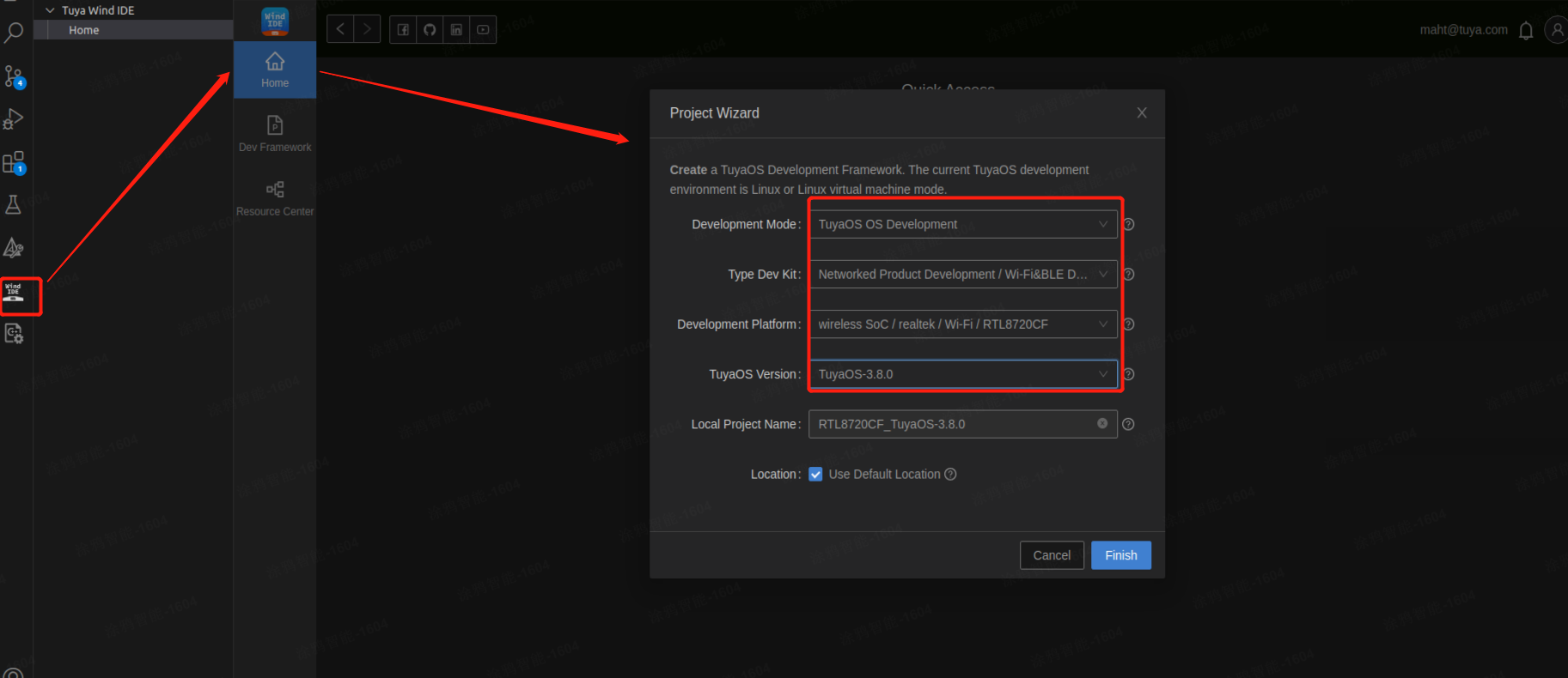

  1. Install the Tuya Wind IDE from this link: Tuya Wind IDE.
  2. Log in to the IDE and download a development kit:

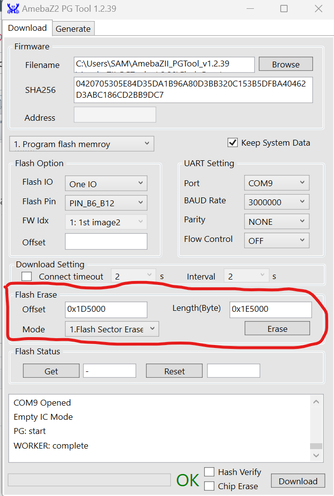

  3. Locate the "pctools" folder at pc/tools/RTL8720CF/ and erase the database from 0x1D5000 to 0x1E5000:

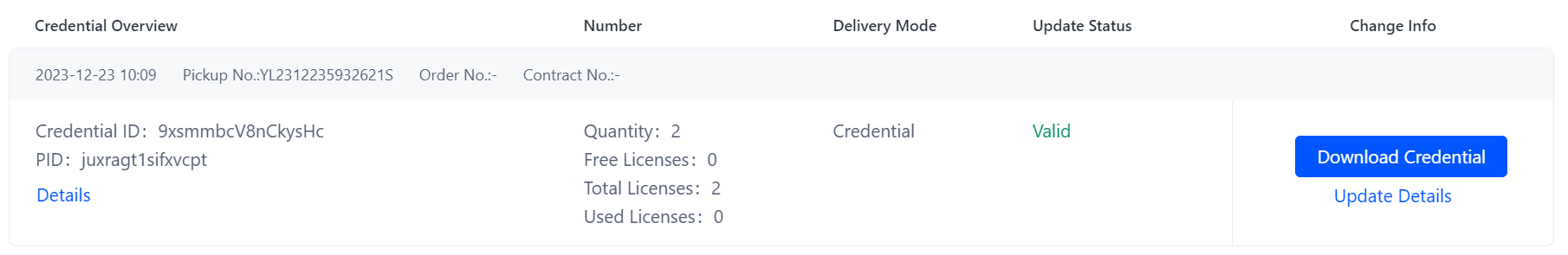

1- I got a license according to the attachment :

and "Flash Erase" WBR3 chip with file "3.png"

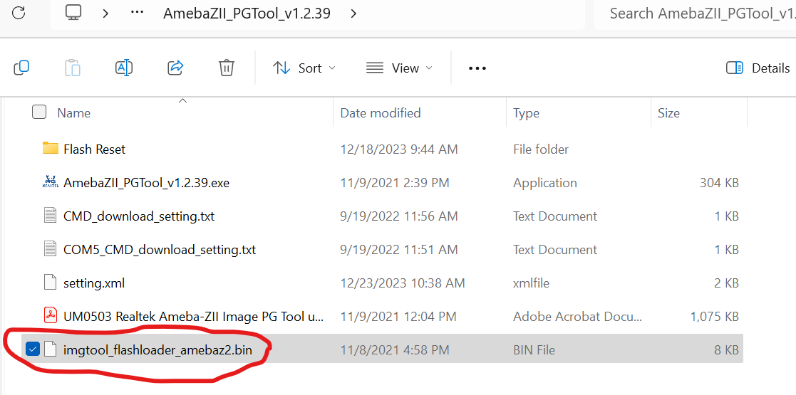

and burn it with "imagetools_flashloader_....bin" see "4.png" attachment file

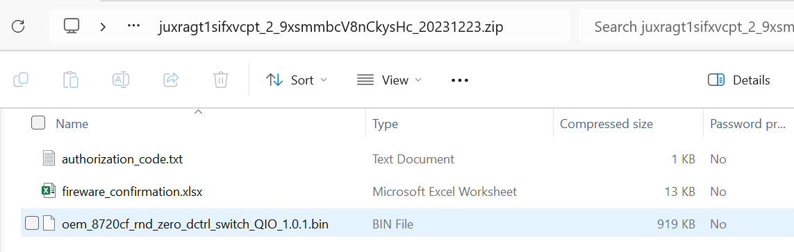

and then burn it with file "oem_8720cf_rnd_zero_dctrl_switch_QIO_1.0.1.bin" see attachment file "2.png" (credential .bin file)

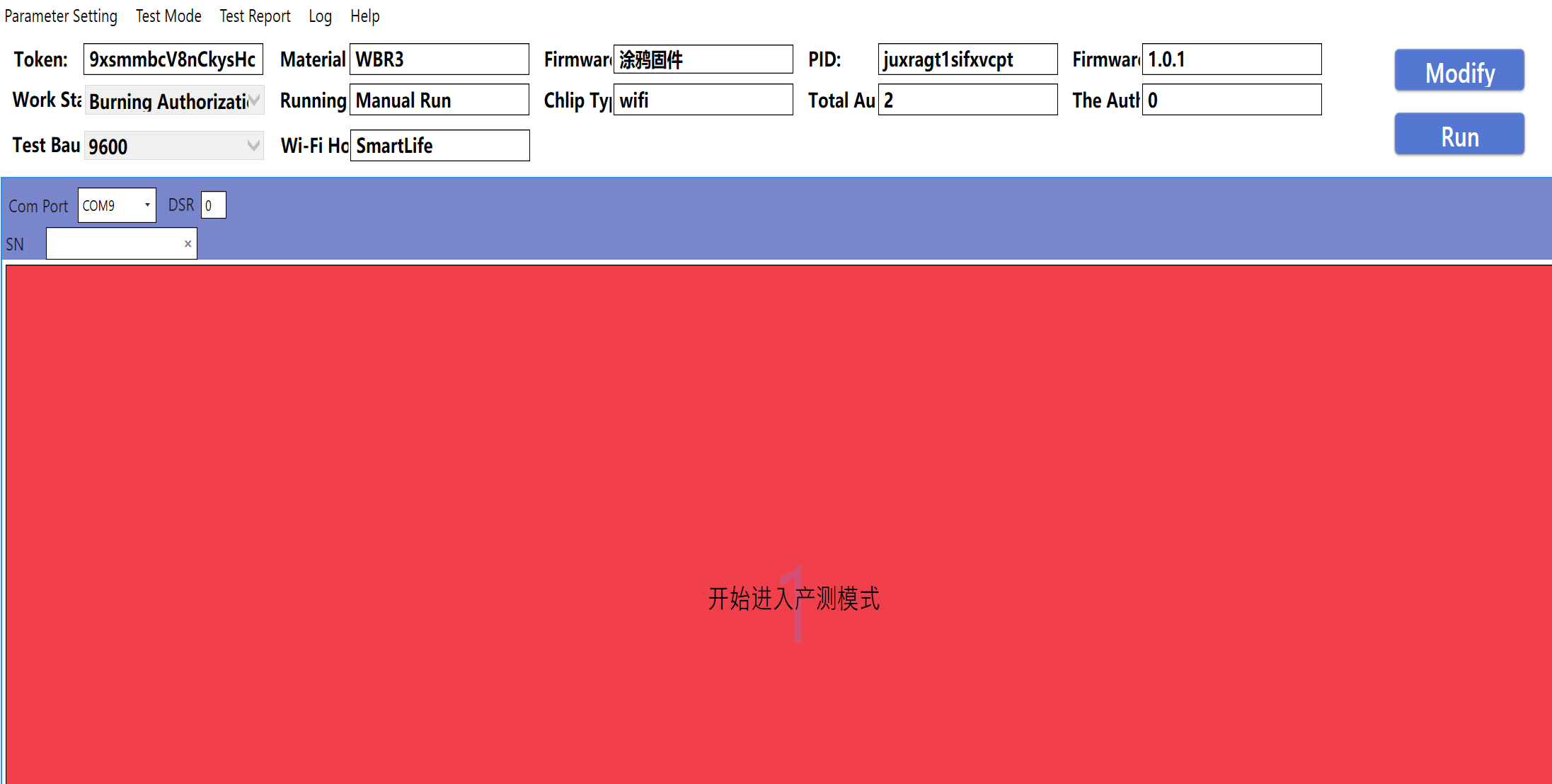

and I tried to burn "WBR3" with "TYProductionToolkit" see the attachment file "5.png"
THAT I DIDNT DO BURN
what is my fault?

Hi, to use the TYproductionTool, you need to knick the "run" button and then power down/up the module.
