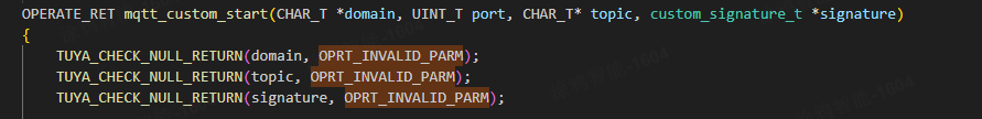

tuannguyen.aiot
Posts: 6
Re: connect MQTT with BK7231N chip
I connect mqtt and get error ret = -2;
https://drive.google.com/drive/folders/ ... drive_link
Posts: 808
Please check if the parameters are valid.
