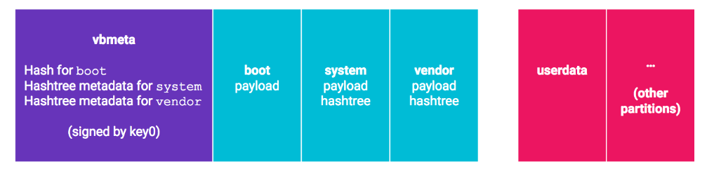

AVB is short for Android Verified Boot, a firmware verification process designed by Google, mainly used for verifying boot system and other firmware.
During the entire AVB verification process, the vbmeta partition is required, and the vbmeta partition and vbmeta.img image need to be added.

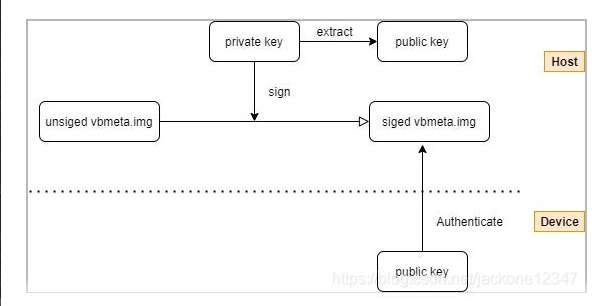

Brief description of the encryption and decryption process of the vbmeta image:
- Encryption process
Generate a private key based on the digest information, use the private key to generate a public key with extra, and use the private key to sign the vbmeta image (signature), and write the public key and calculated hash to the header of the vbmeta image. - Decryption process
First, verify whether the public key is issued by the platform (public key comparison, to prevent the public key and signature of the vbmeta image from being tampered with), and then use the public key to decrypt the signature.

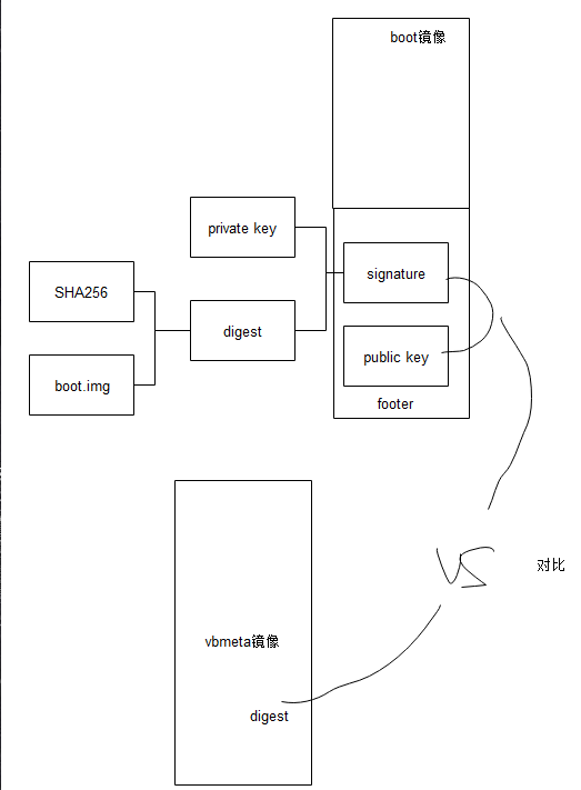

The encryption and decryption process of boot.img image in AVB:
When compiling and making the boot.img, signing is done by first obtaining a hash value digest (hexadecimal length of 64) through the SHA-256 algorithm, then encrypting this digest with a private key with RSA algorithm, and generating a signature and adding it to the image's footer along with the public key. The digest is also stored in the vbmeta.img image during compilation.
When loading the boot image in the bootloader, the boot descriptor's digest is first read from the vbmeta.img image partition, and then the public key in the boot image is used to decrypt and calculate a digest, which is compared with the digest obtained from the SHA-256 calculation;
If the digests are equal, it means that the boot.img is signed by the platform compilation. If they are not equal, the boot.img may have been tampered with, and the boot will fail.
Finally, the hash of the boot image content is calculated again to see if it is equal. If the hash is not equal, the boot will also fail.

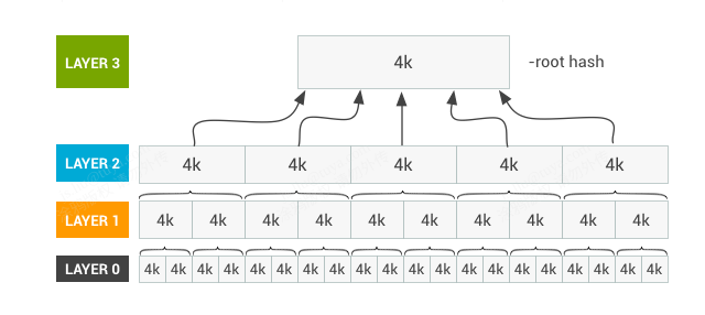

The basic principle is to use Device-Mapper-Verity technology, which divides the verification firmware into 4K segments and calculates the hash for each 4K data slice, iterates multiple layers, and generates the corresponding Hash-Map (within 30M) and Root-Hash. When creating a virtual partition based on DM-V, the Hash-Map will be verified to ensure that the Hash-Map is correct.
After the partition is mounted, when the data is accessed, a separate HASH check will be performed on the 4K partition where the data is located. When the check fails, an I/O error will be returned, and the corresponding location cannot be used, just like when the file system is damaged.

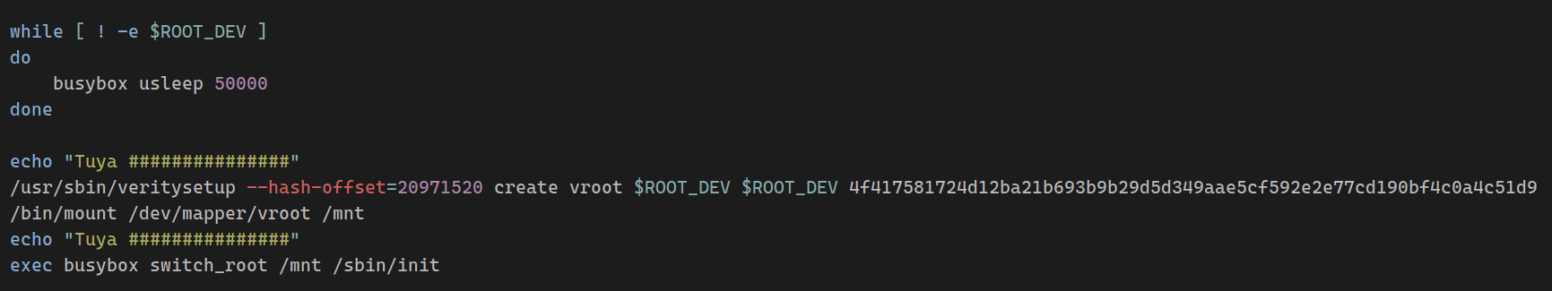

ramdisk verification process of rootfs:
