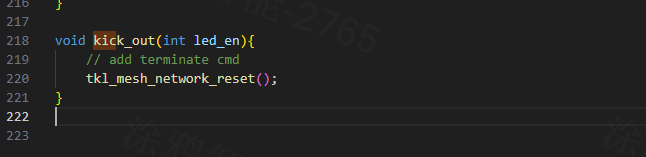

进到KICK_OUT函数里面是这样吗?

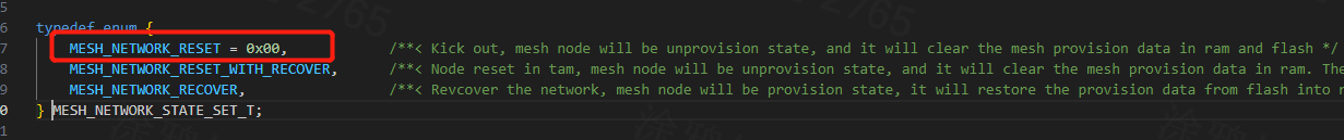

kict_out的在不同平台不通用,使用提供的通用重置接口(如图片所示)再试试

这两个函数都试过。但是都不行
  • @brief This function can reset the device,and the device can't recover to provision state.
  • @return none
    void tuya_mesh_network_reset(void);
  • @brief This function can reset the device to the unprovision staate,and the device
  • can recover to the provision state in some case.Such as repower on,or the device
  • doesn't be provision for 5s
  • @param[in] The time that the device will be recovered if it is not been provision
  • @return none
    void tuya_mesh_network_reset_with_restore(uint16_t restore_time_s);

我在以前的工程上使用kick_out接口,可以重置设备。
