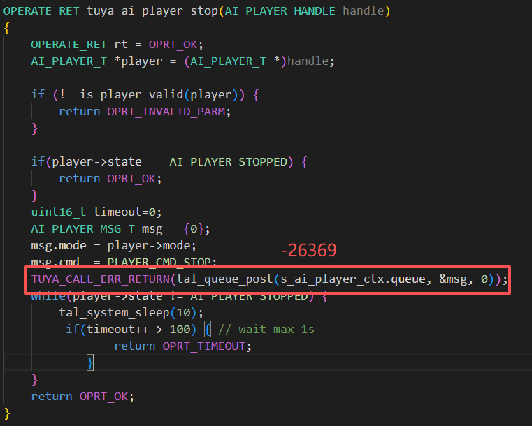

【求助】T5 tuya_os_sdk3.13.3播放提示音或停止时卡死

而且现在明显队列满了,处理消息的线程卡死了,这个才是根本原因,处理消息的线程跟我们变更player的状态没有关系,为什么会卡死,我深挖底层代码,在tkl_audio.c里面发现了一段可能的死循环:

包括之前的stop死循环事件,都说明了处理队列消息的线程就是会卡死,不然不会死循环的。

  1. 给 tkl_ao_put_frame 的重试加上累计超时——例如 ret==0 连续重试超过 X ms(比如 200500ms)就 return OPRT_TIMEOUT 并丢帧,绝不 goto 死循环。(同时增加超时的日志)
  2. 兜底(应用/播放器层):

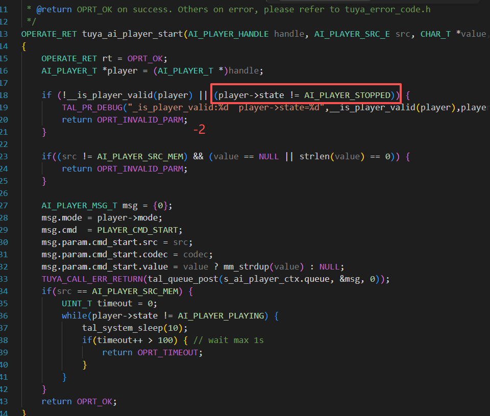

    • 把播放消息队列深度从 2 调大(比如10),减少瞬时 -26369;
    • tuya_ai_player_stop/start 的 tal_queue_post 给个小超时而非 0;
    • 配合方案1(播放线程内不忙等),避免重入。

[07-01 09:09:20:29 ty E][0x60c092b0][wukong_audio_player.c:294] ret:-20

tkl_audio.c tkl_ao_put_frame time out!![07-01 09:09:20:517 ty D][0x60c7d438][svc_ai_player.c:519] ai player FG cmd STOP
[07-01 09:09:20:517 ty D][0x60c7d438][svc_ai_player.c:131] stop player FG
[07-01 09:09:20:517 ty D][0x60c7d438][svc_ai_playlist.c:54] playlist player state 0 index 0 count 0 loop 0 single 0
[07-01 09:09:20:521 ty D][0x60c092b0][wukong_audio_player.c:222] wukong audio player -> player tts mem data len 3537
[07-01 09:09:20:521 ty D][0x60c7d438][wukong_audio_player.c:61] wukong audio player -> player tts event: 0
[07-01 09:09:20:521 ty D][0x60c7d438][wukong_audio_player.c:68] wukong audio player -> stop event
[07-01 09:09:20:521 ty D][0x60c7d438][hly_ai.c:189] ======wukong ai event type: 30
[07-01 09:09:20:522 ty D][0x60c7d438][svc_ai_player.c:519] ai player FG cmd STOP
[07-01 09:09:20:522 ty D][0x60c7d438][svc_ai_player.c:131] stop player FG
[07-01 09:09:20:522 ty D][0x60c7d438][svc_ai_playlist.c:54] playlist player state 0 index 0 count 0 loop 0 single 0
[07-01 09:09:20:522 ty D][0x60c7d438][wukong_audio_player.c:61] wukong audio player -> player tts event: 0
[07-01 09:09:20:522 ty D][0x60c7d438][wukong_audio_player.c:68] wukong audio player -> stop event
[07-01 09:09:20:522 ty D][0x60c7d438][hly_ai.c:189] ======wukong ai event type: 30
[07-01 09:09:20:522 ty D][0x60c7d438][svc_ai_player.c:519] ai player FG cmd START
[07-01 09:09:20:523 ty D][0x60c7d438][svc_ai_player.c:104] start player FG value=null
[07-01 09:09:20:523 ty D][0x60c7d438][wukong_audio_player.c:61] wukong audio player -> player tts event: 1
[07-01 09:09:20:523 ty D][0x60c7d438][wukong_audio_player.c:82] wukong audio player -> playing start event
[07-01 09:09:20:523 ty D][0x60c7d438][hly_ai.c:189] ======wukong ai event type: 20
voice_write_send_msg, 127, send message: 1 fail, ret: -1
bk_voice_write_start, 571, send message: VOICE_WRITE_START fail
tkl_ao_start, 765, voice read start fail
[07-01 09:09:20:524 ty D][0x60c2caac][hly_ai.c:94] ======ai re idel time:20======

tkl_audio.c tkl_ao_put_frame time out!![07-01 09:09:24:654 ty D][0x28050960][wukong_audio_aec_vad.c:150] speexdsp process time: aec->6(ms), count = 2784501

[07-01 09:09:25:692 ty D][0x60cb38c4][svc_ai_player.c:719] _is_player_valid:1  player->state=1
[07-01 09:09:25:692 ty E][0x60cb38c4][wukong_audio_player.c:240] ret:-2

[07-01 09:09:26:480 ty D][0x60cae4f0][hly_ai.c:94] ======ai re idel time:10======
[07-01 09:09:26:542 ty D][0x60cae4f0][wukong_audio_player.c:244] wukong audio player -> tts stream data 400
[07-01 09:09:26:542 ty D][0x60cae4f0][hly_ai.c:189] ======wukong ai event type: 5
[07-01 09:09:26:543 ty D][0x60cae4f0][hly_ai.c:94] ======ai re idel time:10======
[07-01 09:09:26:644 ty D][0x60cae4f0][wukong_audio_player.c:244] wukong audio player -> tts stream data 560
[07-01 09:09:26:644 ty D][0x60cae4f0][hly_ai.c:189] ======wukong ai event type: 5
[07-01 09:09:26:644 ty D][0x60cae4f0][hly_ai.c:94] ======ai re idel time:10======
[07-01 09:09:26:666 ty D][0x60cae4f0][wukong_audio_player.c:244] wukong audio player -> tts stream data 320
[07-01 09:09:26:666 ty D][0x60cae4f0][hly_ai.c:189] ======wukong ai event type: 5
[07-01 09:09:26:666 ty D][0x60cae4f0][hly_ai.c:94] ======ai re idel time:10======
tkl_audio.c tkl_ao_put_frame time out!![07-01 09:09:26:676 ty E][0x60c7d438][decoder_mp3.c:134] MP3Decode failed, ret=-6, offset=868, in_len=2796
[07-01 09:09:26:738 ty D][0x60cae4f0][wukong_audio_player.c:244] wukong audio player -> tts stream data 560
[07-01 09:09:26:738 ty D][0x60cae4f0][hly_ai.c:189] ======wukong ai event type: 5
[07-01 09:09:26:738 ty D][0x60cae4f0][hly_ai.c:94] ======ai re idel time:10======
[07-01 09:09:26:767 ty D][0x60cb2fd8][hly_mc1081.c:352] mc1081 task is running...
[07-01 09:09:26:840 ty D][0x60cae4f0][wukong_audio_player.c:244] wukong audio player -> tts stream data 400
[07-01 09:09:26:840 ty D][0x60cae4f0][hly_ai.c:189] ======wukong ai event type: 5
[07-01 09:09:26:841 ty D][0x60cae4f0][hly_ai.c:94] ======ai re idel time:10======
[07-01 09:09:26:883 ty D][0x60cae4f0][wukong_audio_player.c:244] wukong audio player -> tts stream data 480
[07-01 09:09:26:883 ty D][0x60cae4f0][hly_ai.c:189] ======wukong ai event type: 5
[07-01 09:09:26:883 ty D][0x60cae4f0][hly_ai.c:94] ======ai re idel time:10======
[07-01 09:09:26:955 ty D][0x60cae4f0][wukong_audio_player.c:244] wukong audio player -> tts stream data 400
[07-01 09:09:26:956 ty D][0x60cae4f0][hly_ai.c:189] ======wukong ai event type: 5
[07-01 09:09:26:957 ty D][0x60cae4f0][hly_ai.c:94] ======ai re idel time:10======
[07-01 09:09:27:25 ty D][0x60c2b934][hly_ai.c:512] ====*******ai debug A:1  B:8  C:1  D:12  E:8********====
[07-01 09:09:27:90 ty D][0x60cae4f0][wukong_audio_player.c:244] wukong audio player -> tts stream data 480
[07-01 09:09:27:90 ty D][0x60cae4f0][hly_ai.c:189] ======wukong ai event type: 5
[07-01 09:09:27:90 ty D][0x60cae4f0][hly_ai.c:94] ======ai re idel time:10======
[07-01 09:09:27:111 ty D][0x60c0fa18][hly_cht8320.c:41] cht8320 task is running...
[07-01 09:09:27:113 ty D][0x60cae4f0][wukong_audio_player.c:244] wukong audio player -> tts stream data 400
[07-01 09:09:27:113 ty D][0x60cae4f0][hly_ai.c:189] ======wukong ai event type: 5
[07-01 09:09:27:113 ty D][0x60cae4f0][hly_ai.c:94] ======ai re idel time:10======
[07-01 09:09:27:140 ty D][0x60c14790][hly_power.c:100] power task is running...
[07-01 09:09:27:175 ty D][0x60cae4f0][wukong_audio_player.c:244] wukong audio player -> tts stream data 400
[07-01 09:09:27:175 ty D][0x60cae4f0][hly_ai.c:189] ======wukong ai event type: 5
[07-01 09:09:27:175 ty D][0x60cae4f0][hly_ai.c:94] ======ai re idel time:10======
[07-01 09:09:27:201 ty D][0x60c14ee4][hly_weather.c:61] weather task is running...
[07-01 09:09:27:214 ty D][0x60cb2fd8][hly_mc1081.c:352] mc1081 task is running...
[07-01 09:09:27:278 ty D][0x60cae4f0][wukong_audio_player.c:244] wukong audio player -> tts stream data 480
[07-01 09:09:27:278 ty D][0x60cae4f0][hly_ai.c:189] ======wukong ai event type: 5
[07-01 09:09:27:278 ty D][0x60cae4f0][hly_ai.c:94] ======ai re idel time:10======
[07-01 09:09:27:281 ty D][0x60cae4f0][wukong_audio_player.c:244] wukong audio player -> tts stream data 560
[07-01 09:09:27:281 ty D][0x60cae4f0][hly_ai.c:189] ======wukong ai event type: 5
[07-01 09:09:27:281 ty D][0x60cae4f0][hly_ai.c:94] ======ai re idel time:10======
[07-01 09:09:27:303 ty D][0x60cae4f0][wukong_audio_player.c:244] wukong audio player -> tts stream data 160
[07-01 09:09:27:303 ty D][0x60cae4f0][hly_ai.c:189] ======wukong ai event type: 5
[07-01 09:09:27:303 ty D][0x60cae4f0][hly_ai.c:94] ======ai re idel time:10======
[07-01 09:09:27:465 ty D][0x60cae4f0][wukong_audio_player.c:244] wukong audio player -> tts stream data 80
[07-01 09:09:27:465 ty D][0x60cae4f0][hly_ai.c:189] ======wukong ai event type: 5
[07-01 09:09:27:465 ty D][0x60cae4f0][hly_ai.c:94] ======ai re idel time:10======
[07-01 09:09:27:560 ty D][0x60c0d828][hly_pcf8563.c:97] pcf8563 task is running...
[07-01 09:09:27:615 ty D][0x60f5f7dc][hly_display.c:285] ====================queue fetch:0  type:9
[07-01 09:09:27:659 ty D][0x60cb2fd8][hly_mc1081.c:352] mc1081 task is running...
[07-01 09:09:27:910 ty N][0x60cb38c4][wukong_ai_skills.c:104] json-str {"content":"鐜板湪璇煶鍔熻兘涓€鍒囨甯稿摝~","reasoningContent":"","appendMode":"append","timeIndex":4000,"finish":false,"tags":[]}
[07-01 09:09:27:911 ty N][0x60cb38c4][wukong_ai_skills.c:117] wukong text -> NLG eof: 0, content: 鐜板湪璇煶鍔熻兘涓€鍒囨甯稿摝~, time: 1623928144
[07-01 09:09:27:911 ty D][0x60cb38c4][hly_ai.c:189] ======wukong ai event type: 11
[07-01 09:09:27:927 ty D][0x60cae4f0][wukong_audio_player.c:244] wukong audio player -> tts stream data 400
[07-01 09:09:27:927 ty D][0x60cae4f0][hly_ai.c:189] ======wukong ai event type: 5
[07-01 09:09:27:927 ty D][0x60cae4f0][hly_ai.c:94] ======ai re idel time:10======
[07-01 09:09:27:989 ty D][0x60cae4f0][wukong_audio_player.c:244] wukong audio player -> tts stream data 480
[07-01 09:09:27:989 ty D][0x60cae4f0][hly_ai.c:189] ======wukong ai event type: 5
[07-01 09:09:27:989 ty D][0x60cae4f0][hly_ai.c:94] ======ai re idel time:10======
[07-01 09:09:28:3 ty D][0x60c0e998][hly_opt3001.c:32] opt3001 task is running...
[07-01 09:09:28:25 ty D][0x60c2b934][hly_ai.c:512] ====*******ai debug A:1  B:8  C:1  D:12  E:8********====
[07-01 09:09:28:51 ty D][0x60cae4f0][wukong_audio_player.c:244] wukong audio player -> tts stream data 400
[07-01 09:09:28:51 ty D][0x60cae4f0][hly_ai.c:189] ======wukong ai event type: 5
[07-01 09:09:28:51 ty D][0x60cae4f0][hly_ai.c:94] ======ai re idel time:10======
[07-01 09:09:28:93 ty D][0x60cae4f0][wukong_audio_player.c:244] wukong audio player -> tts stream data 480
[07-01 09:09:28:93 ty D][0x60cae4f0][hly_ai.c:189] ======wukong ai event type: 5
[07-01 09:09:28:93 ty D][0x60cae4f0][hly_ai.c:94] ======ai re idel time:10======
[07-01 09:09:28:103 ty D][0x60cb2fd8][hly_mc1081.c:352] mc1081 task is running...
[07-01 09:09:28:140 ty D][0x60c14790][hly_power.c:100] power task is running...
[07-01 09:09:28:201 ty D][0x60c14ee4][hly_weather.c:61] weather task is running...
[07-01 09:09:28:226 ty D][0x60cae4f0][wukong_audio_player.c:244] wukong audio player -> tts stream data 400
[07-01 09:09:28:226 ty D][0x60cae4f0][hly_ai.c:189] ======wukong ai event type: 5
[07-01 09:09:28:226 ty D][0x60cae4f0][hly_ai.c:94] ======ai re idel time:10======
[07-01 09:09:28:267 ty D][0x60cae4f0][wukong_audio_player.c:244] wukong audio player -> tts stream data 480
[07-01 09:09:28:267 ty D][0x60cae4f0][hly_ai.c:189] ======wukong ai event type: 5
[07-01 09:09:28:267 ty D][0x60cae4f0][hly_ai.c:94] ======ai re idel time:10======
[07-01 09:09:28:339 ty D][0x60cae4f0][wukong_audio_player.c:244] wukong audio player -> tts stream data 400
[07-01 09:09:28:340 ty D][0x60cae4f0][hly_ai.c:189] ======wukong ai event type: 5
[07-01 09:09:28:340 ty D][0x60cae4f0][hly_ai.c:94] ======ai re idel time:10======
[07-01 09:09:28:392 ty D][0x60cae4f0][wukong_audio_player.c:244] wukong audio player -> tts stream data 400
[07-01 09:09:28:392 ty D][0x60cae4f0][hly_ai.c:189] ======wukong ai event type: 5
[07-01 09:09:28:392 ty D][0x60cae4f0][hly_ai.c:94] ======ai re idel time:10======
[07-01 09:09:28:444 ty D][0x60cae4f0][wukong_audio_player.c:244] wukong audio player -> tts stream data 400
[07-01 09:09:28:444 ty D][0x60cae4f0][hly_ai.c:189] ======wukong ai event type: 5
[07-01 09:09:28:444 ty D][0x60cae4f0][hly_ai.c:94] ======ai re idel time:10======
[07-01 09:09:28:450 ty D][0x60c0fa18][hly_cht8320.c:41] cht8320 task is running...
[07-01 09:09:28:455 ty D][0x60cae4f0][wukong_audio_player.c:244] wukong audio player -> tts stream data 80
[07-01 09:09:28:455 ty D][0x60cae4f0][hly_ai.c:189] ======wukong ai event type: 5
[07-01 09:09:28:455 ty D][0x60cae4f0][hly_ai.c:94] ======ai re idel time:10======
[07-01 09:09:28:476 ty D][0x60cae4f0][wukong_audio_player.c:244] wukong audio player -> tts stream data 560
[07-01 09:09:28:476 ty D][0x60cae4f0][hly_ai.c:189] ======wukong ai event type: 5
[07-01 09:09:28:476 ty D][0x60cae4f0][hly_ai.c:94] ======ai re idel time:10======
[07-01 09:09:28:488 ty D][0x60cae4f0][wukong_audio_player.c:244] wukong audio player -> tts stream data 80
[07-01 09:09:28:488 ty D][0x60cae4f0][hly_ai.c:189] ======wukong ai event type: 5
[07-01 09:09:28:488 ty D][0x60cae4f0][hly_ai.c:94] ======ai re idel time:10======
[07-01 09:09:28:552 ty D][0x60cb2fd8][hly_mc1081.c:352] mc1081 task is running...
[07-01 09:09:28:560 ty D][0x60cae4f0][wukong_audio_player.c:244] wukong audio player -> tts stream data 80
[07-01 09:09:28:560 ty D][0x60cae4f0][hly_ai.c:189] ======wukong ai event type: 5
[07-01 09:09:28:560 ty D][0x60cae4f0][hly_ai.c:94] ======ai re idel time:10======
tkl_audio.c tkl_ao_put_frame time out!![07-01 09:09:28:702 ty E][0x60c7d438][svc_ai_player.c:263] ai player FG datasink read error: -2
[07-01 09:09:28:702 ty D][0x60c7d438][svc_ai_player.c:131] stop player FG
[07-01 09:09:28:702 ty D][0x60c7d438][svc_ai_playlist.c:54] playlist player state 0 index 0 count 0 loop 0 single 0
[07-01 09:09:28:703 ty D][0x60c7d438][wukong_audio_player.c:61] wukong audio player -> player tts event: 0
[07-01 09:09:28:703 ty D][0x60c7d438][wukong_audio_player.c:68] wukong audio player -> stop event
[07-01 09:09:28:703 ty D][0x60c7d438][hly_ai.c:189] ======wukong ai event type: 30
[07-01 09:09:28:704 ty D][0x60c2caac][hly_ai.c:121] =============ai stat:2=============
[07-01 09:09:28:706 ty D][0x60c2caac][hly_ai.c:94] ======ai re idel time:20======
[07-01 09:09:28:734 ty D][0x60f5f7dc][hly_display.c:285] ====================queue fetch:0  type:0
[07-01 09:09:28:736 ty D][0x60f5f7dc][hly_display.c:285] ====================queue fetch:0  type:1
[07-01 09:09:28:901 ty D][0x60c0d828][hly_pcf8563.c:97] pcf8563 task is running...
[07-01 09:09:28:919 ty D][0x60f5f7dc][hly_display.c:285] ====================queue fetch:0  type:9
[07-01 09:09:29:1 ty D][0x60cb2fd8][hly_mc1081.c:352] mc1081 task is running...
[07-01 09:09:29:26 ty D][0x60c2b934][hly_ai.c:512] ====*******ai debug A:1  B:8  C:1  D:12  E:8********====
[07-01 09:09:29:140 ty D][0x60c14790][hly_power.c:100] power task is running...
[07-01 09:09:29:201 ty D][0x60c14ee4][hly_weather.c:61] weather task is running...
[ONBOARD_MIC] data_size: 256000(Bytes), 62KB/s
[RAW_READ] data_size: 128000(Bytes), 31KB/s
[RAW_WRITE] data_size: 0(Bytes), 0KB/s
[ONBOARD_SPK] data_size: 0(Bytes), 0KB/s
[WIFI_TX] data_size: 128000(Bytes), 31KB/s
[WIFI_RX] data_size: 215040(Bytes), 52KB/s
[07-01 09:09:29:445 ty D][0x60cb2fd8][hly_mc1081.c:352] mc1081 task is running...
[07-01 09:09:29:610 ty D][0x60c092b0][hly_ai_fl.c:131] =====tp key type:0
[07-01 09:09:29:610 ty D][0x60c092b0][hly_ai.c:640] ==============hly_ai_shutup  publish==============
[07-01 09:09:29:612 ty D][0x60c2c1f0][hly_ai.c:486] =============ai sem:2=============
[07-01 09:09:29:612 ty D][0x60c2c1f0][hly_ai.c:489] =============ai sem:3=============
[07-01 09:09:29:615 ty D][0x60c2c1f0][hly_ai.c:492] =============ai sem:4=============
[07-01 09:09:29:618 ty D][0x60c2c1f0][tuya_ai_agent.c:1405] [upload event] type:4
[07-01 09:09:29:621 ty D][0x60c2c1f0][tuya_ai_protocol.c:2605] send success, total bytes sent: 169, sequence 26
[07-01 09:09:29:622 ty D][0x60c2c1f0][tuya_ai_event.c:57] send event rt:0, type:4
[07-01 09:09:29:622 ty D][0x60c2c1f0][hly_ai.c:495] =============ai sem:5=============
[07-01 09:09:29:623 ty D][0x60c2c1f0][hly_ai.c:499] =============ai sem:5=============
[07-01 09:09:29:623 ty D][0x60c2c1f0][hly_ai.c:704] =====hly ai play alert:4
[MEM DBG] MEM_Deallocate MEM_DEBUG_DOG_TAG err 0x60c01fac,size=4148
[MEM DBG] mem 0x60c01fac might be freed yet
[07-01 09:09:29:624 ty D][0x60c2c1f0][hly_ai.c:743] =====hly ai load alert:/mp3/exit.mp3
[07-01 09:09:29:624 ty D][0x60c2caac][hly_ai.c:121] =============ai stat:1=============
[07-01 09:09:29:626 ty D][0x60c2caac][hly_ai.c:94] ======ai re idel time:0======
[07-01 09:09:29:627 ty N][0x60c2caac][wukong_audio_input_board.c:337] wukong audio input -> mode is 1, wakeup set to 0, vad flag is 2!
tkl_fopen file success, path:/mp3/exit.mp3 fd = 1
[07-01 09:09:29:643 ty D][0x60f5f7dc][hly_display.c:285] ====================queue fetch:0  type:1
[07-01 09:09:29:646 ty D][0x60c2c1f0][wukong_audio_player.c:222] wukong audio player -> player tts mem data len 4140
[07-01 09:09:29:647 ty D][0x60c7d438][svc_ai_player.c:519] ai player FG cmd START
[07-01 09:09:29:647 ty D][0x60c7d438][svc_ai_player.c:104] start player FG value=null
[07-01 09:09:29:649 ty D][0x60c7d438][wukong_audio_player.c:61] wukong audio player -> player tts event: 1
[07-01 09:09:29:650 ty D][0x60c7d438][wukong_audio_player.c:82] wukong audio player -> playing start event
[07-01 09:09:29:650 ty D][0x60c7d438][hly_ai.c:189] ======wukong ai event type: 20
[07-01 09:09:29:659 ty D][0x60c2c1f0][hly_ai.c:503] =============ai sem:6=============
[07-01 09:09:29:659 ty D][0x60c2c1f0][hly_ai.c:483] =============ai sem:1=============
[07-01 09:09:29:662 ty D][0x60c7d438][decoder_mp3.c:47] ID3 tag_size n/a
[07-01 09:09:29:789 ty D][0x60c0fa18][hly_cht8320.c:41] cht8320 task is running...
[07-01 09:09:29:892 ty D][0x60cb2fd8][hly_mc1081.c:352] mc1081 task is running...
[07-01 09:09:30:26 ty D][0x60c2b934][hly_ai.c:512] ====*******ai debug A:1  B:8  C:1  D:12  E:5********====
[07-01 09:09:30:140 ty D][0x60c14790][hly_power.c:100] power task is running...
[07-01 09:09:30:201 ty D][0x60c14ee4][hly_weather.c:61] weather task is running...
[07-01 09:09:30:239 ty D][0x60c0e998][hly_opt3001.c:32] opt3001 task is running...
[07-01 09:09:30:240 ty D][0x60c0d828][hly_pcf8563.c:97] pcf8563 task is running...

日志中可以看到tkl_ao_put_frame已经超时输出:tkl_audio.c tkl_ao_put_frame time out!!
后续播放mp3的时候tkl_ao_start函数也开始出现报错日志:tkl_ao_start, 765, voice read start fail
详细:
到底底层发生了什么导致声音输出全部失效了呢?
